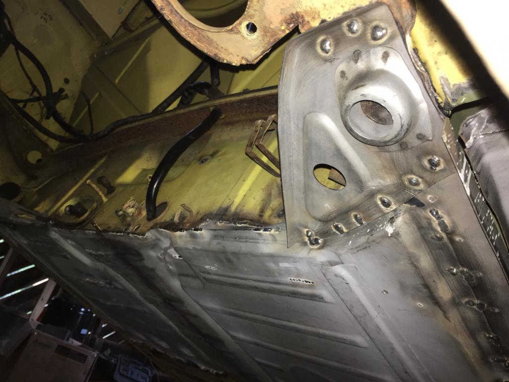

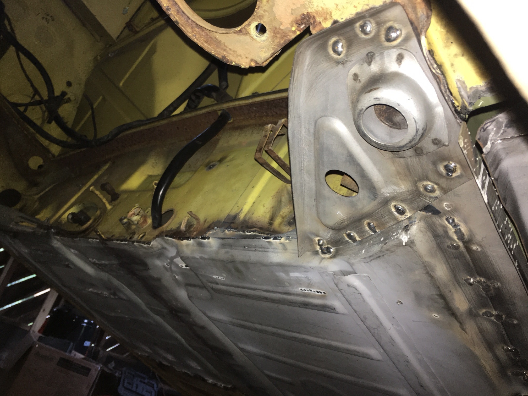

I reached a milestone tonight and finished all welding underneath the car! (IMG:style_emoticons/default/first.gif) (IMG:style_emoticons/default/welder.gif) No more molten balls of lava falling on me while I work. I installed the rear jacking triangles and completed the last few areas of welding on the floorpan.
