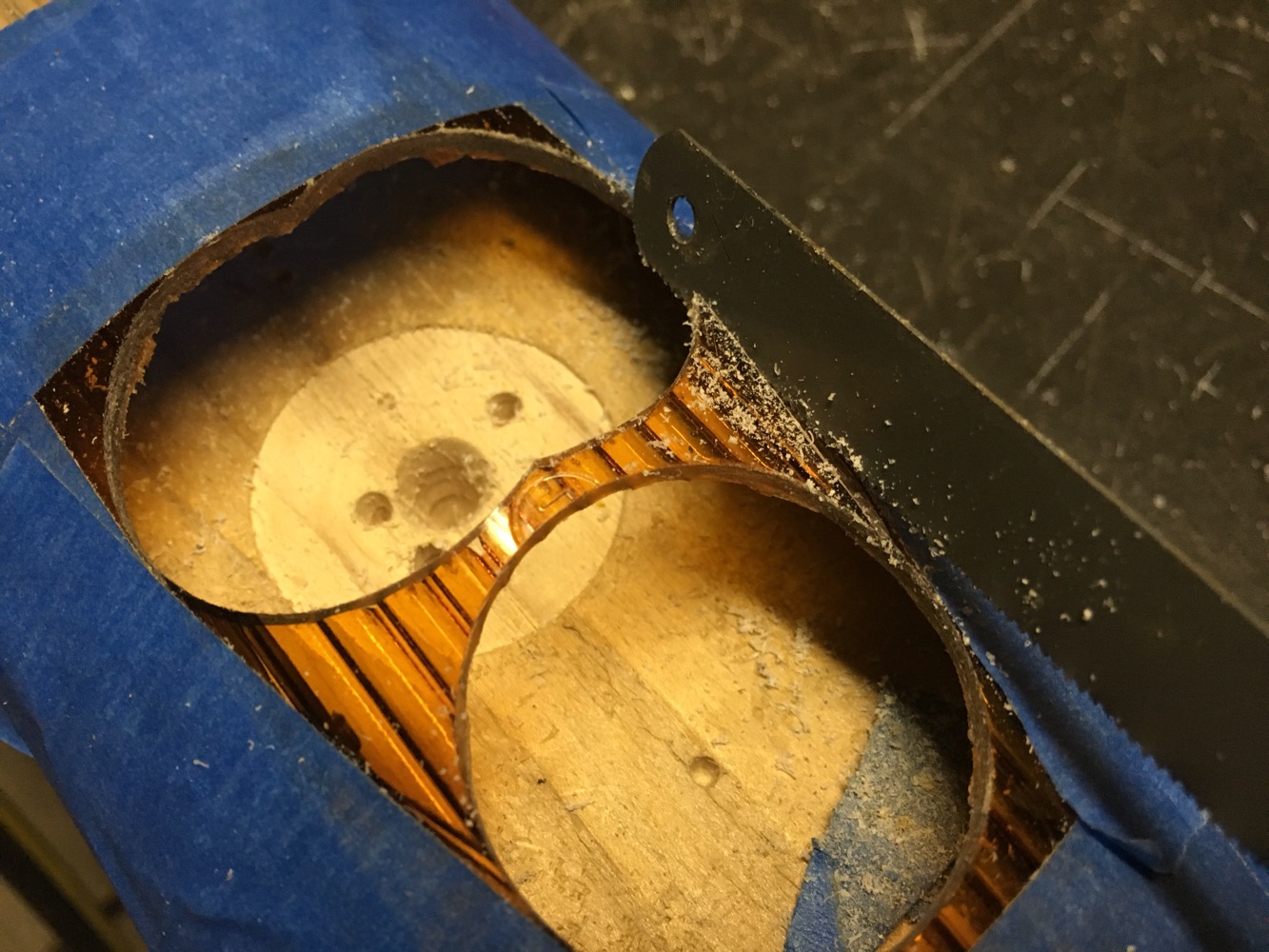

Start to finish 10 minutes per cut. Shaving off just a layer at a time. Works even when overlapping a prior cuts. If you cut to fast, you will see the plastic turn white. You want to cut, not melt.
Then saw, and file. Light sand, and polish.
Mounting and wiring next.

Garland   Thank you to all that are following, and or commen...   Jul 23 2016, 08:58 AM

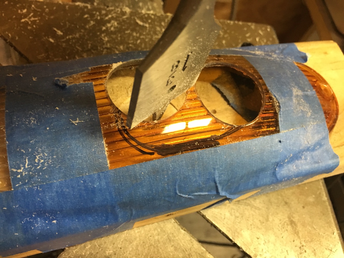

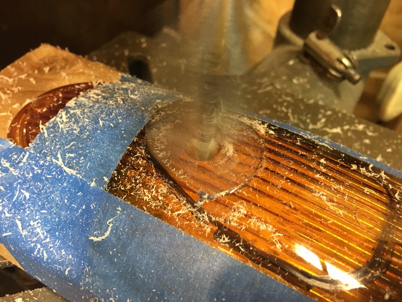

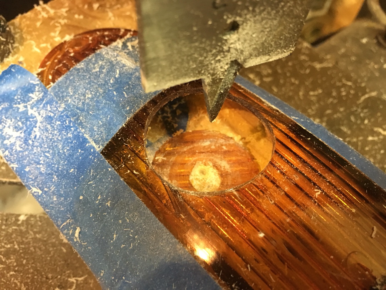

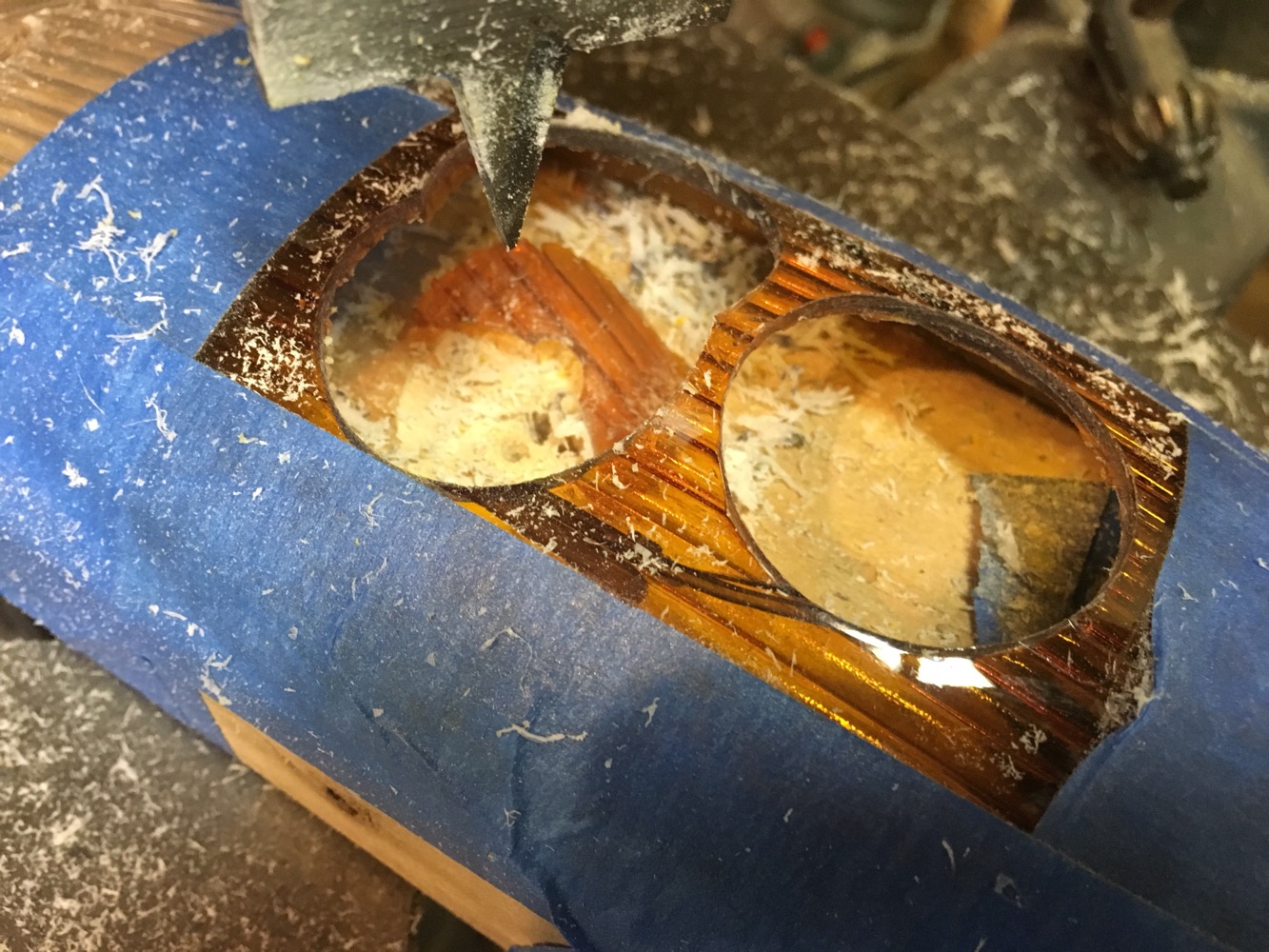

Garland   OK, well here's a few sample cuts, drills, and...   Jul 23 2016, 09:11 AM
Garland   Here I go   Jul 23 2016, 11:01 AM
Darren C   I can't bear to look.......That wood bit could...   Jul 23 2016, 01:16 PM
76-914   I can't bear to look.......That wood bit coul...   Jul 24 2016, 08:54 AM
Garland   Slow, and easy......don't want the bit to heat...   Jul 23 2016, 02:49 PM
jmitro   yea, get a real hole saw.   Jul 24 2016, 08:43 AM

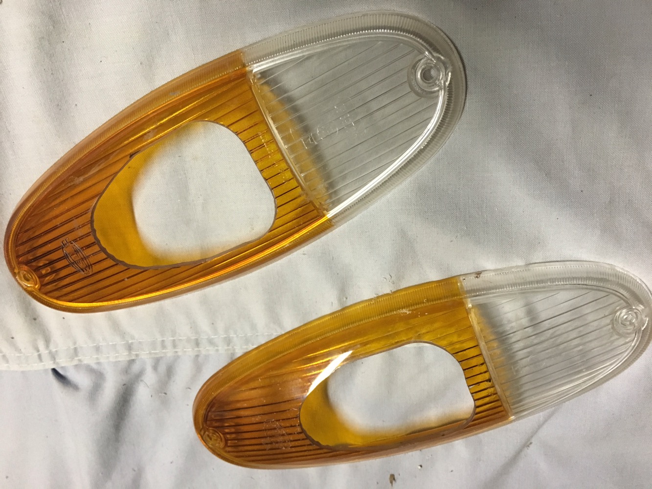

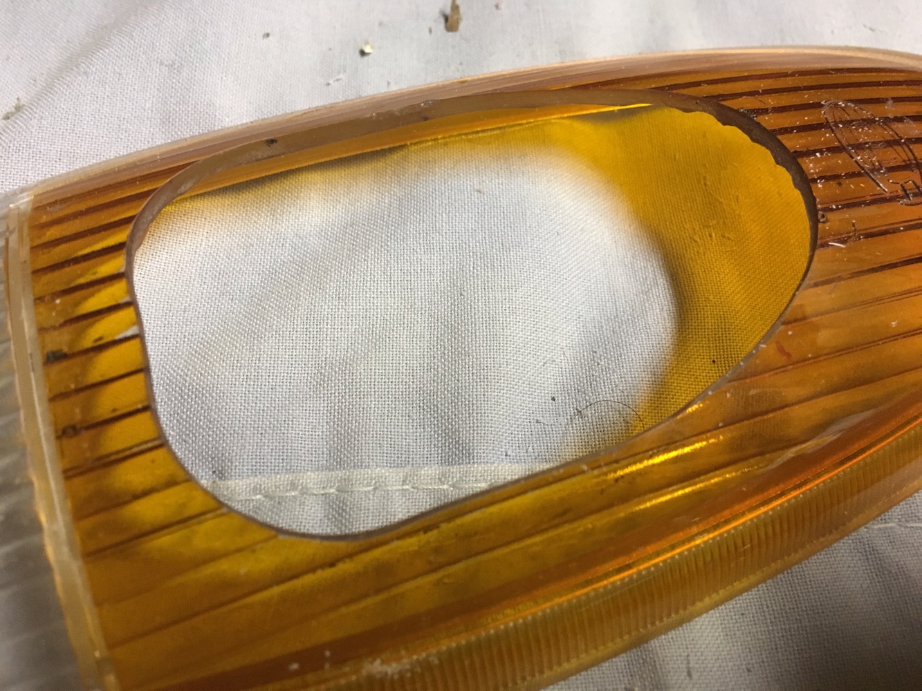

Garland   Start to finish 10 minutes per cut. Shaving off ju...   Jul 24 2016, 10:07 AM
whitetwinturbo   :popcorn: :popcorn: :popcorn: :popcorn: :popco...   Jul 24 2016, 01:35 PM
Darren C   Too scary for me... ;-) Well done! Now, how ...   Jul 24 2016, 01:43 PM
Garland   :idea: Thinking brutal, but can make a mess. So w...   Jul 24 2016, 02:29 PM
