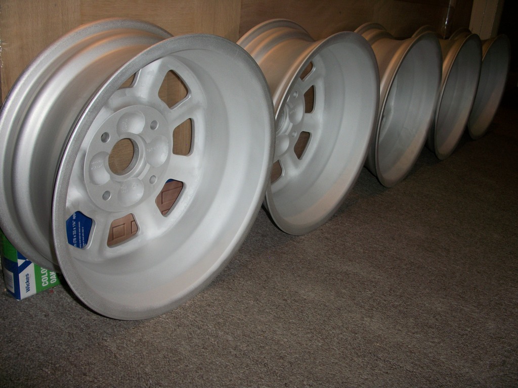

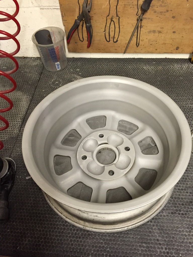

Today I got a friend to drive me over to take a look at the 1st “trial” light bead blast of the rear of the wheels.
(IMG:http://www.914world.com/bbs2/uploads_offsite/i265.photobucket.com-18255-1469382120.4.jpg)
I’m going to replate them with the clear anodise like they were originally, but the rear of the wheels needed a good clean up to prepare them for the process. Painting the rear or powder coating would be the easy option to “hide” corrosion, but my OCD wouldn’t let me live with a compromise here.
The result looks pretty good and I’m happy to let them do the remaining 4 rears of the other wheels. (The front face has been heavily masked up to stop the bead blasting getting anywhere near the polished surface).

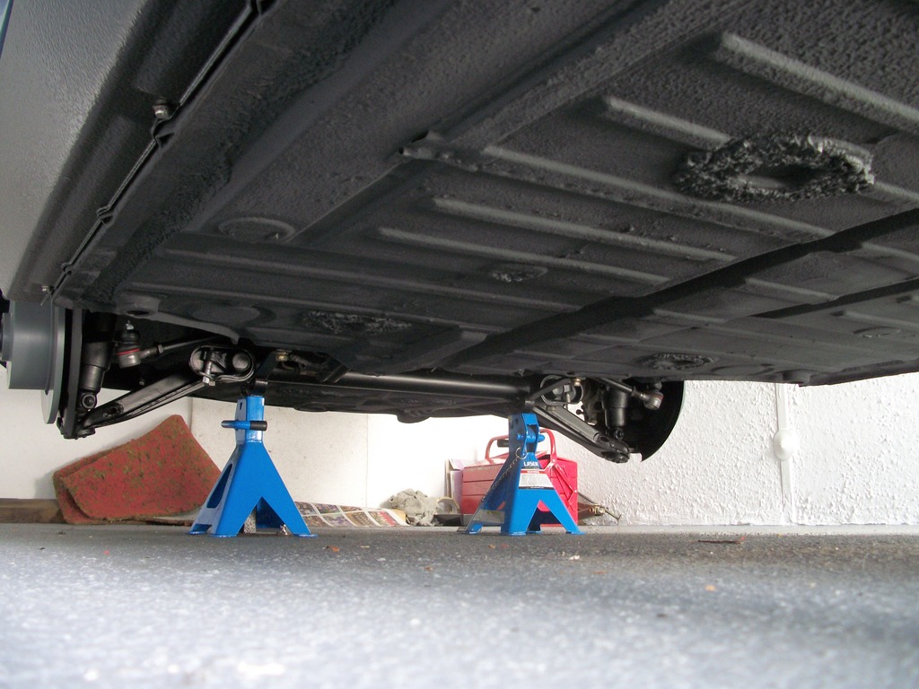

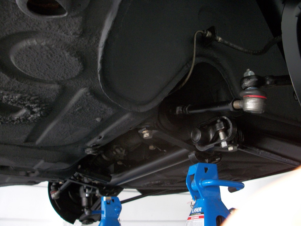

Today I made very good progress with repainting the floorpan.
I started this morning and with a combination of brushes of varying sizes and a sponge roller I painted the whole of the floorpan from the steering rack right back to the rear bulkhead and suspension.
It was a bit like painting a concrete block wall for the first time. In the end I gave up with the roller and used brushes. Due to the very textured underseal it took a lot of effort to work the new paint into the texture. Especially difficult were the circular areas and sides closest to the sills where the seam sealer is the heaviest stipple texture.
Again all this working upside down was a messy job with the runny stoneguard.
By mid afternoon I’d completed the floorpan. The stoneguard dries quite quickly and the front of the car was dry by the time I reached the back. I could then see some areas/spots that I’d missed so spent another hour filling in.
Tomorrow I plan a second coat and some photos

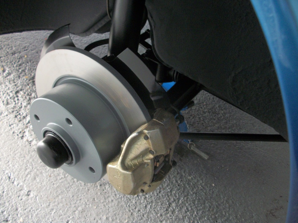

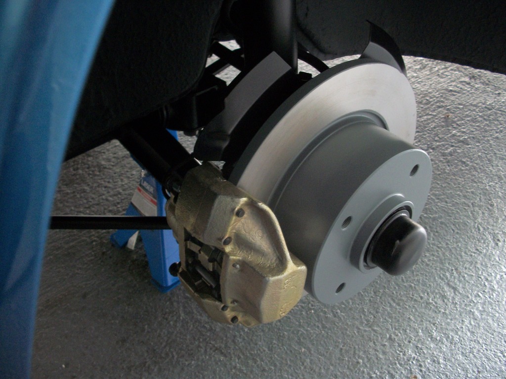

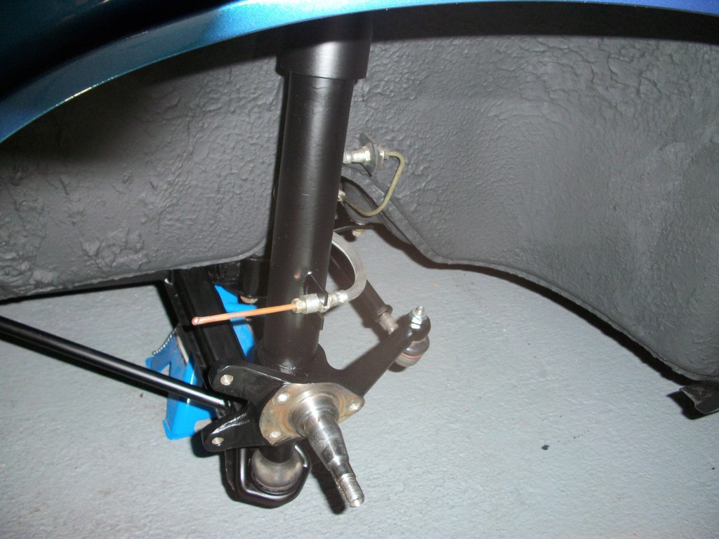

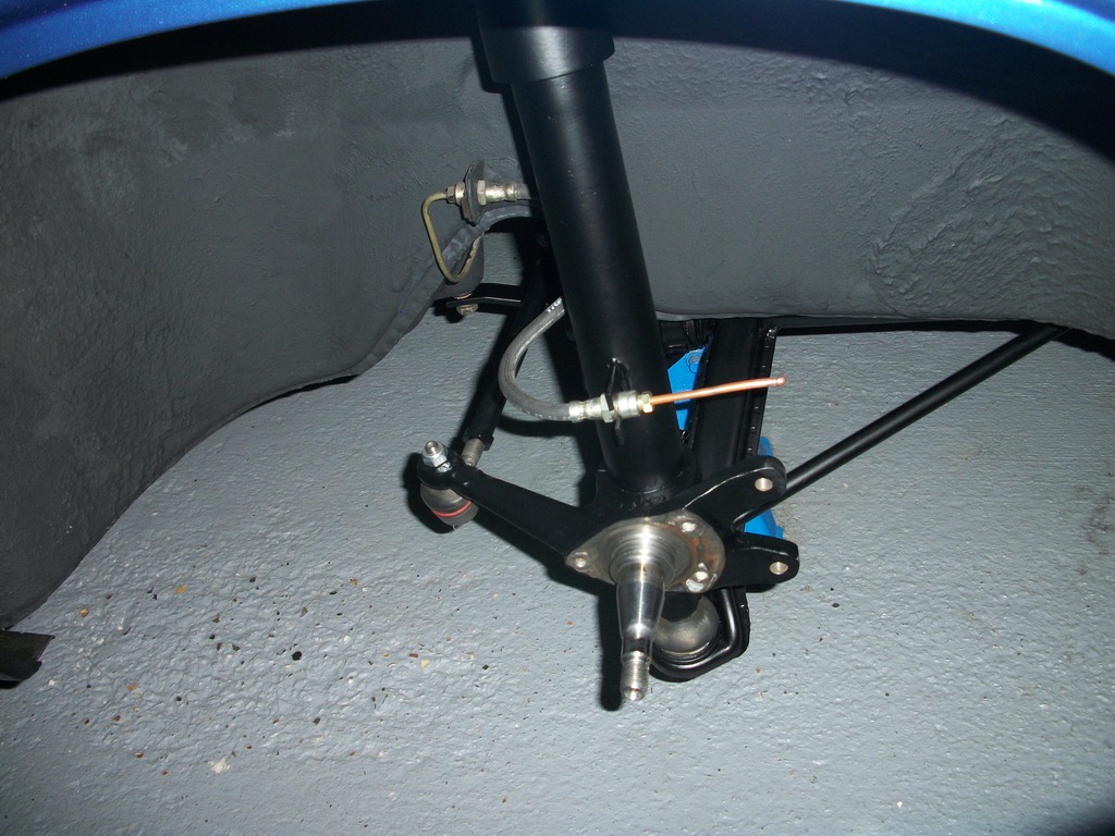

This morning I made use of the light at dawn and started early to assemble the front hubs. It was too cold first thing to paint so I started by fitting my new bearings into the Pelican Parts discs that I’d painted the other day.
I then re fitted the recently blasted and powder coated disc backing plates to the hubs followed by the discs.
I cleaned the paintshop dust from the brake callipers and refitted them next with new bolts and tab washers.
Finally the brake hoses were connected just in time for my son coming over to visit. While the morning air lost its chill, my son and I bled the brakes.

I’m quite pleased with the result. It was worth taking time to 800 grit wet & dry all the suspension parts to get a super smooth finish.
Again taking time to replicate the Porsche stone guard finish with care (unlike the original sprayed on that seemed to be splattered all over everything) makes for a neat look.
I just need to get the wheels back now and I can remove the axle stands and fit my blasted and powdercoated steering rack undertray.

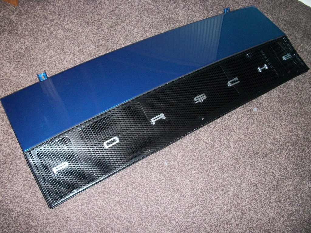

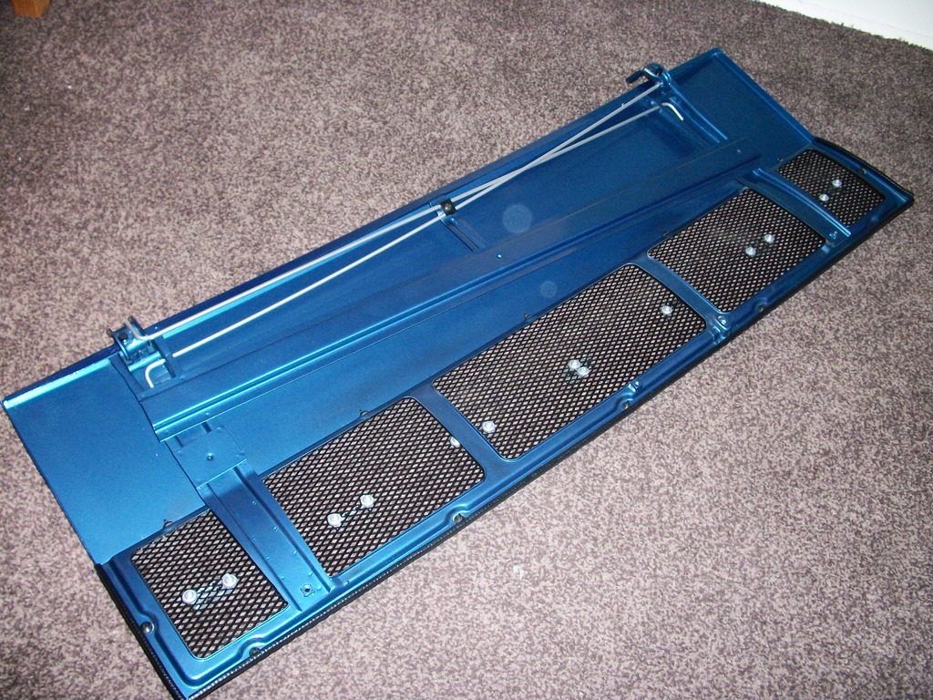

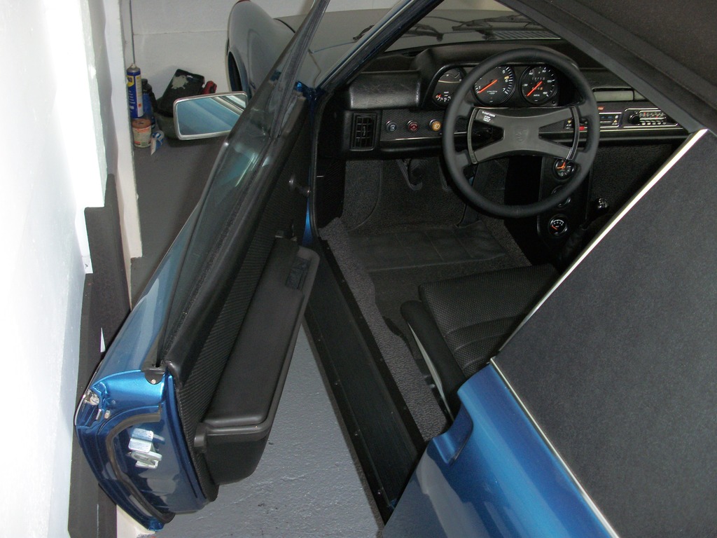

Yesterday I’d removed the horn push from the Steering wheel again. I wasn’t happy with the black paint. I’d spent ages getting it super smooth but it just looked too glossy against the rest of the dashboard.
With the sun shining and the temperature in double figures I lightly scotchbrited it and gave it a thin coat of satin lacquer to tone it down slightly.
This morning I woke up at 4am and couldn’t get back to sleep so after an early breakfast I decided to un mask the horn push and fit it back in the car.
Tonight after work it was one of my other monthly car club committee meeting and I knew I’d not be home until after 11pm, so if I were going to achieve something on the 914 today it had to be done early this morning.
With the horn push refitted it looks much better with the less glossy black paint.

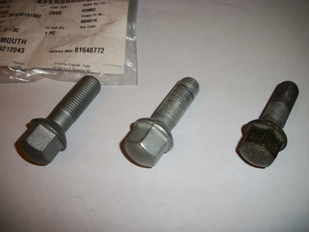

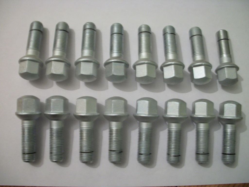

I retired to the shed this evening and started cleaning up the wheel bolt heads. The new missing wheel bolt turned up week before last from Porsche Centre and it has a dull zinc plate. I plan to get the bolts replated but need to clean and fettle them properly first.
Pretty boring stuff, filing a few burrs, wire brushing and sanding, but preparation is everything.

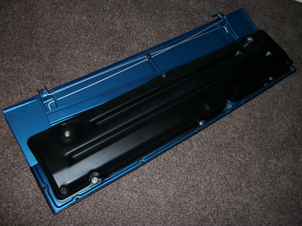

With the afternoon sunny and warm I mixed up some 2-pack lacquer and finished off the roll over edges of the wheel arches with a fresh mini gloss roller over the blue base coat I’d applied the other day.
I then crawled under the car and touched in a few little area’s of the stone guard in the original heavy ripple texture, where from certain angles I had missed a few valleys in the texture.

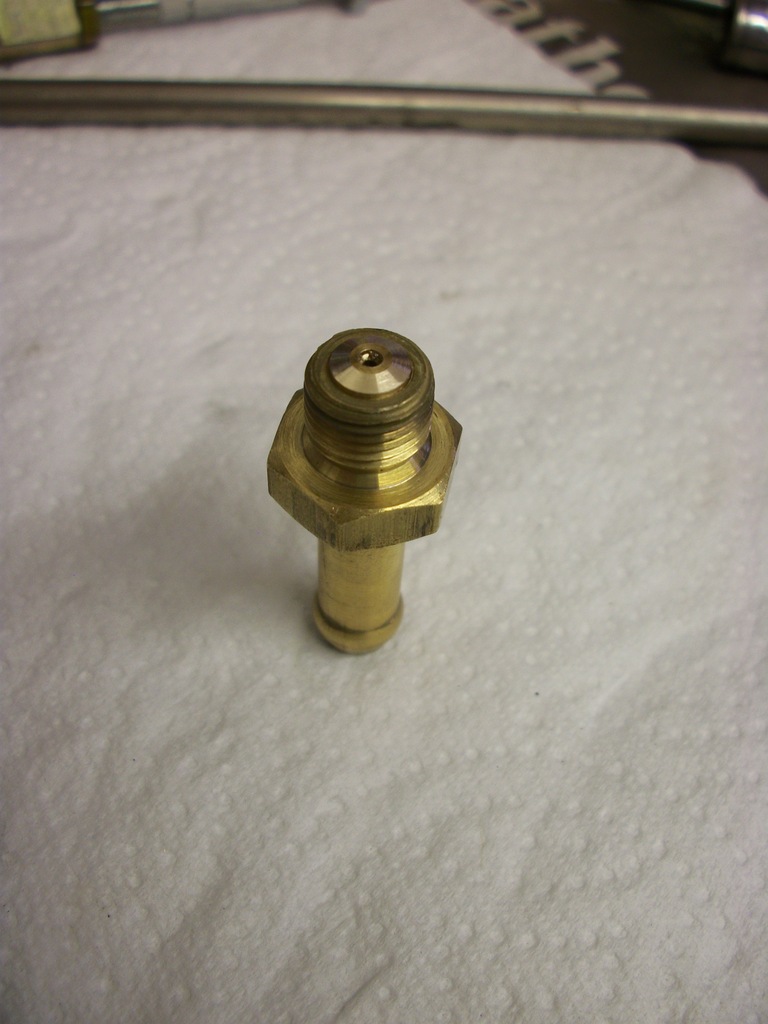

I also had an in line fuel pressure tester (with gauge) turn up in the mail today. I’ve wanted a professional one for a while and had knocked myself up one (cobbled from bits & bobs) that had started to leak a bit and I wasn’t sure on the gauge calibration so had taken the plunge and bought a new one.
I made up some extra fittings on my lathe this evening and shall have a play with the car fuel pressure tomorrow!
Day 295

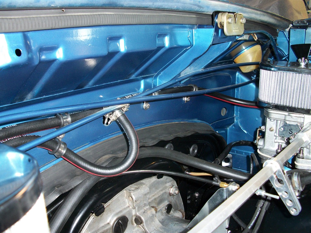

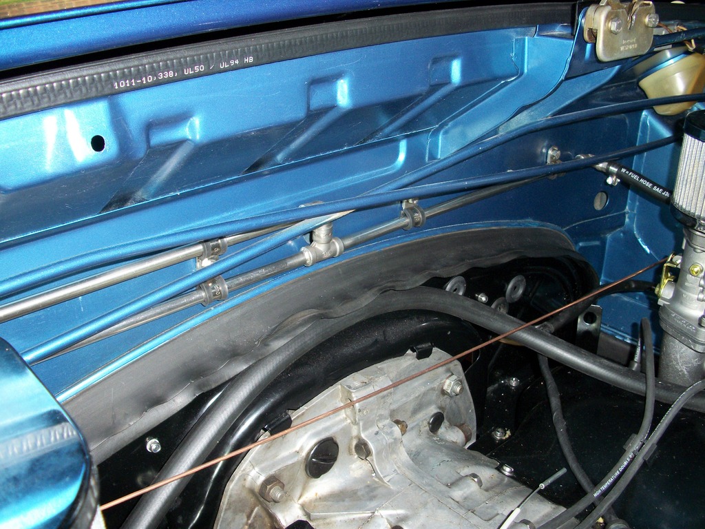

Today I did a little more turning on my lathe to make a fuel return bleed and assembled my new fuel pressure tester.
I sorted out the fuel hoses in the engine bay and tidied everything up. A trip down to the local gas station with two cans (with a stop for lunch) I put fuel back into the car. It’d been dry since pulling the tank out to replace the fresh air blower motor a couple of months ago. After replacing the fuel pump relay (removed while I was sorting out the cars electrics that needed the ignition on) I ran the pump and found a few leaks. These were repaired and the pressures set and tested.
After some more fettling I ran the engine and warmed it through while checking for leaks from over the whole system, tank to engine bay & back.
One of the criteria when the car went into the paintshop was that the painters could drive the car. I’d temporarily rigged up the engine & fuel system so that this could happen, but now I needed to make a more permanent (and safer) situation.
With everything looking good I stopped the engine and made use of the heat in the garage to touch in a bit more paint including the LH heat exchanger where the outer casing had moved/expanded along the pipes about 3mm and revealed bare metal needing painting.
I was interrupted by a neighbour with car trouble so gave him a hand to fix it before returning to the 914. Finally fitting a few tinware screws that were missing and clipping the throttle cable near the coil to tidy it up before calling it a day

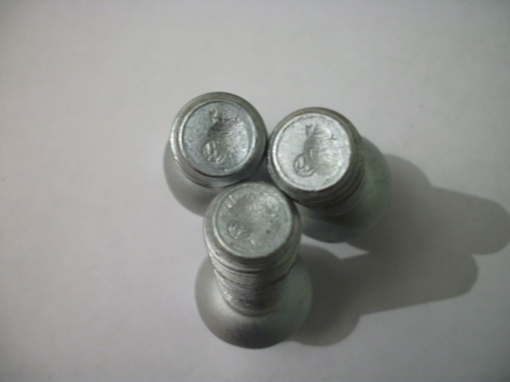

I took along the brand new single bolt as an example of how I wanted the old bolts refinished in dull zinc.
After an inspection and discussion they agreed to do a sample strip and replate on one bolt only as a trial.
Expecting to return tomorrow the guy said, take a seat, have a coffee and I’ll do it while you wait.
10 minutes later he came back with a electro stripped and replated old bolt.
The colour & matt finish was good but the old bolt hex head had some wheelbrace/ socket marking.
The new bolt (and my old ones when new) had a very slightly rough texture in the metal from the forging/manufacturing process. Over the years taking them off and on with a socket or wrench had “smoothed” the textured surface. Not easily seen when in the old condition, but once the bolt had been replated the smooth corners of the hex had quite a comparison to the textured centre of the hex flats. The smoothness makes the zinc plate look more chrome/shiny than even dullness.
After a bit of deliberation I plan to take all the bolts over to the bead blasters tomorrow (including the replated one) and have just the heads blasted to return the texture finish evenly to the hex flats.
Afterwards they can go back to the platers for a coat of dull zinc. I want a minimum 15 microns to give good rust resistance whilst retaining the surface texture.
I know its an OCD thing, but I want the car to be finished to a high level, and marks on the wheel bolts will drive me nuts.
Photo below show (from left to right) New Bolt, Test replated bolt with texture worn fron wrench use & old bolt as it was before test replating (remaining 14 are like this).
(IMG:http://www.914world.com/bbs2/uploads_offsite/i265.photobucket.com-18255-1469382121.10.jpg)
The plan is to get them looking like original brand new against the refurbished wheels without spending a fortune on buying all new bolts.
The new bolt from Porsche admittedly has a high texture finish to the head, which seems to be slightly rougher than my old bolts. It’s the wrench marks that really show as a “polished” smooth contrast to the texture that is my issue. It’s a little like the contrast of the Fuch wheels between dull and smooth surfaces. It really stands out, so off to the Blasters the remaining bolts go!

Today I picked up the freshly dull zinc plated wheel bolts. The pre blasting really did the trick and all the heads are now a nice even texture with no socket marks showing in the zinc plate.
(IMG:http://www.914world.com/bbs2/uploads_offsite/i265.photobucket.com-18255-1469382122.11.jpg)
The dark rings on the thread is where they were wired up to hold them in the tank for plating. This will have a nice coating of copper grease so should be fine when fitted.
I’m really pleased with how they came out. It cost me £10 to get them done which is just less than the price of the one new bolt from Porsche (which I needed anyway as I had a rogue Beetle bolt in there) What a bargain price to get them looking all like new again.
Interestingly the bolts had little VW stamps on the ends..
(IMG:http://www.914world.com/bbs2/uploads_offsite/i265.photobucket.com-18255-1469382122.12.jpg)

I’d picked the wheels up from the blasters on Friday and taken them home. The guy who works at the platers said he needed them pretty clean so that it wouldn’t contaminate his chemical tanks. The blasters had done the rear of the wheels as asked but the rims had lots of hardened black rubber marks from the tyre beads and the face of the wheels had old black and dirty stick foam from old wheel weights. All this had to come off before I could drop them off to be stripped of the original clear anodise coating.
It took me a good 2 ½ hours this morning to clean all this off with a combination of aluminium plate scrapers (I’d cut from some spare ali sheet) brass wire brushes, Cif cream (good olde Cif) and some pan scrubber scotchbrite (the green stuff that wont easily scratch) and a good amount of Cellulose thinners to clean after and remove the old grease from down and around the bolt holes
As it was a Monday and I’d had engineers working on a project at work over the weekend I needed to go into work before the Hospital appointment at 10:15. I had breakfast on the run, loaded the car with the wheels and shot off for 2 hours at work before leaving in good time for the Hospital.
Today I had an EEG test following my TIA last month, where they wire about 30 electrodes on your scalp to measure your brain waves, make you look at strobe lights and hyperventilate until you start to starve your brain of oxygen (all in the name science).
What they don’t tell you is that they measure and mark your head/hair with a pastel crayon then a sort of paste and glue the electrode onto your head, so by the time it was time to leave I had a head covered in goo, sticky stuff and spots of yellow pastel crayon. Not a good look and certainly gave me a few funny looks on the walk out of the hospital!
Anyhow, still looking like some crazy punk rocker I dropped the wheels off at the platters to get them stripped of the clear anodise before rushing home to wash my head.
After a manic wash and brush up I leapt back in the car, hair still wet and raced to Chichester Hospital for a 2pm MRI brain scan.
This was a novel experience too. Stripped of any metal jewellery, clothing containing metal and fitted with ear plugs and ear defenders, my head was sat in a cradle with a cage place over it while I entered the large donut MRI machine. This banged, clunked and buzzed in an alarming way for 20 minutes with me daring not move a muscle as it carried out an in depth brain scan.
Fun over I asked the lady where I collect the photo (in a sort of Roller Coaster, end of the ride way).
Back in the Hospital carpark I turned my phone on and got a message to say the wheels had been stripped and were ready to collect. By now it was 4pm and a toss up between going back to work for an hour or picking up the wheels. Guess what choice my fried brain made……
(IMG:http://www.914world.com/bbs2/uploads_offsite/i265.photobucket.com-18255-1469382122.13.jpg)
They’ve come up like brand new!
Tomorrow the next stage of this refurbishment process is to go back to the blasters to gently blast the dull area’s between the polished petals to remove some old battle scars (scratches, knocks from lazy wrench action etc) to give a uniform texture before going off to the polishers.
Once all this is done they can be re anodised in clear. I forgot to mention that when I dropped them off this morning before work the chap used a special meter on them to measure the original factory anodise thickness. This ranged from 8.5 microns on the face of the petals (which you can only presume wears thin with washing over 40+ years) to 11 microns on the inside of the wheel (under the tyre where it cannot get washed/rubbed)
The platers reckon they can get 20 microns on them when they re anodise, so hopefully this will exceed the factory finish and prove to be longer lasting.

I had a few parts turn up in the mail today including the majority of my 316 stainless pipe fittings that I plan to construct a neat Twin Carb fuel rail with. (This is the one I mentioned designing last month).
After unpacking the pipe fittings I started on the new stainless fuel rail and made up the parts ready for Tig welding.
I should have enough bits to keep me going this weekend while the wheels are still away. I’ll take some pictures tomorrow of progress as I’ve not been home in daylight today, early start and long day at work getting in the way of the 914 restoration!
Day 301
Today I had a good day making stuff.
Since the weather was awful I spent the day in my shed and cut and treaded some stainless pipe to make up a nice fuel rail with centre feed so as not to starve either carburettor. To ensure that there was no risk of fuel leakage from any of the thread fittings, all joints got stainless Tig welded up.
To make sure all the welds and joints were good I capped the ends and pumped it up with my foot pump to 10 psi. (I plan on running between 3 & 3.5 psi, so a test at 10 psi is more that sufficient). To double check I submerged it in the bath tub for a good while and all went well.

Next I turned down a fuel bleed/return. When running carbs with an electric pump it helps to have a bleed/return to keep the pump happy when the engine is at idle and the floats are closed. It also helps to cool the pump if there is always a flow.
The easiest way to do this is machine out a shouldered bore inside a spare carb hose tail. After rummaging in my shed I found some old bits of carb and unscrewed a hose tail. This was lightly bored out on my lathe and from a scrap bit of brass I turned an insert with 1mm bleed hole. It’s always important to turn a chamfer/cone on the end facing against the fuel flow. This helps if there are any dirt or particles in the fuel system. The hole is less likely to block as the dirt/debris tends to head down the chamfer/cone to the sides of the pipe and keep the hole clear.

I had a good day fitting parts to the car and making a few adjustments to get this just right.
As I’d said earlier in my thread, Carbs were fitted from my shed stock way back in November to get the engine running for the first time in several years so that I could find out just exactly what I’d purchased blind. The paint shop had also said to me that they’d only take the car in for paint if it drove, so carbs were a quick no cost solution for me as I have numerous old & new sets in my shed from my VW days.
I temporarily fitted rubber fuel hoses and used rivi-nuts in the factory holes in the bulkhead between engine bay and trunk to secure the fuel hose to the bulkhead with stainless rubber lined P clips. (This picture is from last November)
(IMG:http://www.914world.com/bbs2/uploads_offsite/i265.photobucket.com-18255-1469382123.16.jpg)
Moving on to today I fitted the stainless steel fuel pipe manifold I’d just made using the same rivi-nut fixing points for a much neater and safer out of the way installation.
(IMG:http://www.914world.com/bbs2/uploads_offsite/i265.photobucket.com-18255-1469382123.17.jpg)
Just need to hunt down some tiny metal tubing this week to make a nice twin vacuum tube between carbs and dizzy.

Today I picked up a few stainless fixings and this evening I fitted the refurbished water tray to the inside of the engine lid. I discovered why the tray was cracked when I got the car. There should be two bushes in between the tray and the two outer M6 securing bolts. Without them the bolt pulls the tray into the metal pressing and cracks it. I’d repaired the tray and only when looking at the PET last night for the M6 bolt lengths did I see the Bushes. These were missing from my car. I can only guess that when the Muppets who carried out the awful respray for the PO back in the past, took the tray off, lost the bushes and bolted it back on pulling up the bolts tight and cracking the water tray.
Anyway, suffice to say I’ve made new ones this evening and bolted on the repaired tray without issue.
(IMG:http://www.914world.com/bbs2/uploads_offsite/i265.photobucket.com-18255-1469382124.19.jpg)
The grille I fitted last night with the rubber T seal was causing me some concern. The last and first inch of the seal has to have the bottom return lip cut off to clear the lid pressing. This means with a 914rubber seal (unlike a more rigid plastic original seal) it seems to just flap around as it’s too flexible. Last night I masked it up, after posting on here, and injected a tiny amount of Tigerseal between grill and lid at each end of the seal and stuck it back in. With a small bit of masking tape to hold it in place I left it to dry until today.
With the tape removed it was held perfectly in place with no Tigerbond visible. No more flapping about and hanging out.
(IMG:http://www.914world.com/bbs2/uploads_offsite/i265.photobucket.com-18255-1469382124.20.jpg)
