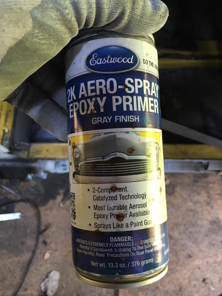

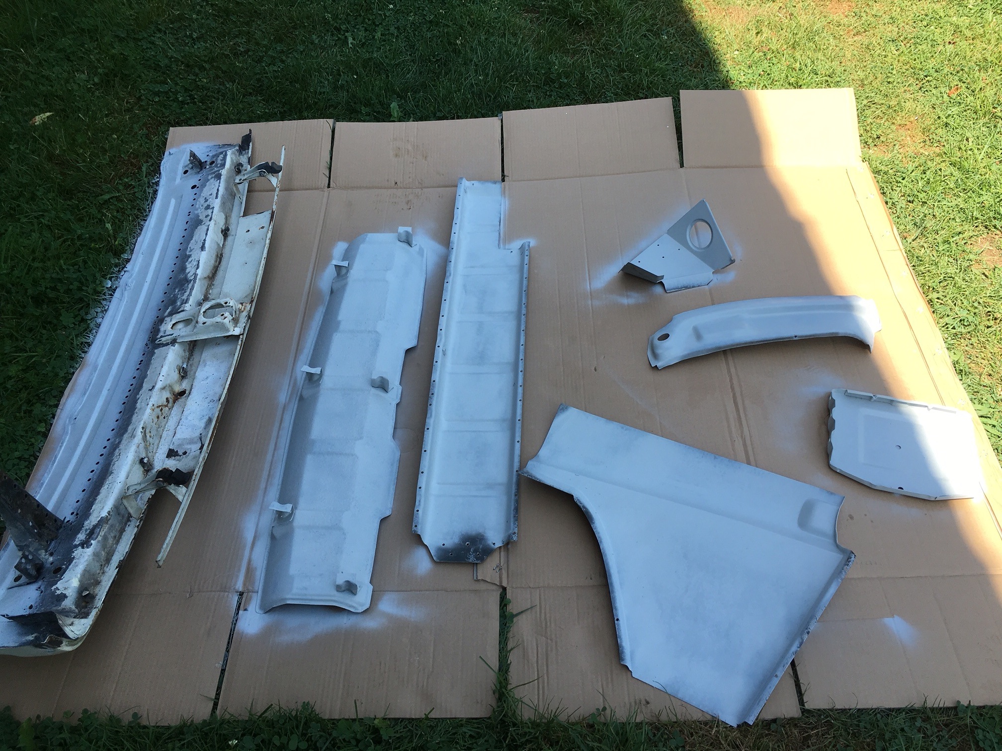

This was the perfect opportunity to try out Eastwood's two part Epoxy in a can. I coated inside the long and the back side of a few parts that I still have to install. Overall its a pretty decent product. It sprayed well and it had more in the can than I thought. It was great for a smaller area. When I paint other areas of the car though, I will use regular spray gun epoxy.

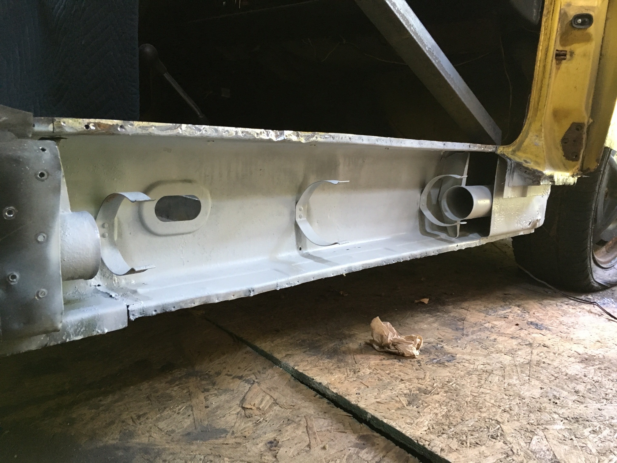

dlee6204   Sill plate welded on. :welder: Ground down a...   Jul 24 2016, 07:02 PM

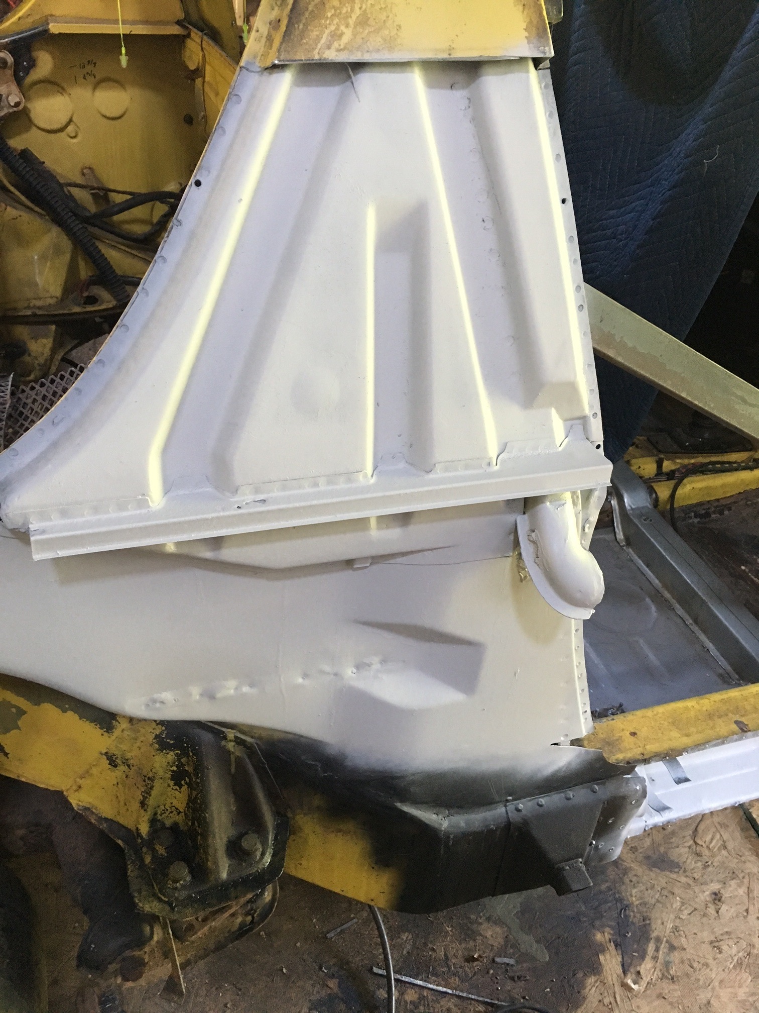

dlee6204   Got the rear trunk, reinforcement, and heat shield...   Jul 30 2016, 07:38 PM
