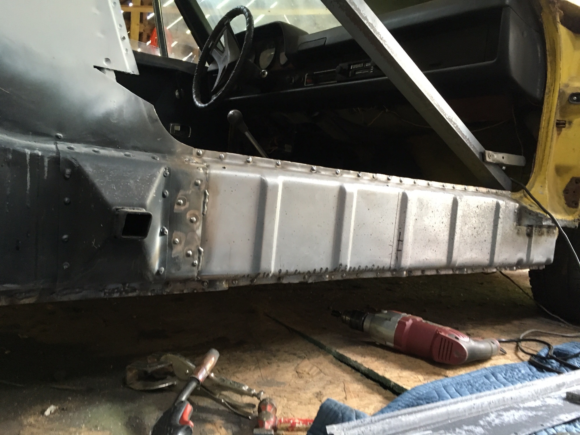

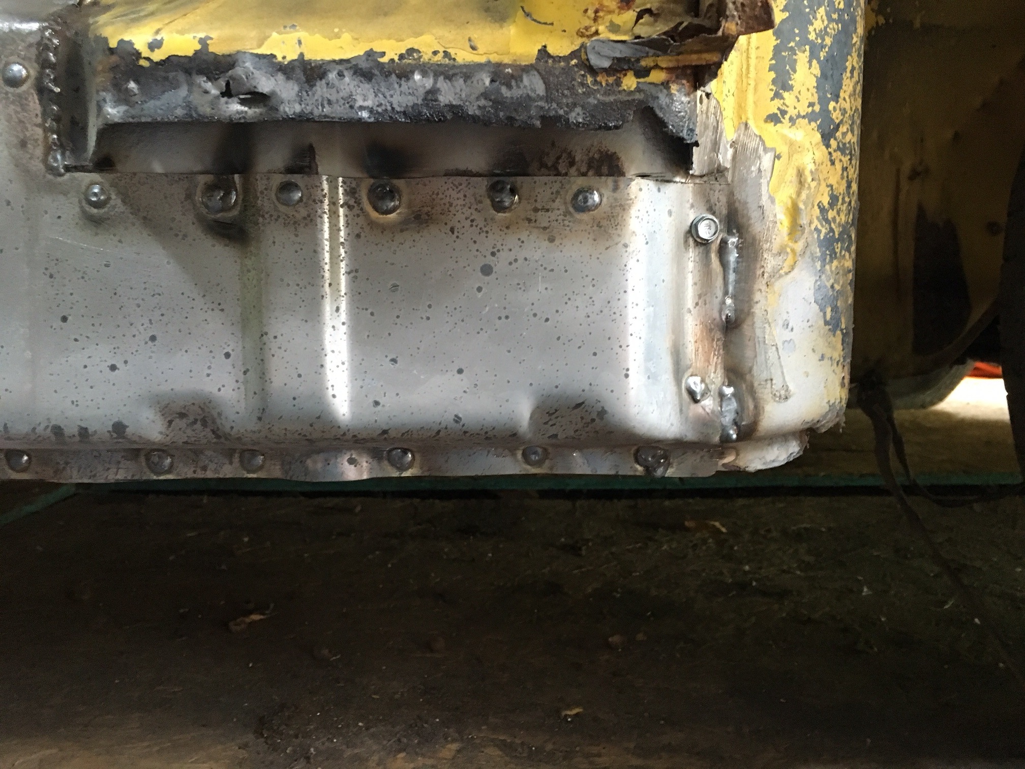

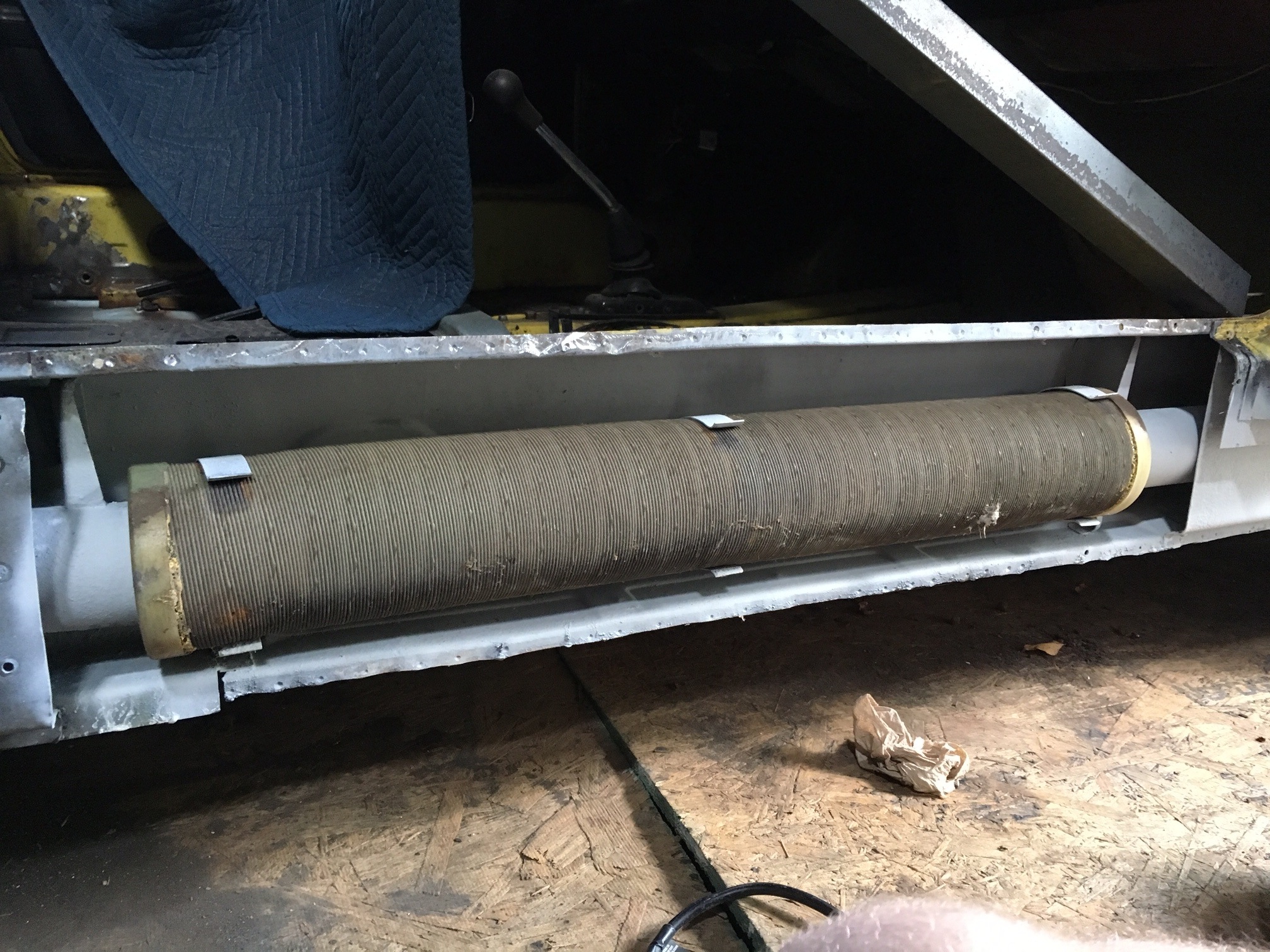

dlee6204   I tore into the long tonight. I first braced the ...   Jun 1 2016, 06:43 PM
dlee6204   Got my inner long welded in. :welder:   Jun 6 2016, 04:07 PM

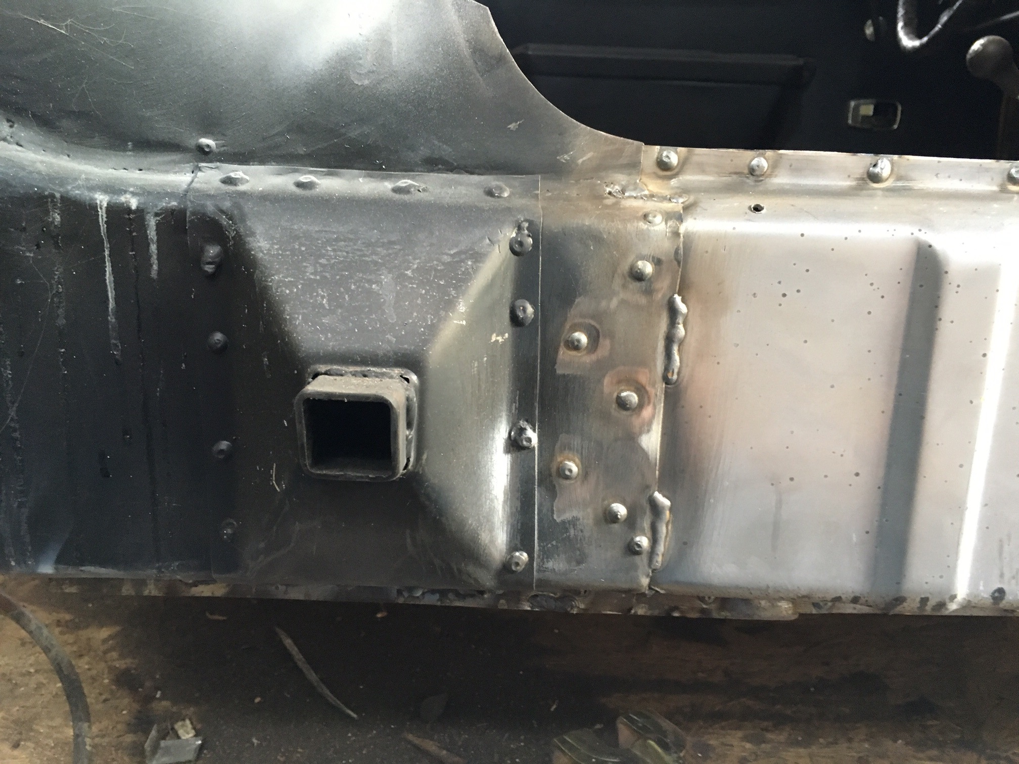

dlee6204   Been working on some small stuff. First, got o...   Jun 9 2016, 03:49 AM
dlee6204   Got the upper part of the long installed and the j...   Jun 9 2016, 03:35 PM
