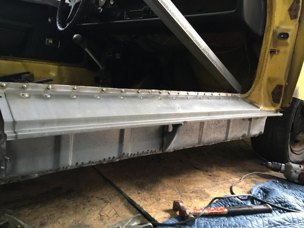

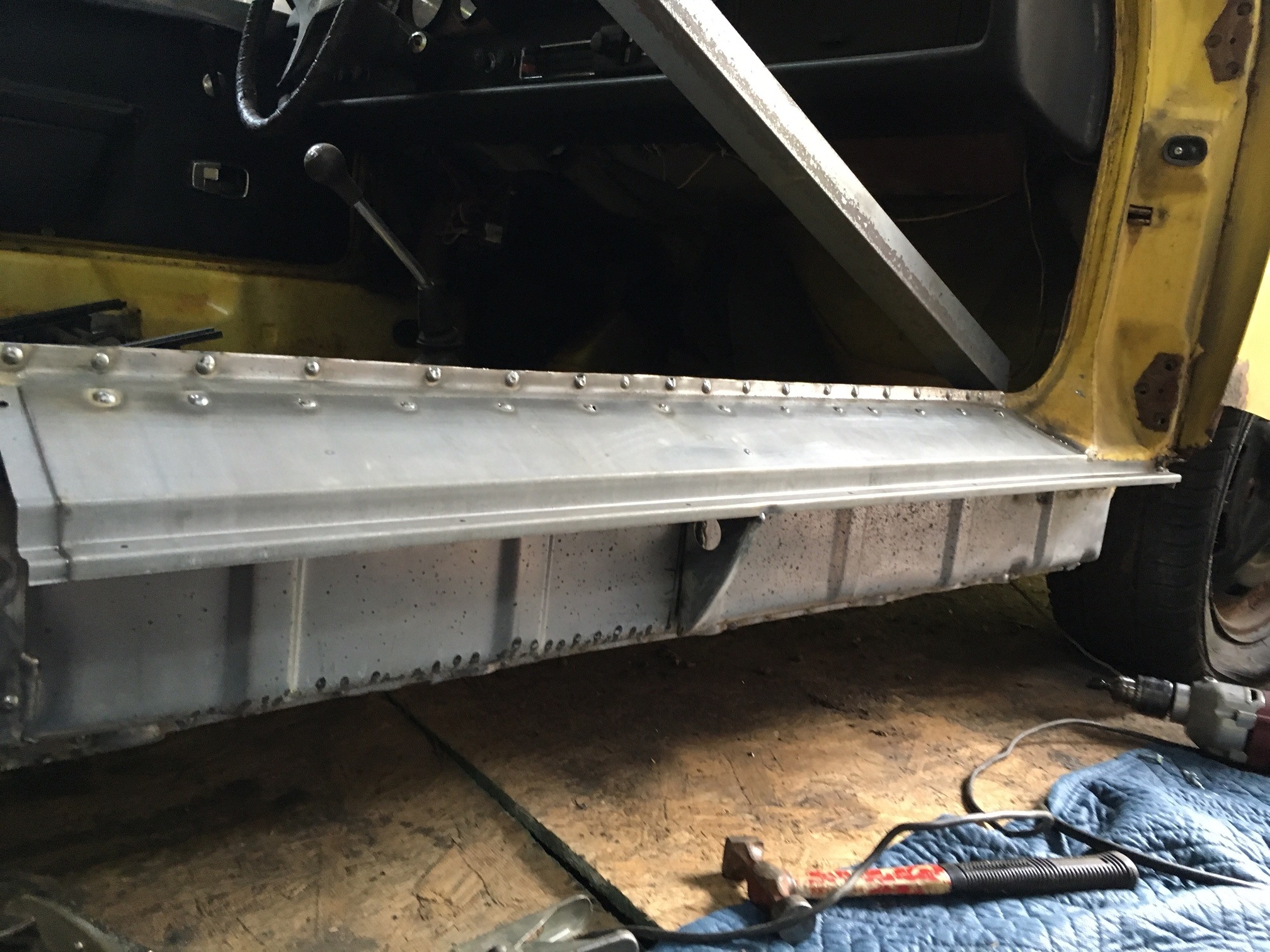

Here's the underside of the passenger long. I was able to jack the car up and door gaps didn't change (IMG:style_emoticons/default/piratenanner.gif) .... Heck, most 914s I bring home don't even have a place to jack it up anymore.

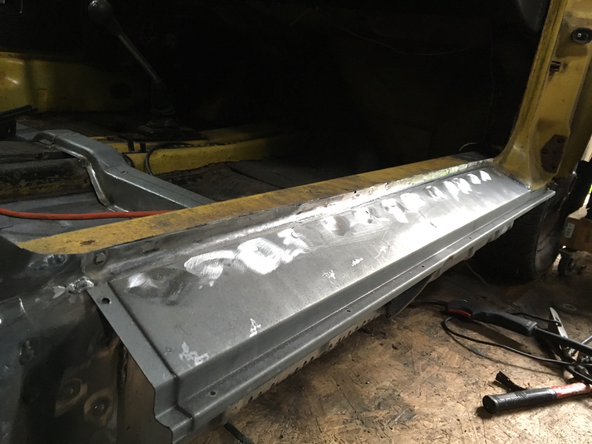

Sill plate welded on. (IMG:style_emoticons/default/welder.gif)
Ground down all my welds up top. Also Removed my door opening brace.
Removed brace and reinstalled door. Gaps are still perfect! Awesome! (IMG:style_emoticons/default/thumb3d.gif)

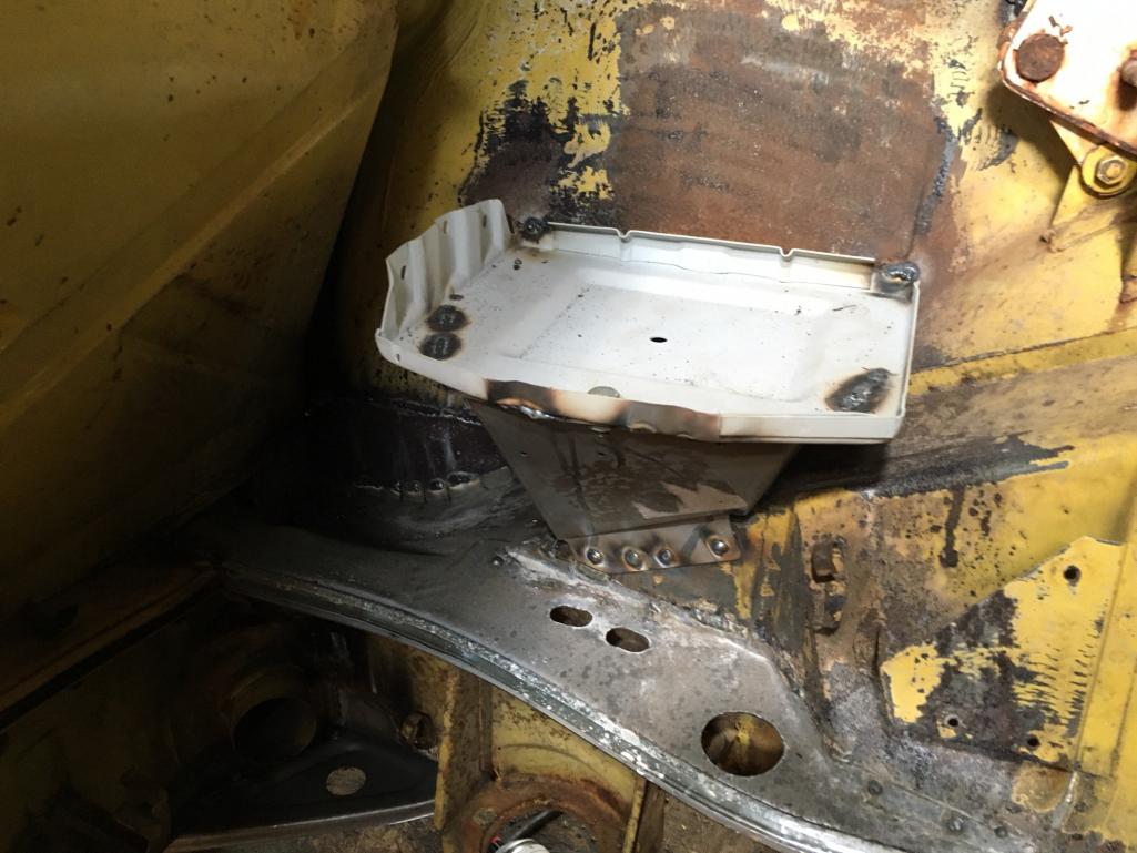

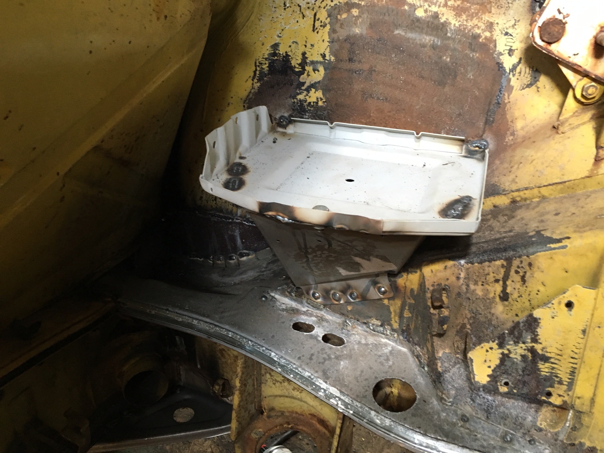

Also installed the battery tray. I coated the backside with epoxy of both pieces before installing.
