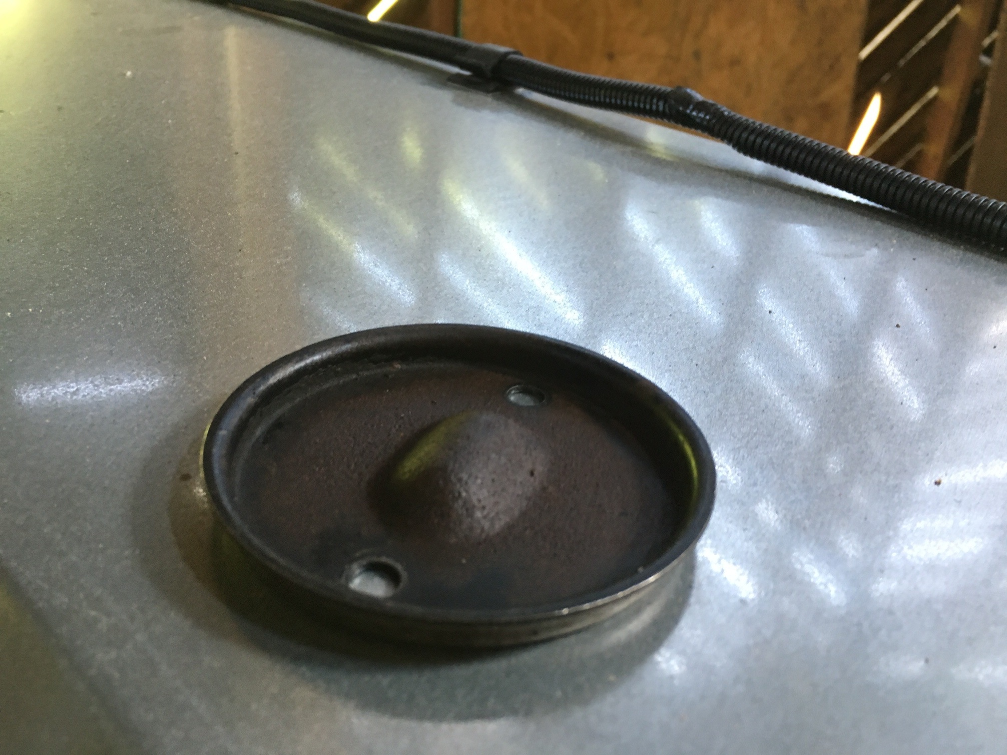

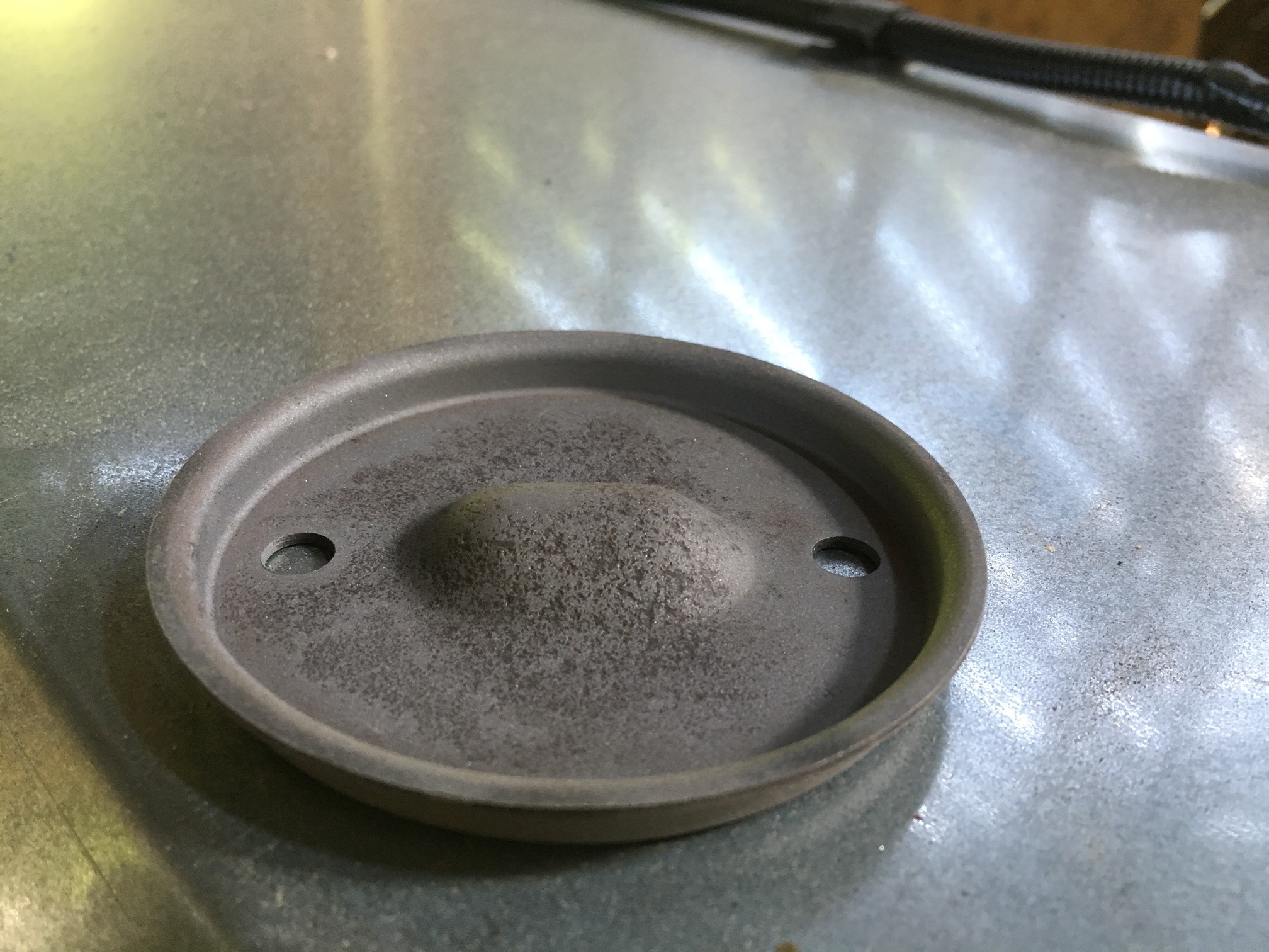

dlee6204   I also gave my blast cabinet a test run. I could ...   Jul 24 2016, 07:05 PM
