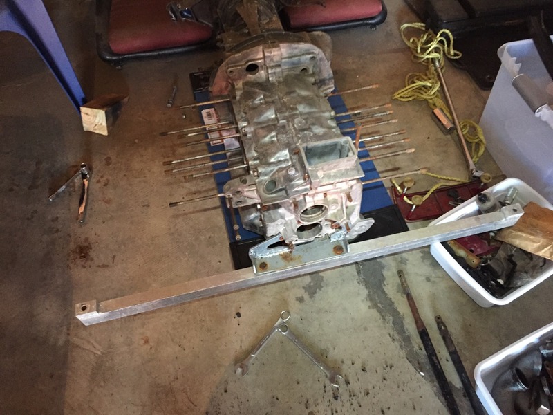

After a sweat-filled couple of hours this afternoon, the engine / transmission are out!
(IMG:http://www.914world.com/bbs2/uploads_offsite/i120.photobucket.com-19557-1469415982.1.jpg)
(IMG:http://www.914world.com/bbs2/uploads_offsite/i120.photobucket.com-19557-1469415982.2.jpg)
PO's all aluminum, lowered engine hanger / cross bar / mount: (this may go away)

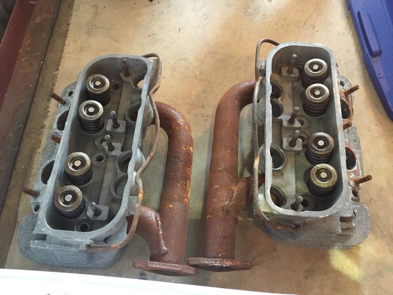

These heads were supposedly rebuilt with a 3 angle valve job, but have sat outside since and have rusty valves now. Thinking I will probably have them blasted and have new valves put in.

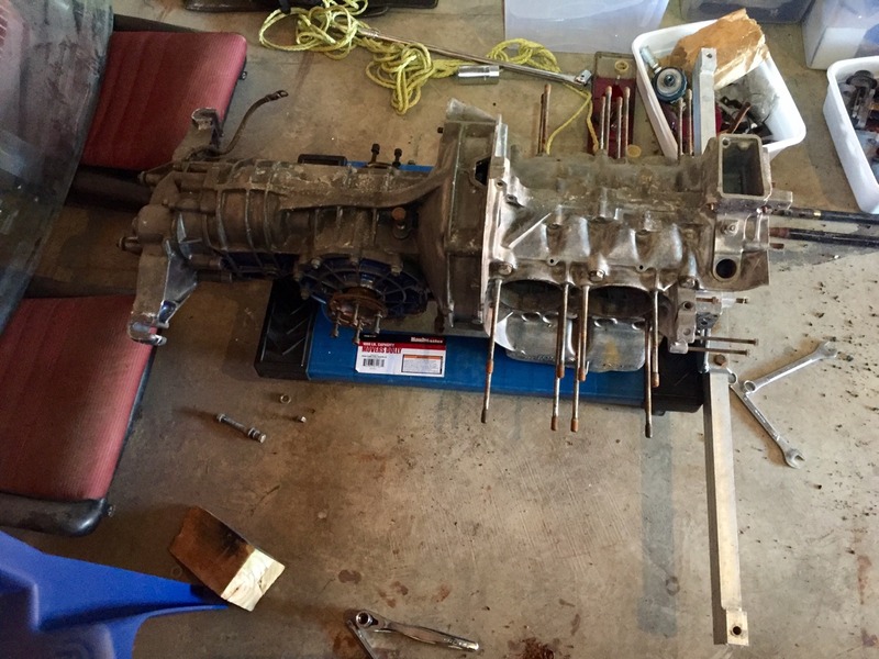

I believe this was the PO's "short shift kit"

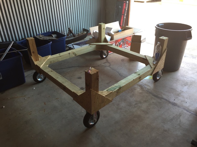

My body stand, ready for action. (Plans stolen from: Steve_R)

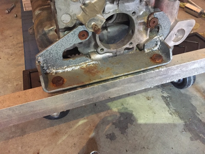

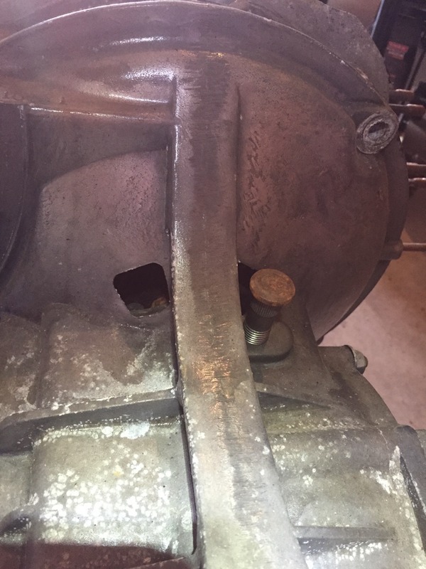

Quick question(s). 1) are these inspection holes from the factory in the bell housing? 2) what is the large bolt threading into the transmission case?
(IMG:http://www.914world.com/bbs2/uploads_offsite/i120.photobucket.com-19557-1469415983.8.jpg)

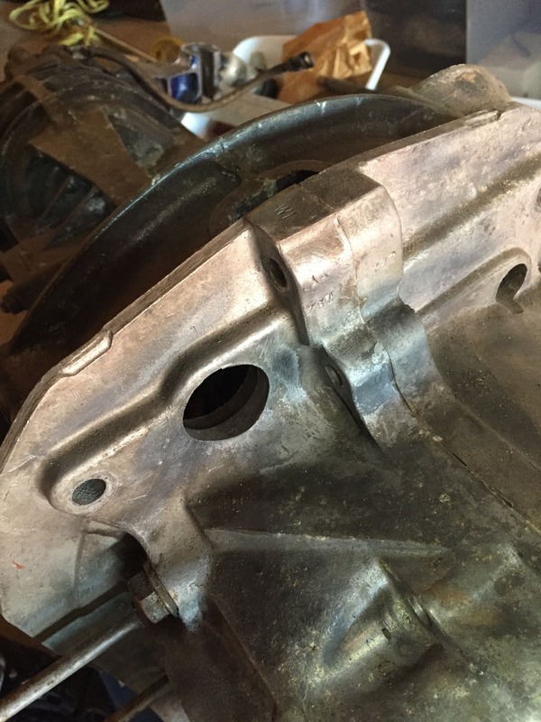

Also - is this another factory inspection hole? (GC case)
(IMG:http://www.914world.com/bbs2/uploads_offsite/i120.photobucket.com-19557-1469415983.9.jpg)
Yes on inspection holes. The bolt doesn't look stock. Typically there is a breather there. Google pics of the 901 transmission and you'll see what's supposed to be there.
