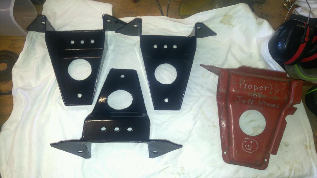

Finished the 3.. Powdercoated to prevent rusting and obviously where it will get welded will be ground 1st.

396   Your reproduction of the factory bulkhead mount is...   Jul 19 2016, 04:53 PM
mb911   Your reproduction of the factory bulkhead mount i...   Jul 19 2016, 05:25 PM
mb911   Here is the engine side before I finished and powd...   Jul 19 2016, 05:30 PM

mb911   Thanks I appreciate the words of encouragement. I...   Jul 21 2016, 11:41 AM

mb911   Finished the 3.. Powdercoated to prevent rustin...   Jul 25 2016, 12:45 PM
