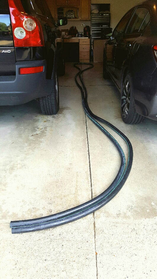

Fuel starvation? Weird. Did you buy a JDM?
Look what came today:
2 914 limos worth:
Just boxed your half up. Should get it to Fed Ex tomorrow.
