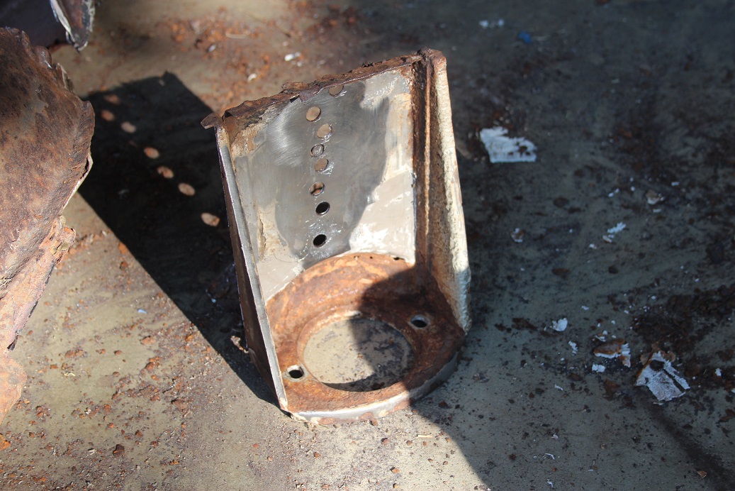

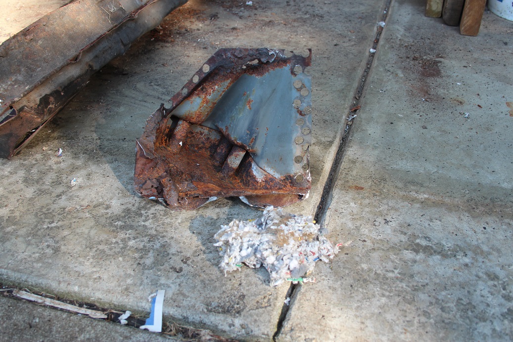

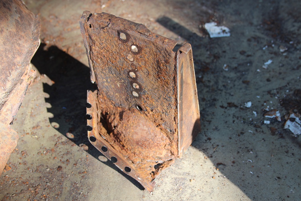

More dissection... Cut the suspension pylon and motor mount out to see if it could be salvaged though I was pretty sure they were a lost cause. I think I was right, here's the result...
Hydrogen hydroxide: if it can do this to car parts, imagine what it does to your insides!
Nobody makes these do they?
Got the mouse nest- no mice left, I guess they figured the old house was no longer structurally sound. Little mouse inspector probably condemned it...
