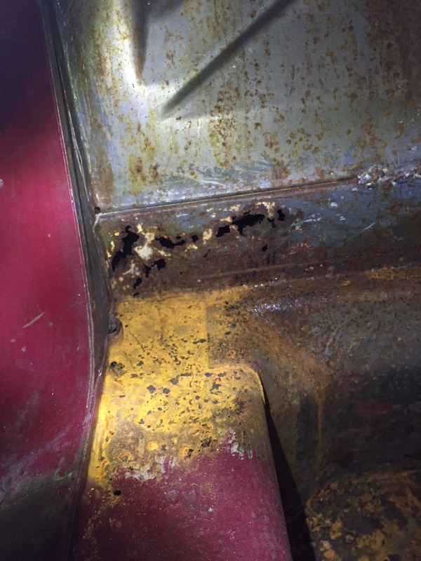

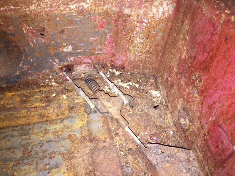

I thought I'd post some additional pics of the firewall rust spots.
This one I knew about and can be seen from both sides. It looks like it will be a fairly simple rectangle patch with a couple of breaks.
(IMG:http://www.914world.com/bbs2/uploads_offsite/i120.photobucket.com-19557-1469720726.1.jpg)
This one was new to me, where the firewall meets the floor. Hard to tell in this pic, but bottom right corner of the pan.

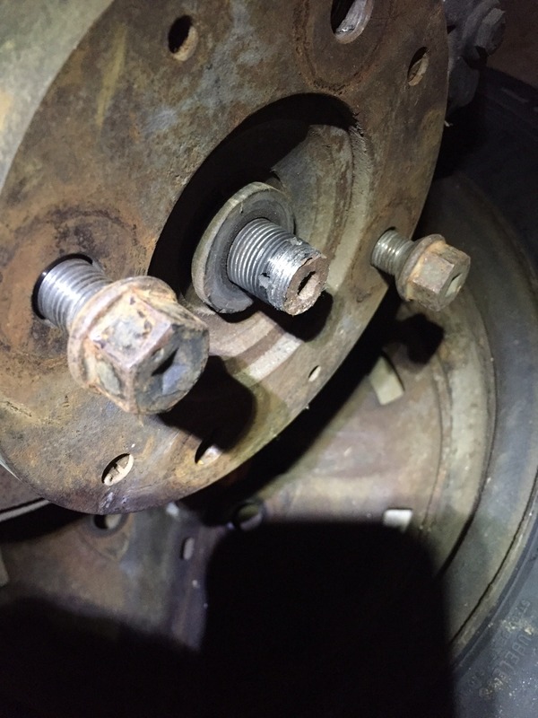

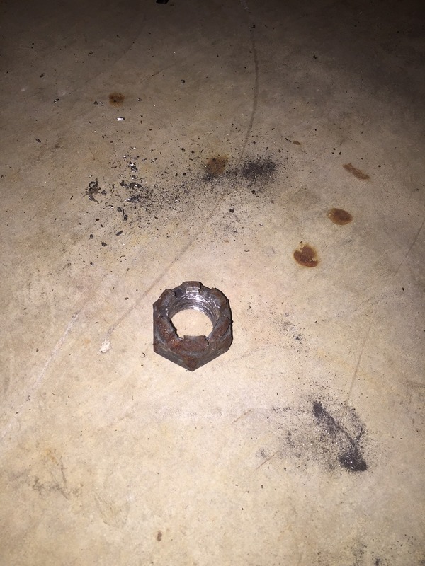

I attempted to remove the axle nuts last week with a big ass breaker bar and 3' piece of pipe with no luck, I was spinning the tires on the concrete. So I broke out the impact wrench. The driver's side came off easily enough - but the passenger side was really stuck and once it loosened, tore up threads on the way out. I'm not sure if it was possibly cross-threaded at some point or if the threads were rusty / dirty.
The axle nut is trash but the axle shaft might be salvageable? When fully torqued, the nut would still be in contact with all threads plus it gets a locking cotter pin. Or should I just replace?
