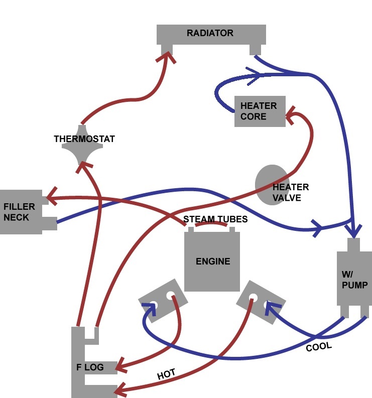

This is from an old Renegade diagram but the basic location of items YOU have are easy to identify. If you have issues, PM me your cell and I'll be happy to walk you through this over the phone. Good luck!
Tony

BRAVE_HELIOS   Hey all, I had a chance to draw up what I think w...   Aug 8 2016, 05:07 PM
Chris914n6   Header tank goes inline = same hose. I'd say o...   Aug 8 2016, 05:15 PM
BRAVE_HELIOS   I believe that is what I show with what I have mar...   Aug 8 2016, 05:23 PM
BIGKAT_83   Hey all, I had a chance to draw up what I think ...   Aug 8 2016, 06:11 PM
Chris914n6   I'll admit I don't have a sbc, so I don...   Aug 8 2016, 07:55 PM
