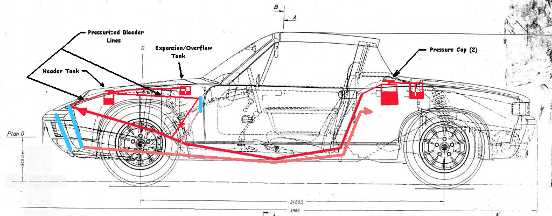

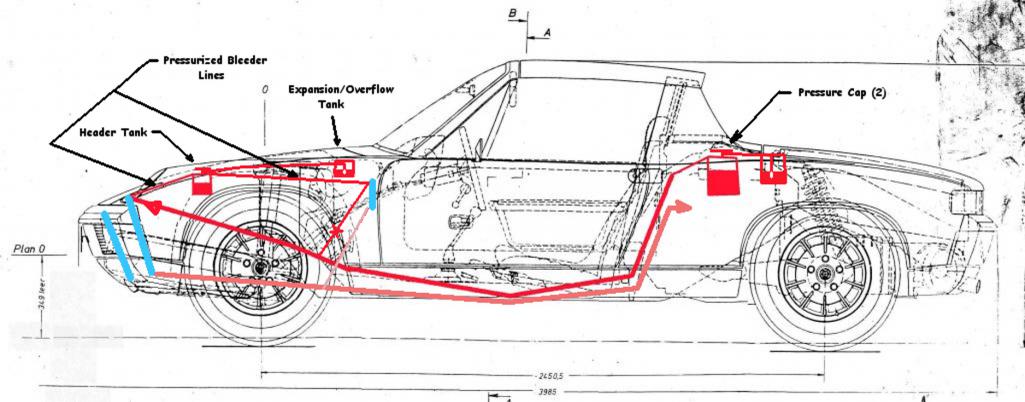

BRAVE_HELIOS   Hey all, I had a chance to draw up what I think w...   Aug 8 2016, 05:07 PM
Chris914n6   Header tank goes inline = same hose. I'd say o...   Aug 8 2016, 05:15 PM
BRAVE_HELIOS   I believe that is what I show with what I have mar...   Aug 8 2016, 05:23 PM
BIGKAT_83   Hey all, I had a chance to draw up what I think ...   Aug 8 2016, 06:11 PM

veekry9   :D In and Out holes. :) A handy and ne...   Aug 11 2016, 05:49 PM
BRAVE_HELIOS   Thanks veekry9! Your expansion tank connection...   Aug 13 2016, 03:58 PM
