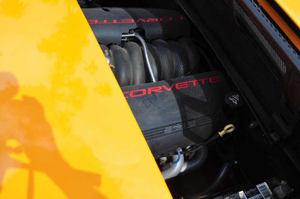

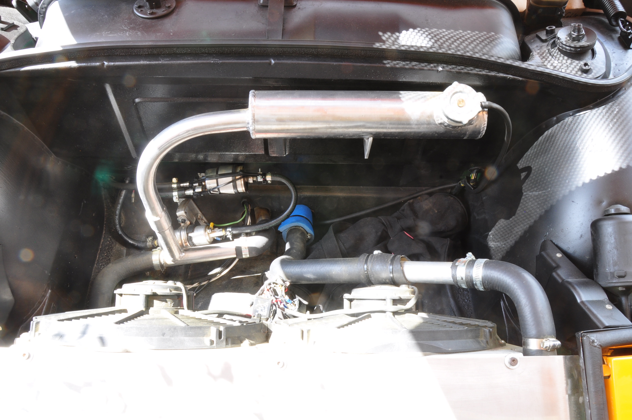

This is the system I built for mine. The puke/de-airer tank is built from scrap 3"
alum. conduit tied into the low pressure side. The tank ends up being slightly
higher than the block. I ran 1" alum conduit under the car for lines to the engine.
I do not run a thermostat, it runs around 195 F. I don't turn on the fans until she reaches 180 or so. I also am using a belt driven (F-body) pump.
It is my belief that most cooling issues are do to air trapped in the system.
This cools my hopped up LS1 without issues. Good Luck! Bob

v82go   This is the system I built for mine. The puke/de...   Jul 30 2016, 09:29 AM

v82go   Hi The puke tank is pressurized and since being h...   Jul 30 2016, 10:45 AM
