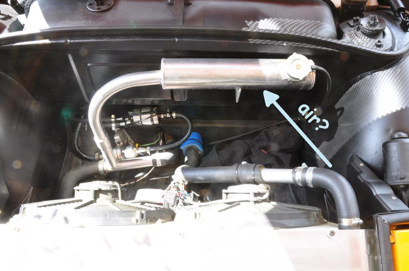

Can anyone divulge details on the Renegade Hybrid radiator system such as dimensions, Inlet and outlet sizes and rad type (number of rows, if cross flow etc...). Is it even allowed ;-)?
This hot summer has proven that my system cannot handle it. I have some good components such as a 2000 cfm, 9 blade fan out of a Ford Taurus. The remote mechanical water pump is a standard R.H. unit. I also have a Griffin radiator, model 125241-H... no radiator cap (inlet=1.5" and outlet=1.75").
https://www.summitracing.com/parts/gri-1-25241-x
The dimensions are 16"x 27.5" x 3". it is a 2 row unit. Although the inlet/outlet sizes are different, the hoses carrying coolant from front to rear are all the same size at 1.25 inch diameter. The Tech rep at Griffin seems to think that the rad should be fine but I ain't no 4 core unit either.
The other part of this is the car has a Chalon kit installed. I question whether the bumper opening for rad air is sufficiently sized. The opening is ducted to the bulkhead opening. The inner fender walls are fully open to allow the air to exit.
From all that I've read; the viable solutions is to either go with a RH rad setup (or as close to as possible) and/or go with an electric water pump. I think I have some (most) of what RH would sell me as there rad kit. The only difference I can see is the rad size/type and the bumper opening size.
Pictures of my current setup can be found here:
http://www.914world.com/bbs2/index.php?sho...132273&hl=#
I feel like I am close to getting this figured out. Just a bit more tinkering is needed.
Thanks!

Looks good,tho I gotta ask.How does the air get there?
Can't 'push'the bubbles down to vent the rad to the top tank.
Might see an improvement,if you run a small line to the header tank.
I've used ss,and not ss,brake lines in the past to vent steam pockets.
Easy work,and simple.
I agree that the rigid lines forward are the way to go,a path through the longs perfect,if insulated.
In the north,a thermostat is needed,mostly for emissions,warmup runs rich.
Venting the top of the rad is a good idea,no doubt about it.
