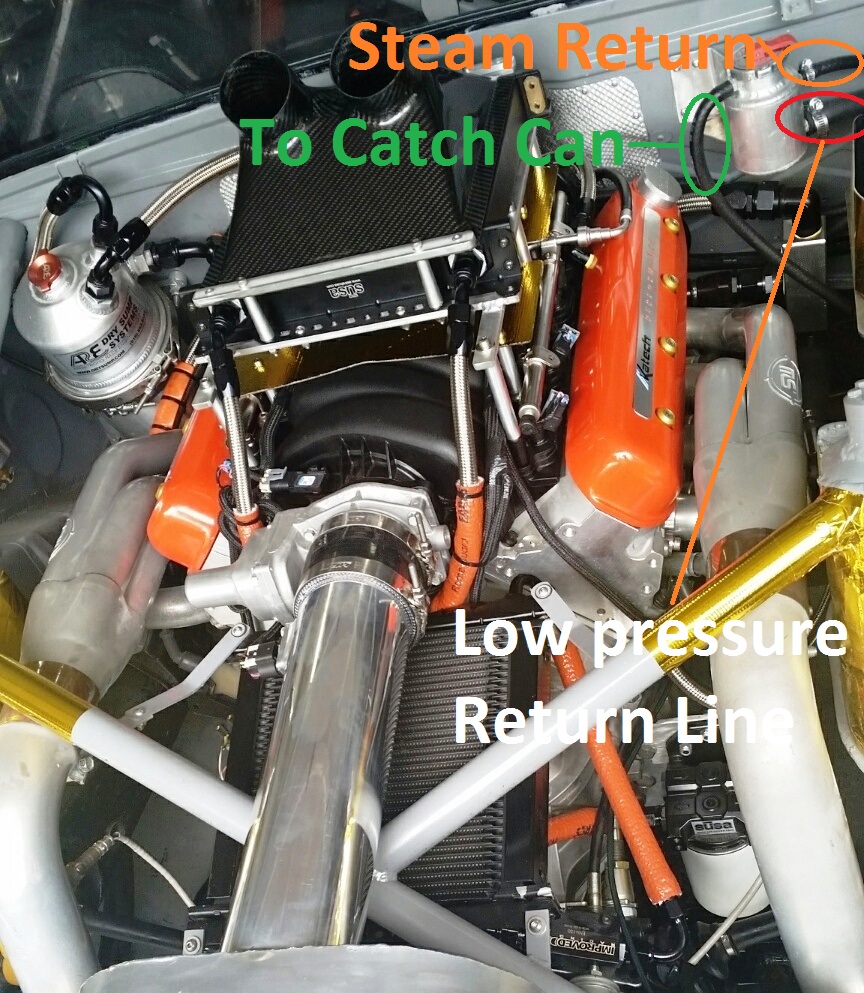

Chris914n6   Confuchris say "Eureka you got it all wrong...   Jul 30 2016, 12:56 AM
Reverend Troublemaker   This is fairly easy to follow - your engine doesn...   Jul 30 2016, 07:26 AM
Reverend Troublemaker   This is from an old Renegade diagram but the basic...   Jul 30 2016, 07:26 AM

Chris914n6   MR2 system. MORE PICS http://www.914world.com/bbs...   Aug 13 2016, 05:22 PM
