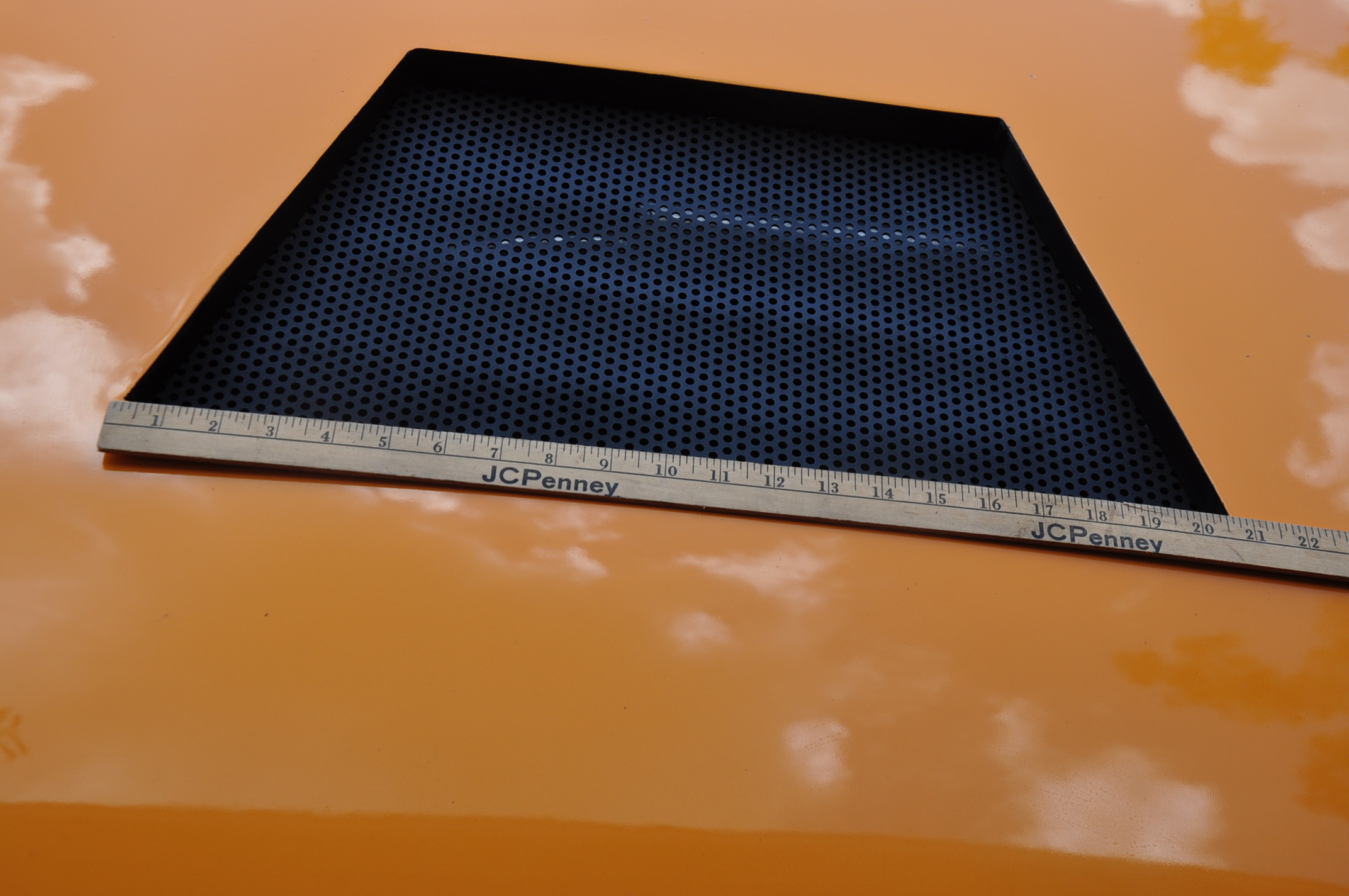

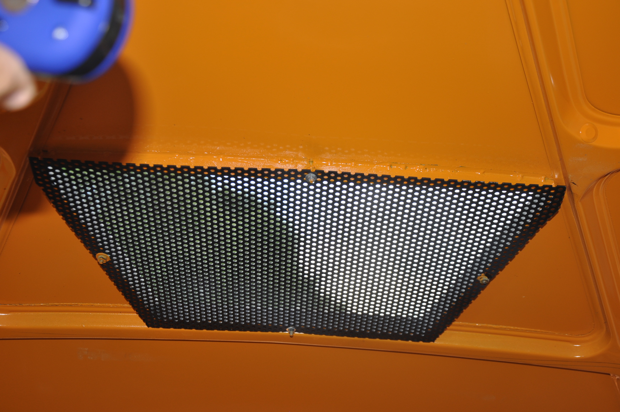

Hi
The puke tank is pressurized and since being higher than the block and radiator it is also where I fill the system, the radiator is a no fill type (no cap) and has a bleed petcock. I bleed the radiator when first filling and keep my tank about half full. It
seems to self bleed. Some of the newer fords have a similar system with a plastic
pressurized puke tank.
And a pic or 2 for Chris. (sorry for the hijack)
My last v8 car had the fender wells cut-out and while it worked, I think this does a better job with no weakening from the cut-outs and no hot air on your brakes.
I cut the hole in the hood with my 4" grinder (cut-off wheel). I framed it in underneath with thin 1" flat bar tacked in and 4 studs to hold the perforated aluminum panel in.
Bob
