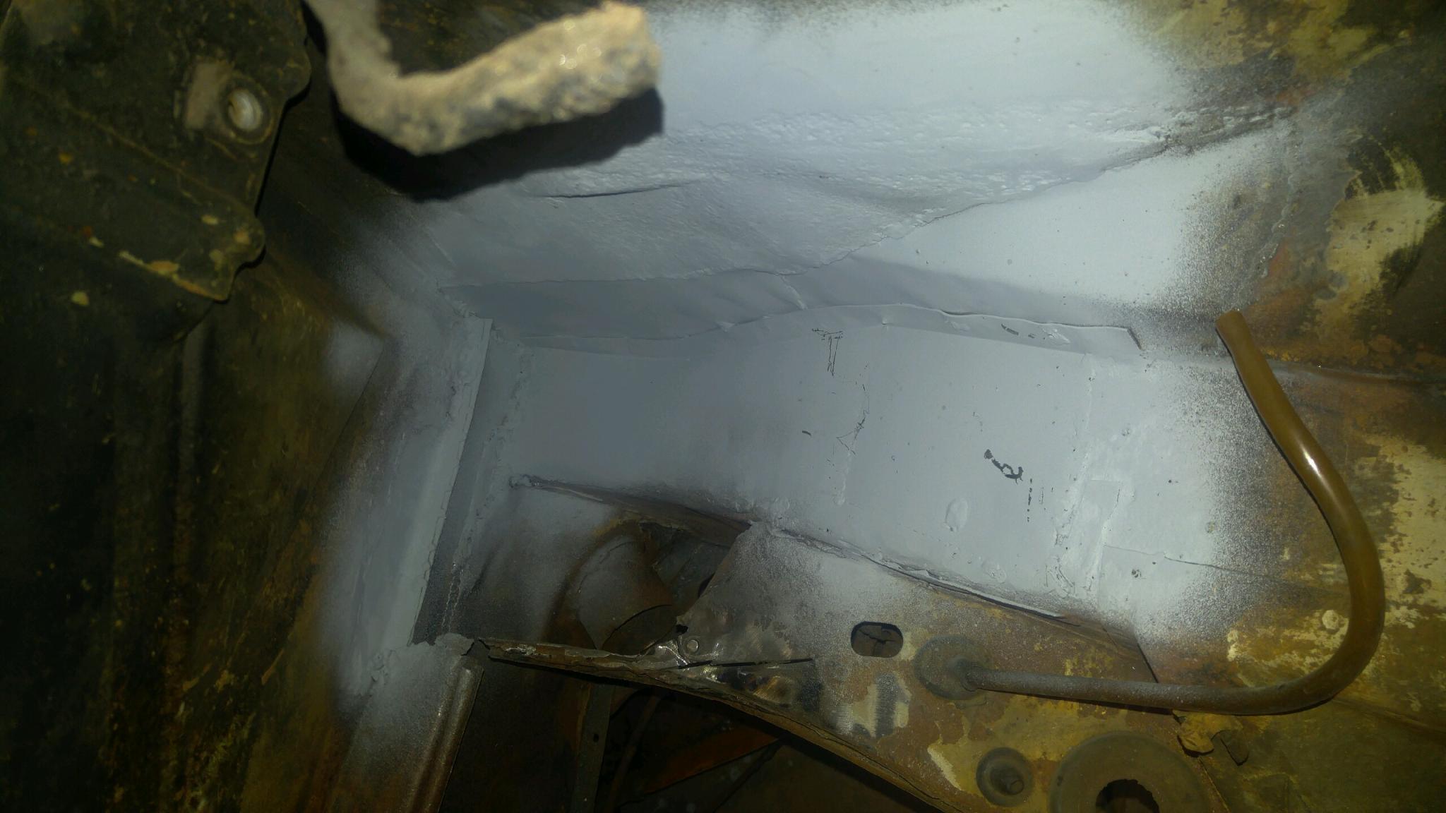

He'll hole done, just sprayed it with cold galvinizing to protect the bare metal. I have to check for pin holes and then decide if I am going to fab the engine shelf. I have been fabbing everything to this point but that piece looks pretty labor intense but not that I am being paid by the hour lolAttached Image
