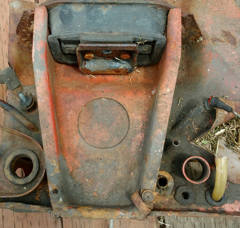

Stupid me I had you original layed out on my firewall for height etc and I wirebrushed the marks off headbang.gif .
The factory piece sits on the bottom pinch weld...comparing the one you made and sent me to the OG one your need to be 1.5mm above the pinch weld..

QUOTE(sixnotfour @ Jul 31 2016, 06:48 AM) *
Appears to be spot-welded directly to the body ...wonder in how many places,mines a copy just like the on shown but is plug welded and the round cutout has been welded also.
Great pic thanks.
