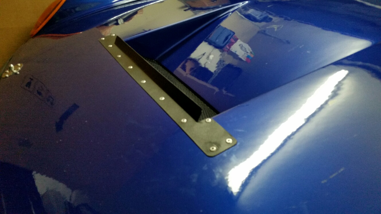

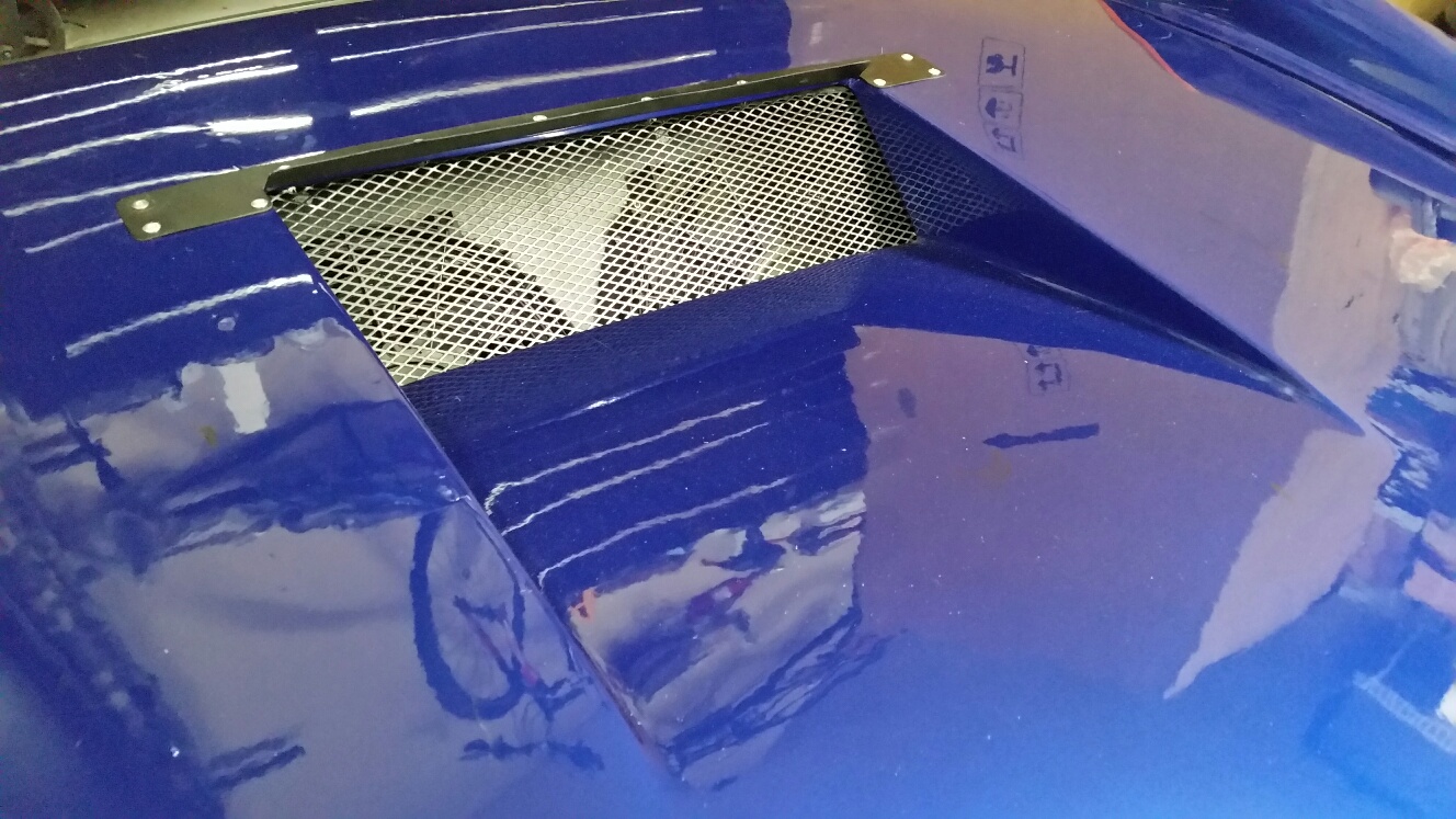

BIGKAT_83   I cut a spare hood for a 2012 ford GT 500 hood ven...   Jul 30 2016, 02:10 PM
cali914   I cut a spare hood for a 2012 ford GT 500 hood ve...   Jul 30 2016, 06:26 PM
Reverend Troublemaker   My car is a race car, more than anything else, and...   Jul 30 2016, 07:29 PM
cali914   My car is a race car, more than anything else, an...   Jul 30 2016, 11:48 PM

914forme   Only thing with hood venting is you can feel the h...   Jul 31 2016, 02:25 PM
Reverend Troublemaker   That hasn't been my experience at all...my foo...   Jul 31 2016, 02:32 PM
Andyrew   Its been my experience that you can feel the heat....   Jul 31 2016, 02:53 PM
