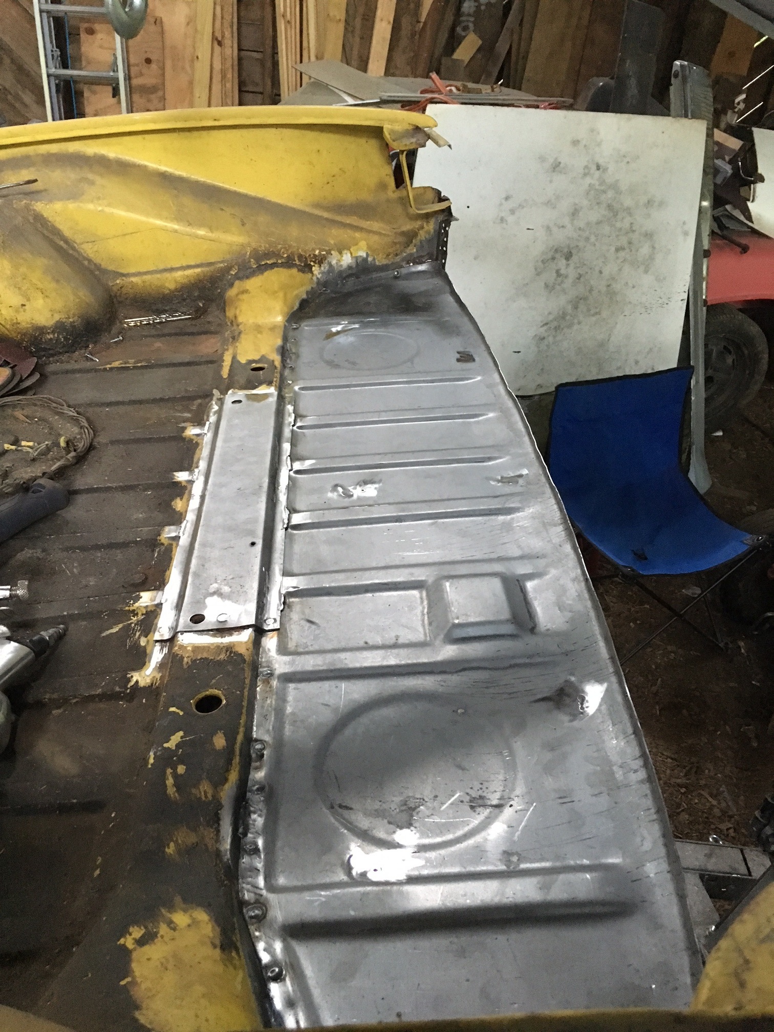

dlee6204   Started on the floorpan. I first had to trim my f...   Jun 26 2016, 02:38 PM
dlee6204   And floor pan is welded in. I still have to do al...   Jun 26 2016, 02:41 PM

dlee6204   I reached a milestone tonight and finished all wel...   Jul 21 2016, 06:15 PM

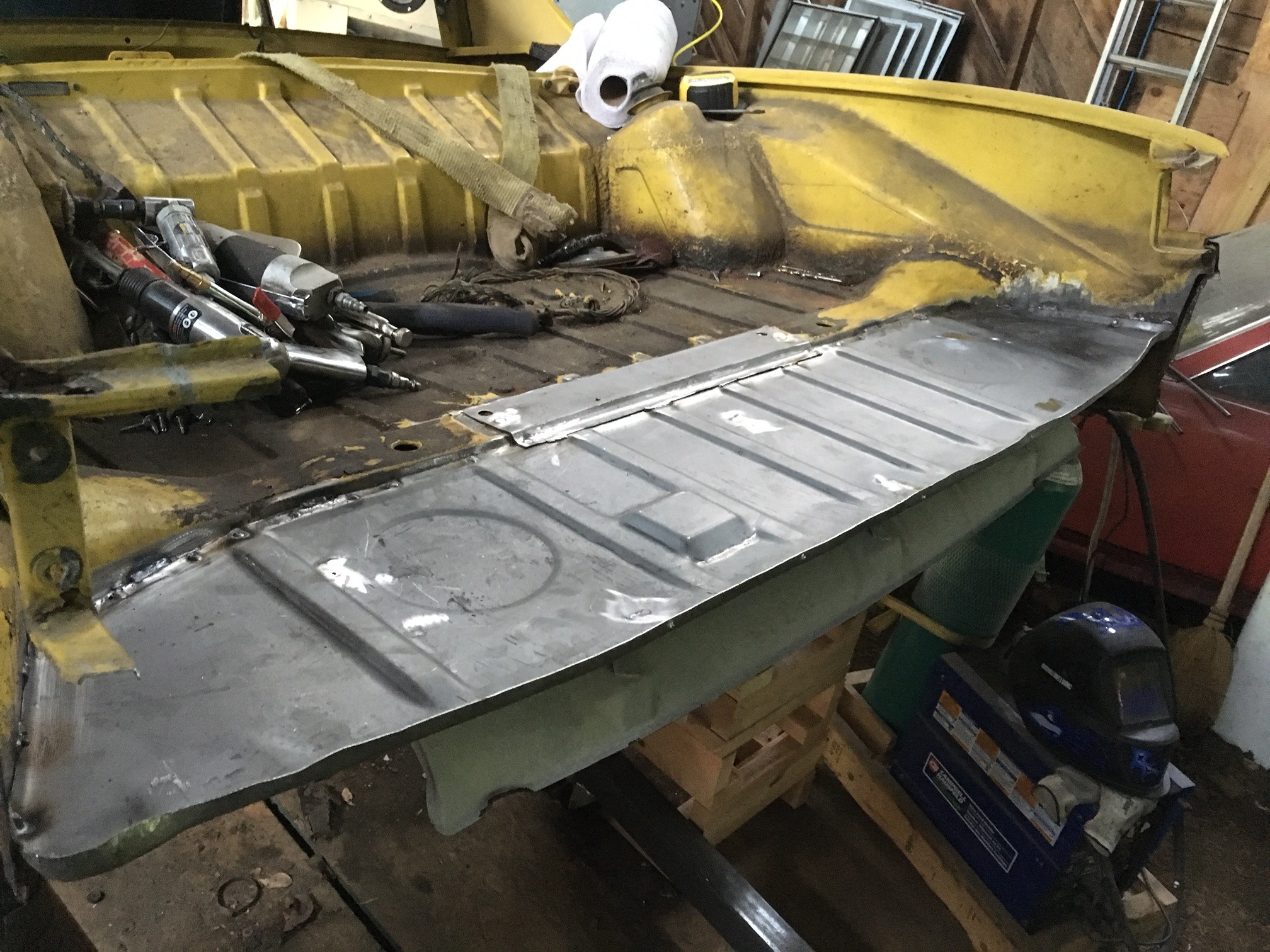

dlee6204   Got the rear trunk, reinforcement, and heat shield...   Jul 30 2016, 07:38 PM

dlee6204   Got the rear panel welded in.   Jul 31 2016, 12:58 PM
dlee6204   Also got the driver's side sail panel, door ja...   Jul 31 2016, 01:01 PM
