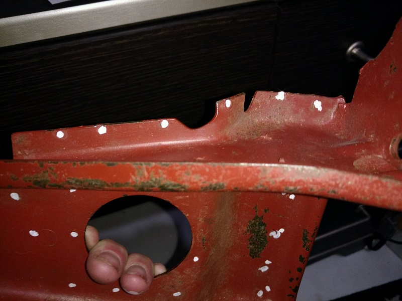

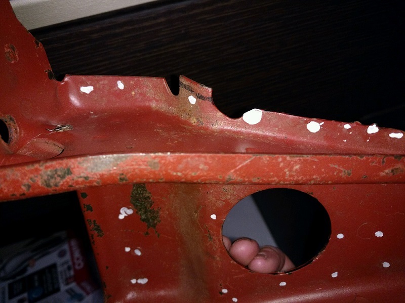

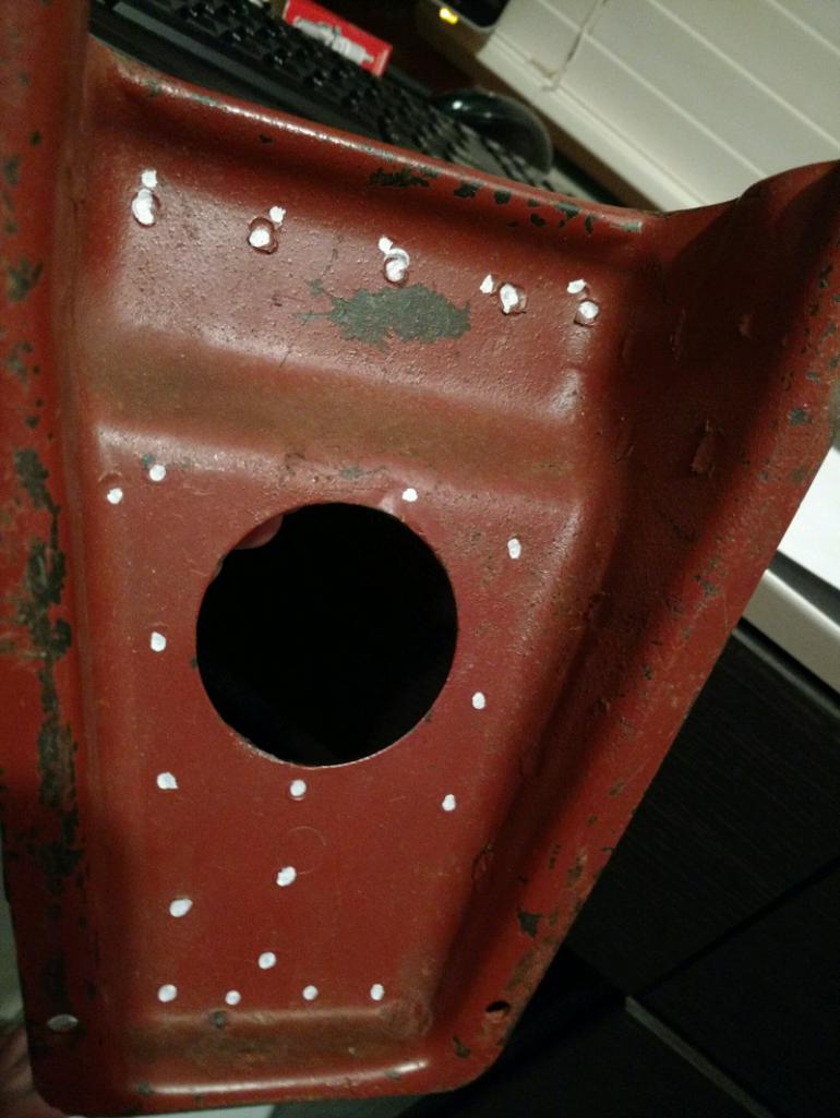

Appears to be spot-welded directly to the body ...wonder in how many places,mines a copy just like the on shown but is plug welded and the round cutout has been welded also.
approx. 40 spot welds
