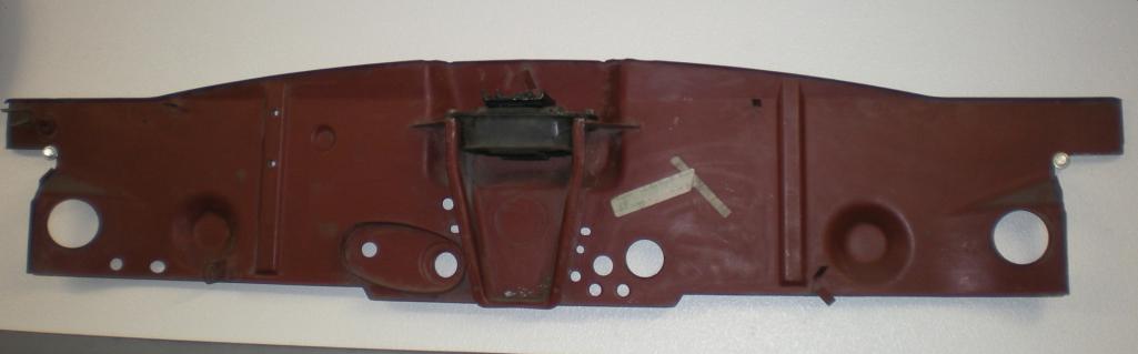

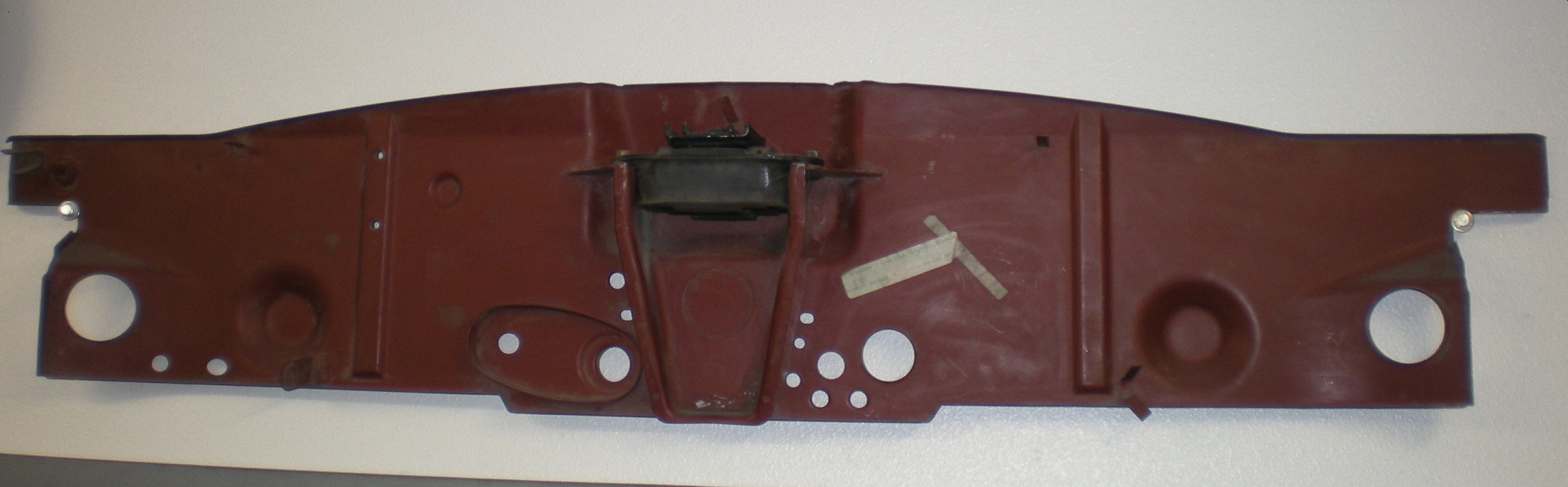

mb911   He'll hole done, just sprayed it with cold gal...   Jul 30 2016, 12:03 PM
sixnotfour   Got my OG plus a nice spare returned Thanks :bee...   Jul 30 2016, 12:11 PM
mb911   Great news and thank you for lending it to me.. St...   Jul 30 2016, 12:20 PM
sixnotfour   Great news and thank you for lending it to me.. S...   Jul 30 2016, 12:30 PM
rhodyguy   The red one is VERY funny.   Jul 30 2016, 12:30 PM
mb911   The best part is I have a fixture to convert the 9...   Jul 30 2016, 12:46 PM
sixnotfour   The factory piece sits on the bottom pinch weld....   Jul 30 2016, 12:48 PM

raynekat   Ben: Wonder if you can fab up the upper and lower...   Jul 30 2016, 08:20 PM
mb911   Ben: Wonder if you can fab up the upper and lowe...   Jul 31 2016, 05:27 AM
sixnotfour   approx. 40 spot welds   Jul 31 2016, 01:53 AM
sixnotfour   :beer1:   Jul 31 2016, 02:05 AM
sixnotfour   here is a version of the nut plate made the hard w...   Jul 31 2016, 02:29 AM
