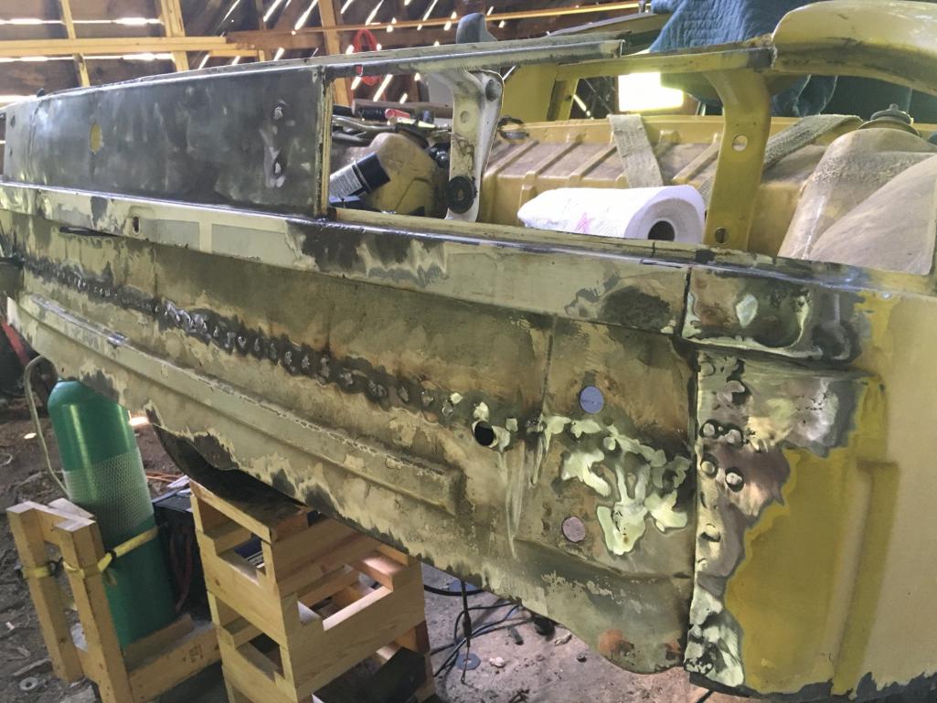

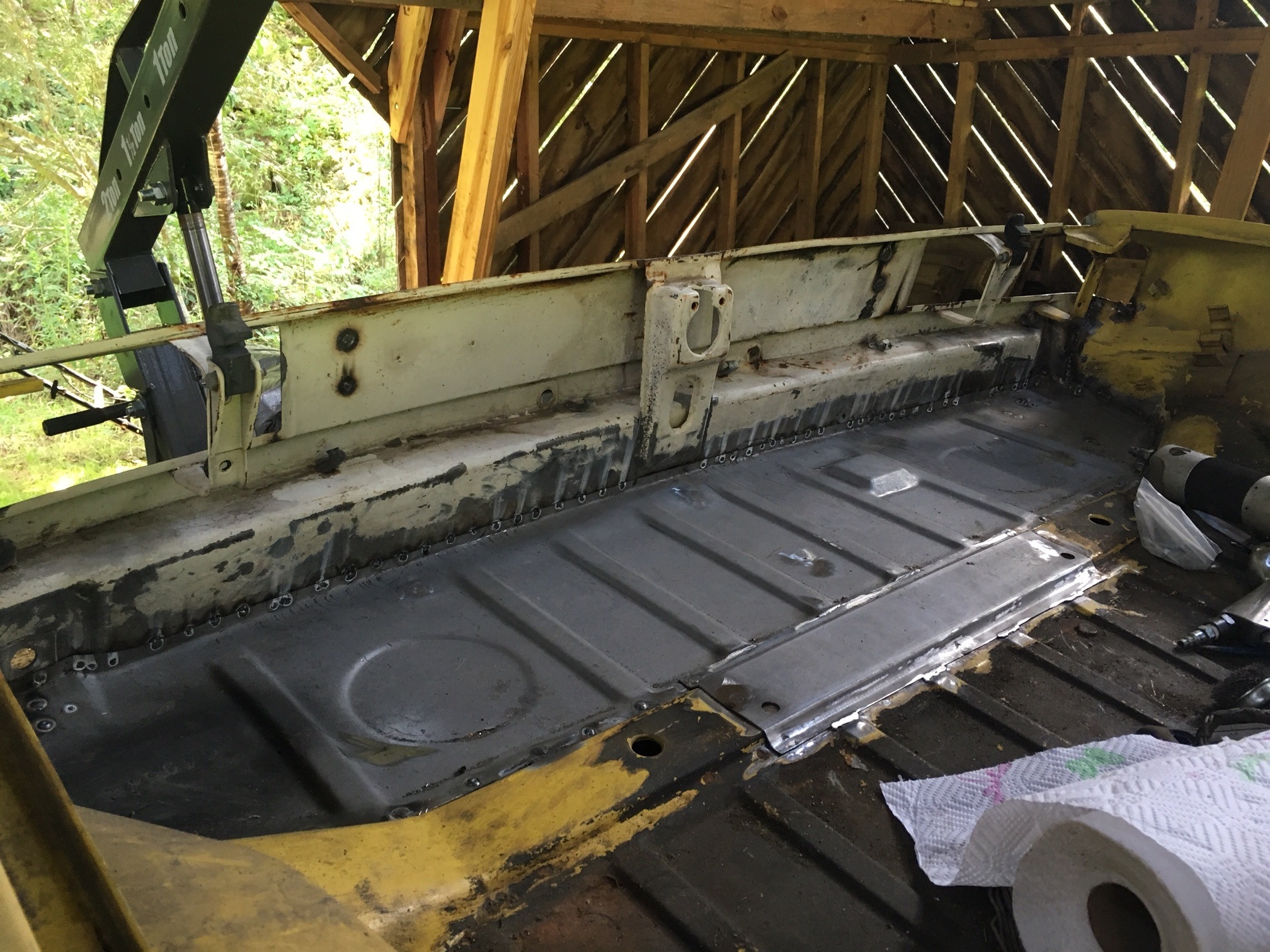

dlee6204   Got the rear trunk, reinforcement, and heat shield...   Jul 30 2016, 07:38 PM
dlee6204   This build has become a freight train rolling uns...   Jul 30 2016, 07:41 PM
raynekat   Doug Dude.....you are a one man wrecking crew....i...   Jul 30 2016, 08:07 PM
dlee6204   Got the rear panel welded in.   Jul 31 2016, 12:58 PM
dlee6204   Also got the driver's side sail panel, door ja...   Jul 31 2016, 01:01 PM
