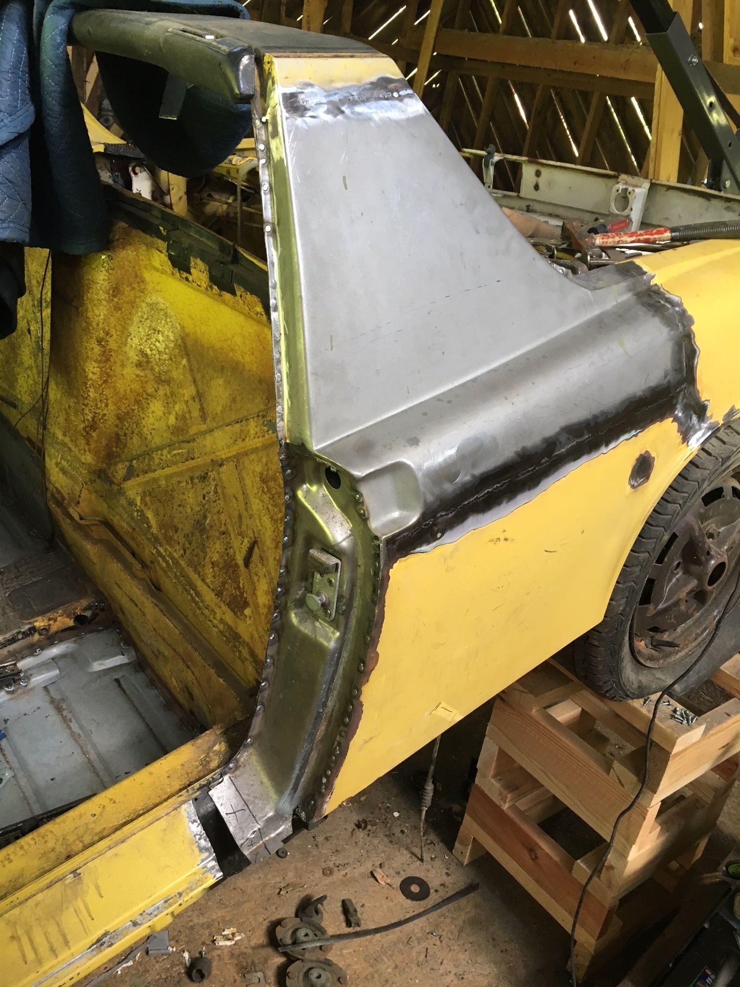

Also got the driver's side sail panel, door jamb, and rear quarter welded on. Still have some work to do where the door jamb meets the sill. Unfortunately I'm going to run out of welding gas soon so I have to get a new bottle before more progress can be made.
