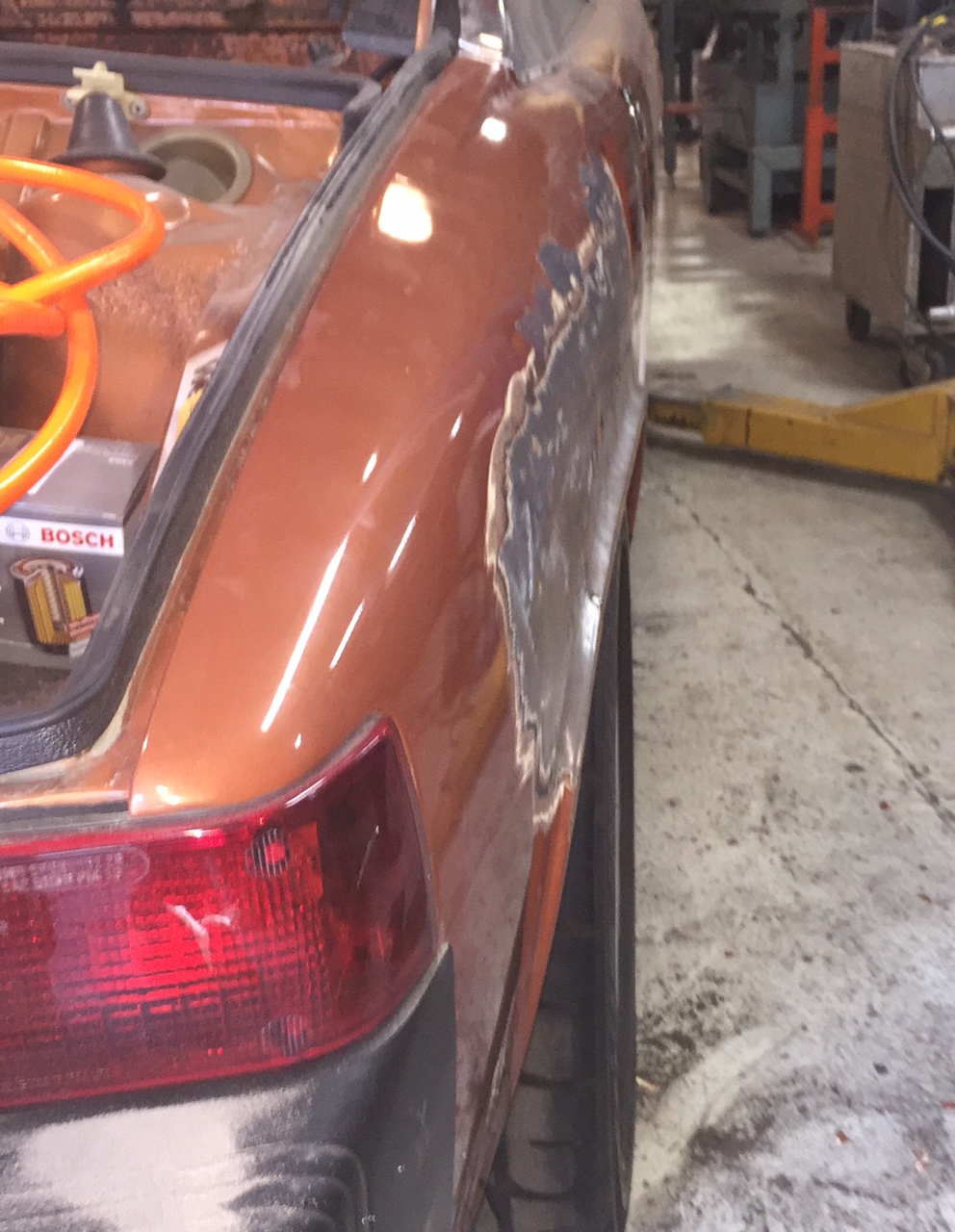

Good news to report! Here are some photos that Chris just sent- try had a lot of work to do in the rear fenders- the lips were bent badly and creases on the fender from a poor attempt to roll them- then they rubbed and caused paint blistering- the 7" Fuchs didn't fit, but they are staying in the car- so Chris's guys were able to carefully pull them out about 3/4", and replace the whole lip from a donor and in the end you can see the view from behind the profile looks perfect and I think once primed and repainted you will not be able to even see there was work done! - way better in my opinion than putting whole flares on the car- I wanted the stock look and lip, just enough room for the wheels and tires.
Awesome work Chris!
(IMG:style_emoticons/default/smash.gif) (IMG:style_emoticons/default/welder.gif) (IMG:style_emoticons/default/welder.gif)
Left side is being done today .-!already done are the Jack points and longs- I will post more pictures of that work when I get it from Chris- there maybe some on his Facebook page-
The last leg of repair is the drivers floor with new cross member and repair to pedal area- I didn't know existed but Chris did so his guys are taking care of it.
Progress!!!!
