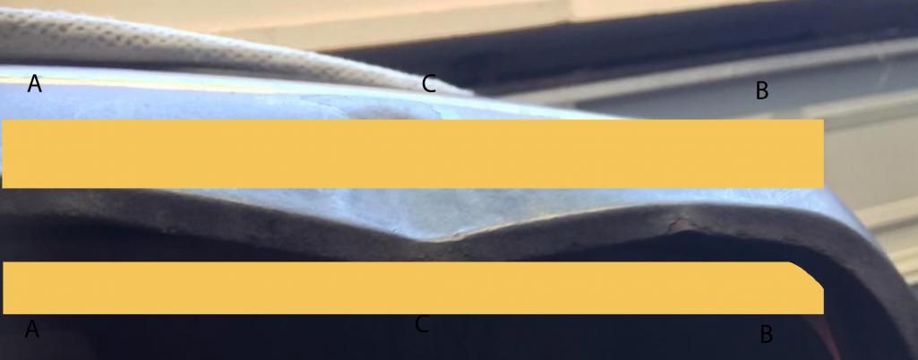

so here's my question for this thread:
my rear valence has one 'big' dent in it and couple small wrinkles in the bottom 1/4" or so 'return' flange that defines the bottom edge
pics following
having never done any kind of body work before this seems fairly straight forward to repair
what are the minimal tools required?
what kind of results could reasonably be expected?
could I (easily)screw it up beyond repair?
thanks for any comments or suggestions
cjl
jacksun
post Aug 4 2016, 04:46 AM
Posts: 236
Joined: 8-August 13
From: mi
Member No.: 16,224
how about using two 2x6's
place wood clamps at points A and B and place the the whole thing
in your bench vise at point C tighten until you get the bottom line
straight. buy the body work hammers from harbor freight, relatively cheap.
and use them for the final work... U tube for tips on hammering.
the part in the middle will most likely be stretched? so you might
have to do some metal shrinking.
