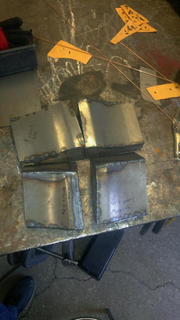

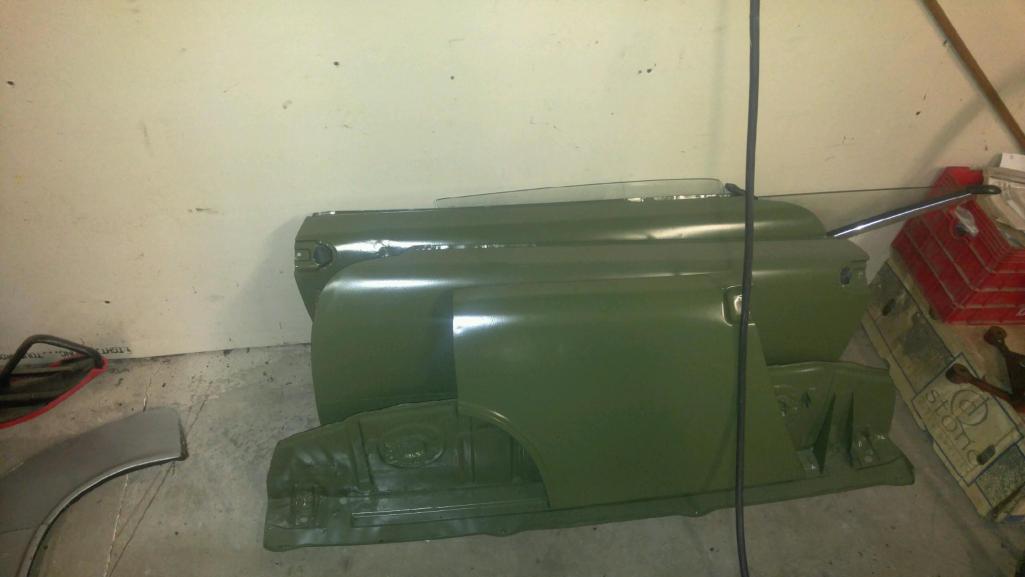

A few update pictures. I have a pile of sand blasted and aviation epoxy primed parts for the car now done. Also a student and I are working making the flares rockers out of steel. That part is hard for me as it only takes me a few minutes but the students much longer to make parts but they really learn allot about fabrication when they start building these types of things Attached Image Attached Image
