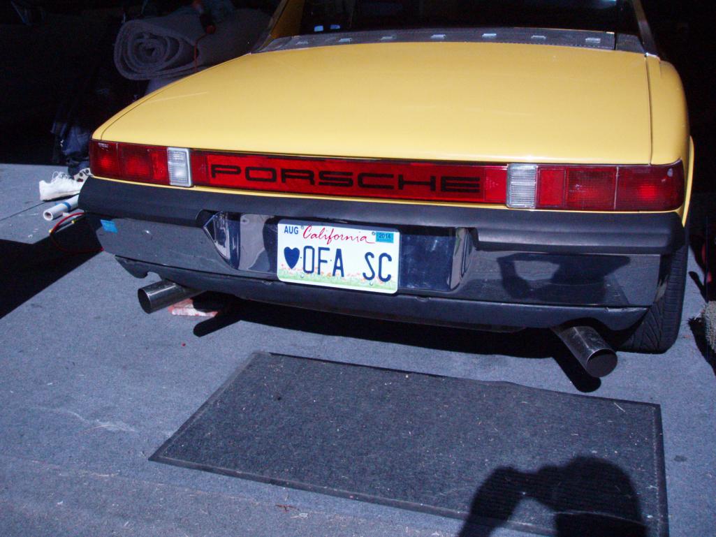

You could go dual exhaust!!!! (IMG:style_emoticons/default/beerchug.gif)
