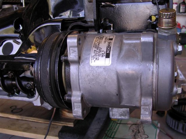

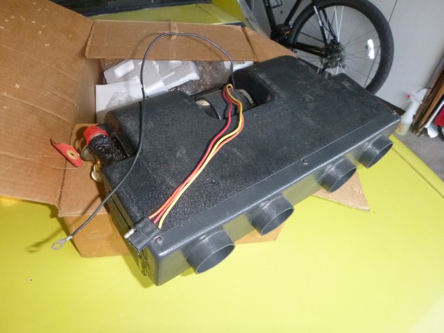

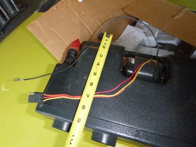

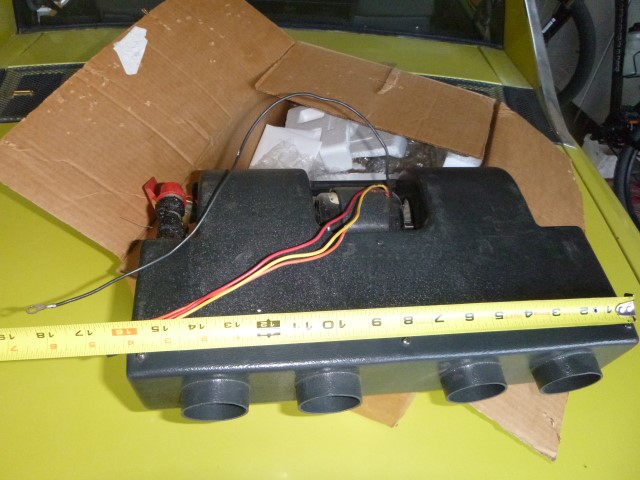

My car came with a/c and I replaced the compressor with a rotary Sanden. I built a frame around the condensor with 1/2" tubing and expanded metal mesh to clean up the installation. My evaporator could be used but I have been trying to figure out something that looks better. I bought the unit in the photos below thinking I could run hoses to the factory vents. The problem is that even as shallow as the evaporator is it's pretty impossible to hide it. If you try to mount it in the center of the dash the u-joint for the steering is in the way. The factory aftermarket unit is offset with the motor on the passenger side so that it clears the u-joint.

Hi Mark,
Would the entire unit fit on the passenger side and allow a hose to be run across to the driver side?
By your measurements it should fit—just hang down about an inch and a half below (but behind) the lower dashpad.
Oldair has another version of that unit with two vents in the front and two on the sides.
