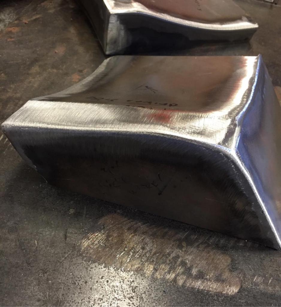

mb911   Been up to some more work. I have the rear ...   Jul 19 2016, 04:37 PM
raynekat   Been up to some more work. I have the rear su...   Jul 19 2016, 05:23 PM
mb911   Been up to some more work. I have the rear s...   Jul 19 2016, 05:31 PM
396   Your reproduction of the factory bulkhead mount is...   Jul 19 2016, 04:53 PM
mb911   Your reproduction of the factory bulkhead mount i...   Jul 19 2016, 05:25 PM
mb911   Here is the engine side before I finished and powd...   Jul 19 2016, 05:30 PM

mb911   Finished the 3.. Powdercoated to prevent rustin...   Jul 25 2016, 12:45 PM
