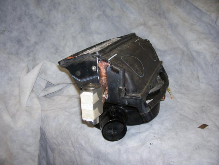

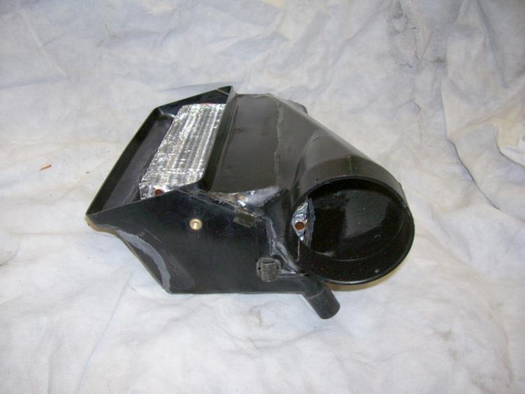

I found the pictures that Jerry West sent to me of his modified air box he used! (IMG:style_emoticons/default/biggrin.gif)
Looks like he grafted in some 4x10x6" endboot used for HVAC duct work.

QUOTE(timothy_nd28 @ Aug 5 2016, 02:51 PM) *
Thank you for the pics, these will help a lot. I have tried to get a hold of Jerry West, but had no luck. He did the AC system on the 914-6 from Florida.

timothy_nd28   Notice the thermostatic expansion valve (TXV) hang...   Aug 5 2016, 05:40 PM
Mowog4   Notice the thermostatic expansion valve (TXV) han...   Aug 6 2016, 02:43 PM
