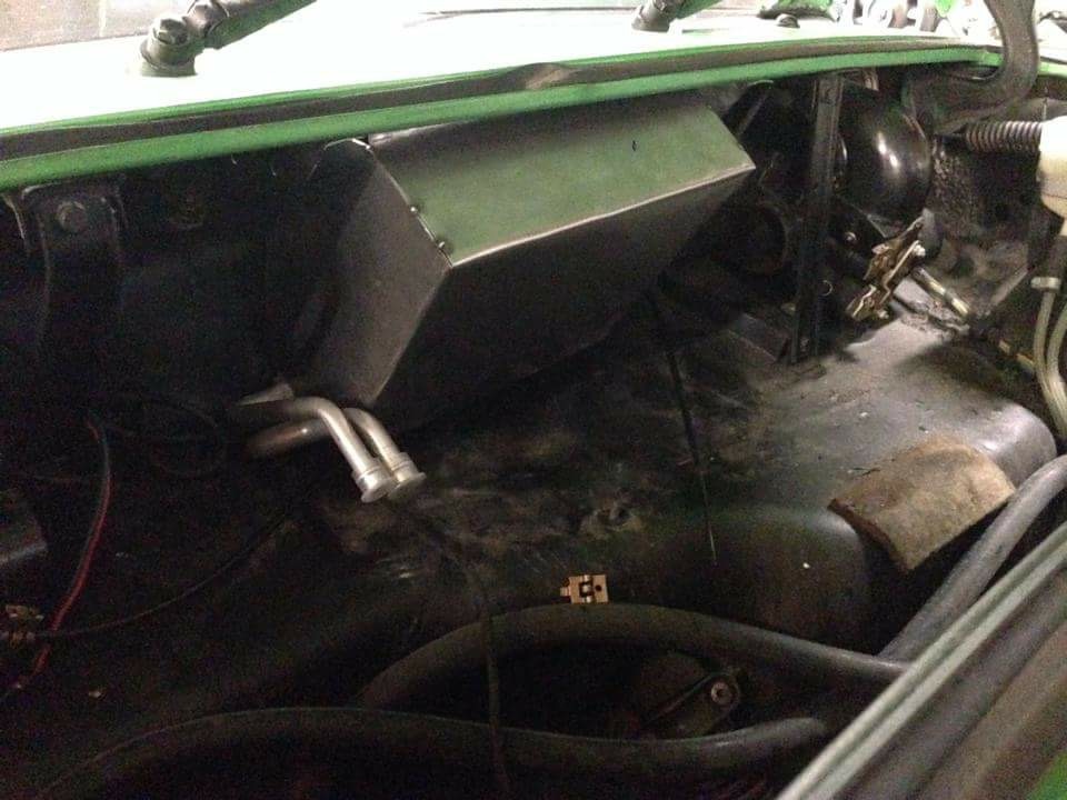

timothy_nd28   I found the pictures that Jerry West sent to me of...   Aug 5 2016, 04:51 PM
Mowog4   I found the pictures that Jerry West sent to me o...   Aug 5 2016, 05:07 PM
timothy_nd28   Notice the thermostatic expansion valve (TXV) hang...   Aug 5 2016, 05:40 PM
Mowog4   Notice the thermostatic expansion valve (TXV) han...   Aug 6 2016, 02:43 PM
