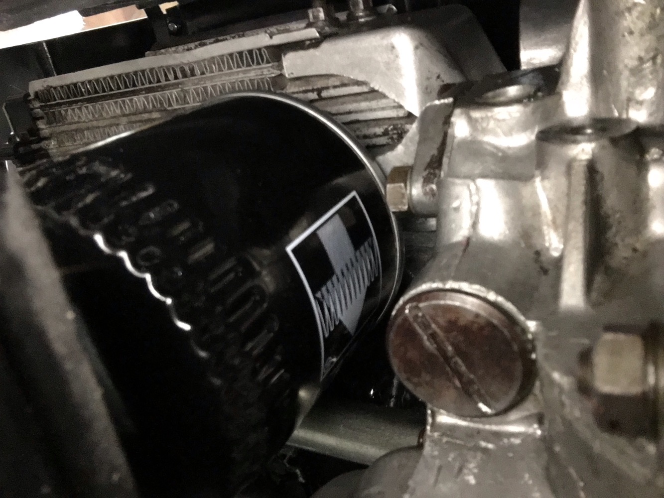

Fresh rebuilt on start up, my first oil filter inflated, then leaked at the seal. Second try, filter massive leak blew the seal out. I have a flow probem. Looking for help. I must be building pressure, just won't leave the filter.

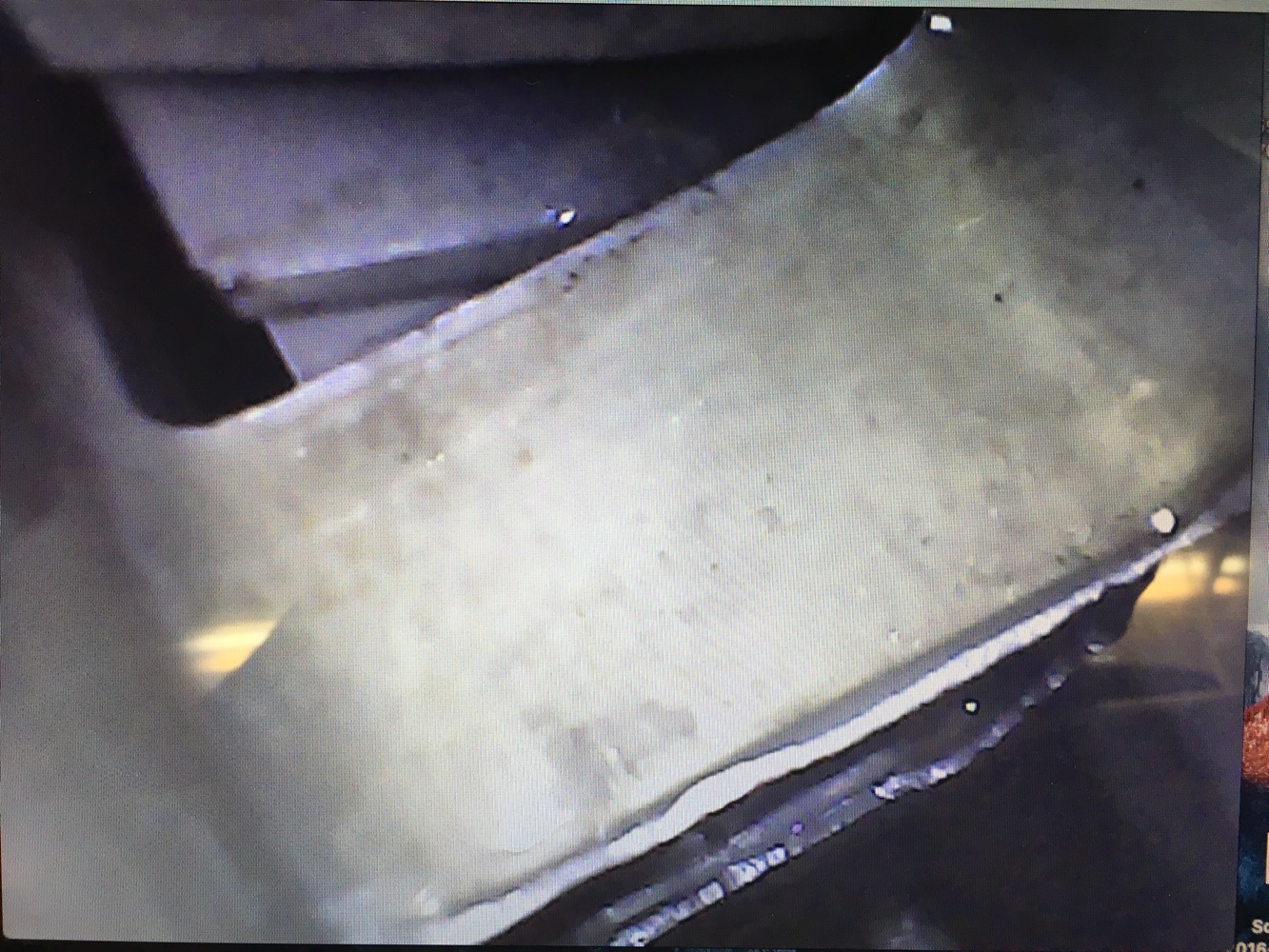

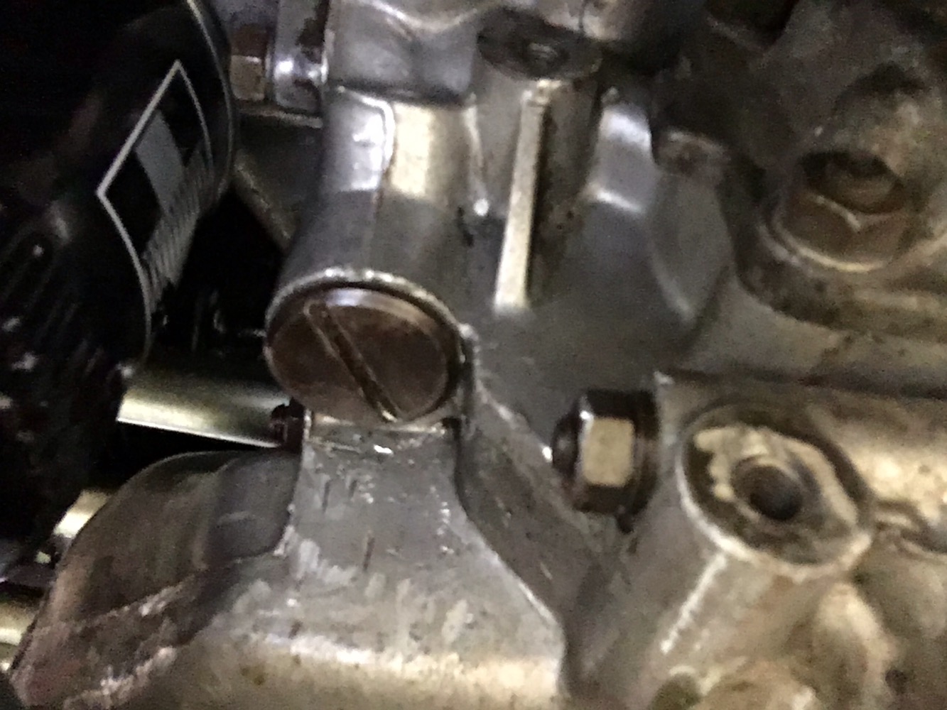

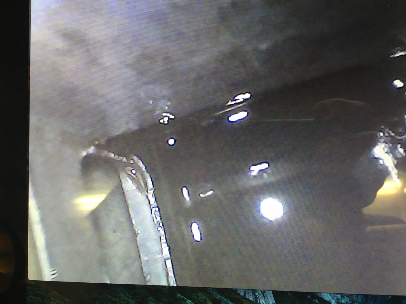

I took a closer look and can't find any other "crap" in the engine. Strainer is clean. Oil changed after lots of rotations, looks clean. I parley cleaned up the surface of the block were the plug goes, but no real damage. Fished around with the bore scope, and things look ok.
The plug had no markings at all when I started. I don't think it was removed when the rebuild was done. This may be why it was so hard to remove, and all the crud only there?? If the case was washed, with the plug left in?
With piston still in.
Piston removed, before cleanup, notice the shine at the top of the bore.
After cleanup, piston surface looks ok,

Mark Henry   First thought is you have a seized oil control pis...   Aug 6 2016, 02:57 PM
Garland   Mark, Thank you I have contacted the member I got...   Aug 6 2016, 03:50 PM

Mark Henry   Was the filter and console on it when you got it? ...   Aug 6 2016, 04:32 PM
Garland   Here we go... Filter was with engine, no bugs :D ...   Aug 6 2016, 04:41 PM

Mark Henry   Big screwdriver, hold it at an angle and to one si...   Aug 7 2016, 08:14 AM
rgalla9146   I'd go with a hand impact. About a $20 ...   Aug 7 2016, 08:47 AM
Garland   :smash: :smash: :smash: not working!   Aug 7 2016, 08:55 AM
Mark Henry   :smash: :smash: :smash: not working! Harde...   Aug 7 2016, 10:33 AM
Garland   Impact seems a bit aggressive, but at this point a...   Aug 7 2016, 09:43 AM
Garland   It's moving, 1/4 turn so far. I had to cut two...   Aug 7 2016, 10:48 AM

Mark Henry   Wow that is one of the worst I've seen...??? ...   Aug 7 2016, 11:28 AM
Garland   Wow that is one of the worst I've seen...??? ...   Aug 7 2016, 12:24 PM
Garland   Me to, here it is! Used a home made slide ham...   Aug 7 2016, 11:56 AM
