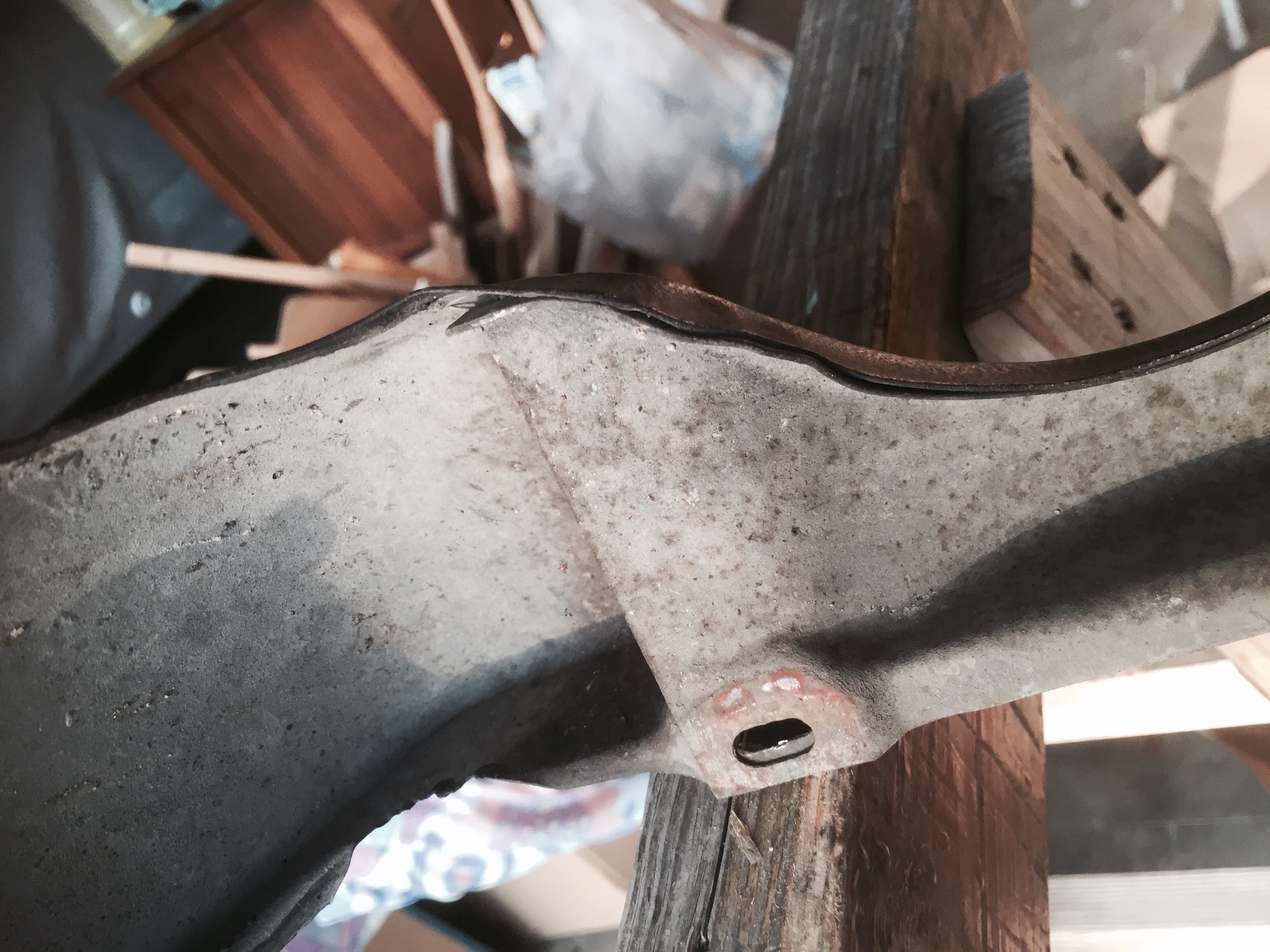

my rear valence has one 'big' dent in it and couple small wrinkles in the bottom 1/4" or so 'return' flange that defines the bottom edge
pics following
having never done any kind of body work before this seems fairly straight forward to repair
what are the minimal tools required?
what kind of results could reasonably be expected?
could I (easily)screw it up beyond repair?
thanks for any comments or suggestions
cjl
theleschyouknow
post Aug 10 2016, 07:41 PM
Posts: 524
Joined: 4-June 13
From: Texas
Member No.: 15,967

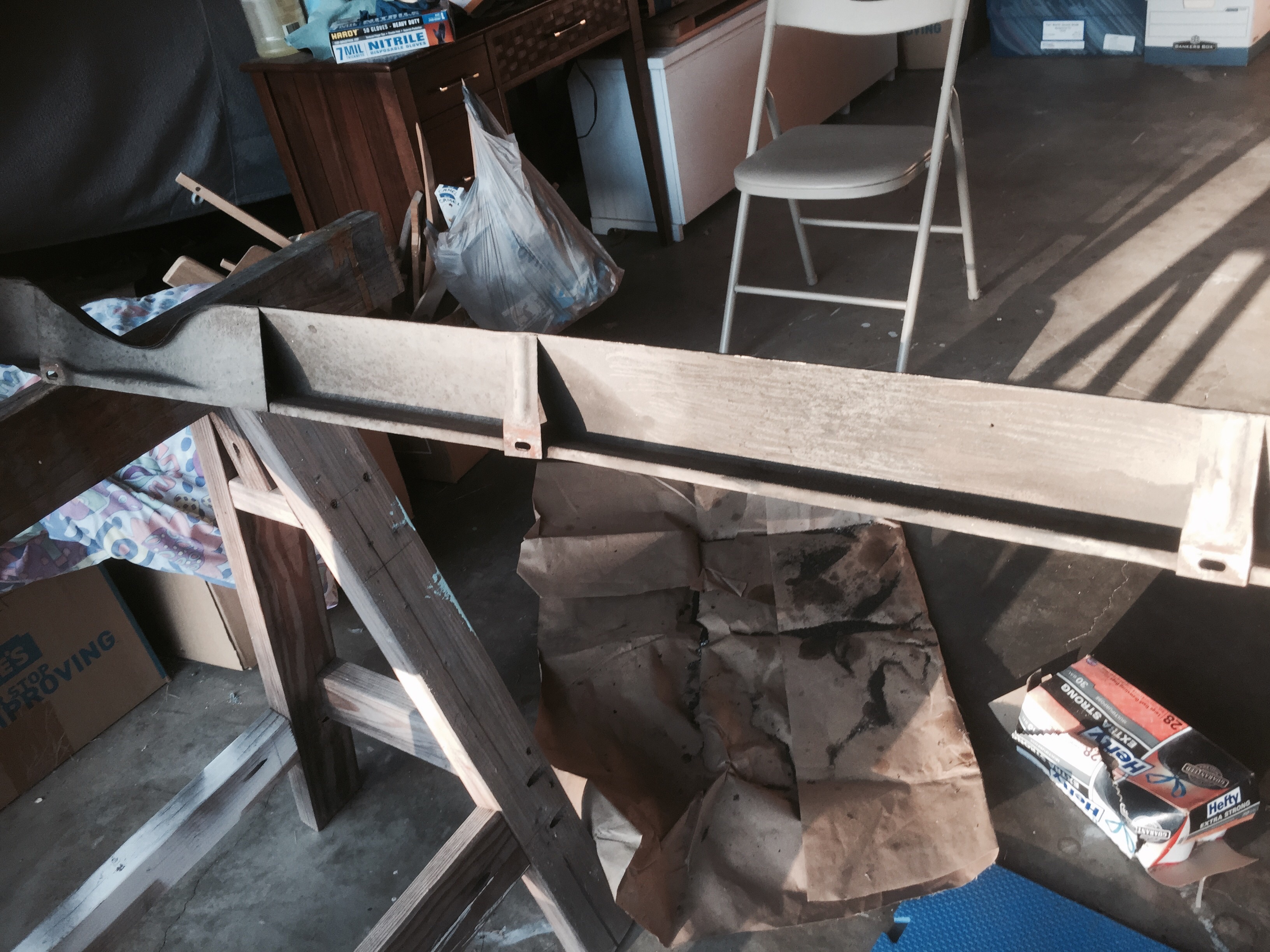

here's a couple pics of what I'm talking about
below are the brackets I'm talking about 2 spaced midway and 1 around the muffler cut-out
below you can see some of the issues I'm talking about around the support brackets I imagine I can help them out with some more patient smacking

zambezi   Are you using a hammer and dolley or just the hamm...   Aug 8 2016, 11:01 AM
theleschyouknow   Are you using a hammer and dolley or just the ham...   Aug 8 2016, 11:48 AM
Darren C   Your doing real well cjl, Very good work! T...   Aug 8 2016, 12:36 PM
theleschyouknow   thanks Darren I was kinda hoping you would chime i...   Aug 8 2016, 05:18 PM
Darren C   I could use some of your weather. Its 8am here, w...   Aug 9 2016, 12:50 AM
porschetub   I could use some of your weather. Don't pl...   Aug 9 2016, 08:36 PM
theleschyouknow   thanks for the support Darren I'll split the d...   Aug 9 2016, 08:16 PM
theleschyouknow   thanks -tub it's getting there :beer2: cjl   Aug 9 2016, 09:37 PM
Darren C   "one question regarding the bottom return fla...   Aug 10 2016, 12:45 AM
theleschyouknow   here's a couple pics of what I'm talking a...   Aug 10 2016, 07:41 PM
theleschyouknow   and below is shot of one of the vertical brackets ...   Aug 10 2016, 07:49 PM
Darren C   Thanks, posting the pictures saves a 1000 words...   Aug 11 2016, 01:36 AM
theleschyouknow   thanks Darren, good advice & good explanation ...   Aug 11 2016, 06:03 PM
