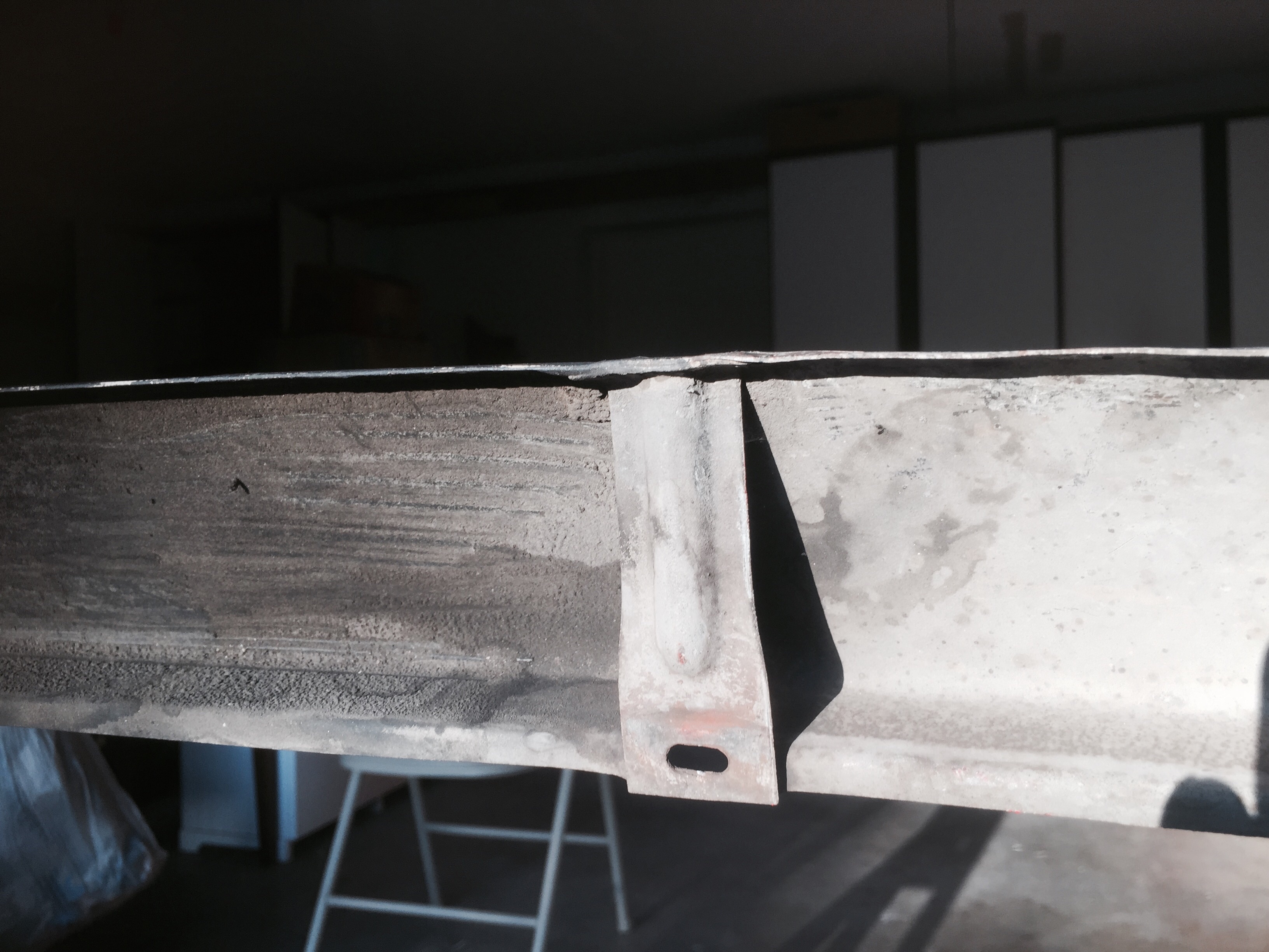

and below is shot of one of the vertical brackets that I've already done some work on but you can still see the bracket doesn't appear to sit true to the line of the valance
let me know what ya think I smacked on it a bit more tonight but just a half hour of work right after the sun went below the trees left me wringing wet -we're supposed to get some temperature relief on the weekend but supposed to be accompanied by rain as well
I like seeing these pics myself, I can see some issues in the pics that are harder to notice staring right at the actual piece
cj

Darren C   "one question regarding the bottom return fla...   Aug 10 2016, 12:45 AM
theleschyouknow   here's a couple pics of what I'm talking a...   Aug 10 2016, 07:41 PM
theleschyouknow   and below is shot of one of the vertical brackets ...   Aug 10 2016, 07:49 PM
Darren C   Thanks, posting the pictures saves a 1000 words...   Aug 11 2016, 01:36 AM
theleschyouknow   thanks Darren, good advice & good explanation ...   Aug 11 2016, 06:03 PM
