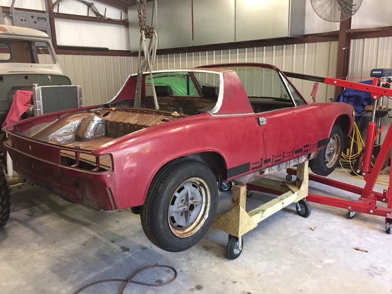

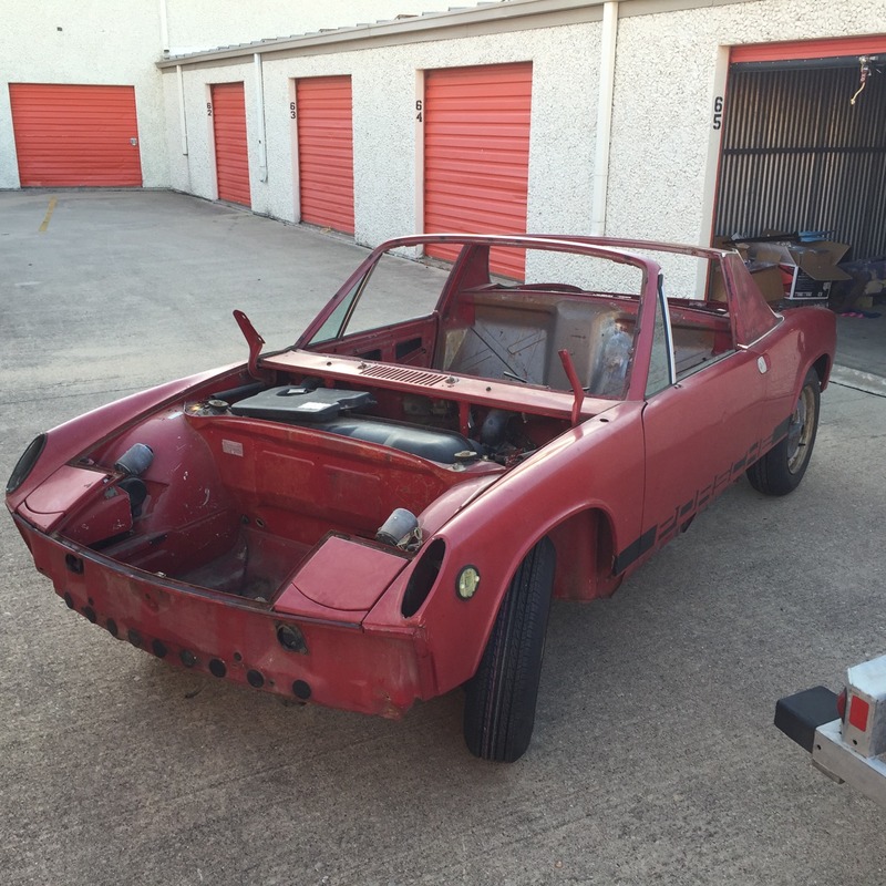

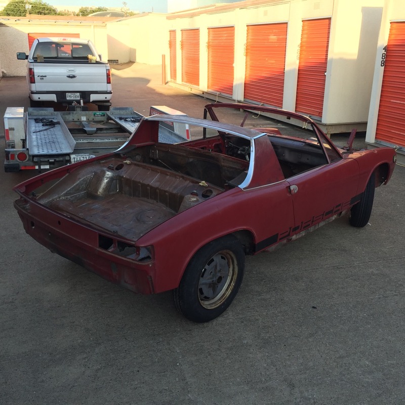

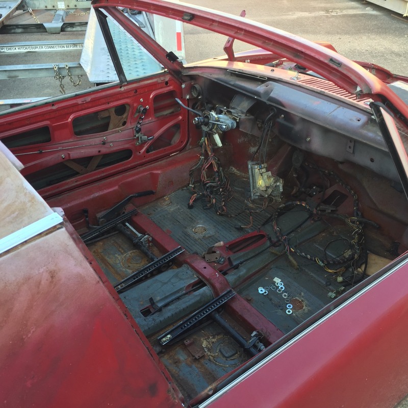

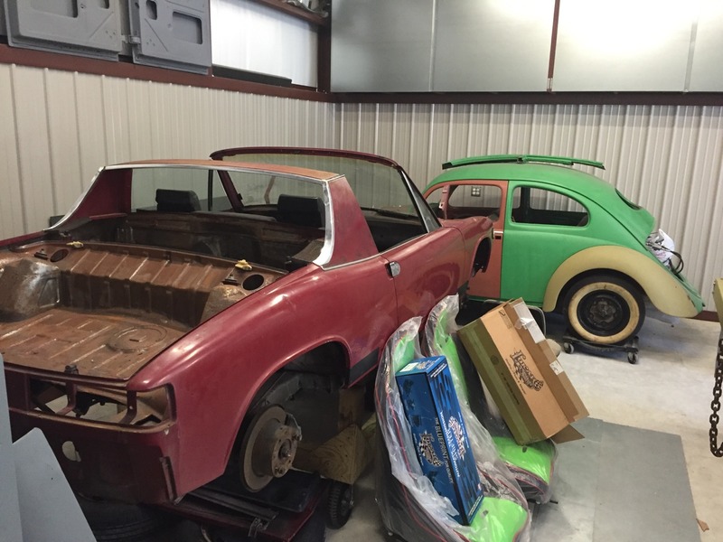

Pulled the 'teener out to load up and move from the storage unit to my uncle's shop. Here are some pics:
(IMG:http://www.914world.com/bbs2/uploads_offsite/i120.photobucket.com-19557-1470935337.1.jpg)
(IMG:http://www.914world.com/bbs2/uploads_offsite/i120.photobucket.com-19557-1470935337.2.jpg)
(IMG:http://www.914world.com/bbs2/uploads_offsite/i120.photobucket.com-19557-1470935337.3.jpg)
(IMG:http://www.914world.com/bbs2/uploads_offsite/i120.photobucket.com-19557-1470935337.4.jpg)

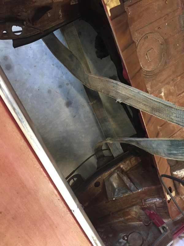

Also lifted the car up and placed on my body stand. The stand itself is sturdy, but the cheesy pneumatic wheels will need to be swapped.
Straps around motor mounts:
(IMG:http://www.914world.com/bbs2/uploads_offsite/i120.photobucket.com-19557-1470935337.5.jpg)
Lifting from front & rear:
(IMG:http://www.914world.com/bbs2/uploads_offsite/i120.photobucket.com-19557-1470935338.6.jpg)
Tucked away next to the '56 oval project (for sale)
(IMG:http://www.914world.com/bbs2/uploads_offsite/i120.photobucket.com-19557-1470935338.7.jpg)
Also, found a "parts car" I am planning to pick up on Saturday. It's a 72 and has 2.0L fuchs, chrome bumpers, some missing interior pieces, transmission, and lots of other goodies. I will probably take patch panels from this car instead of buying new $$ from restoration design.
