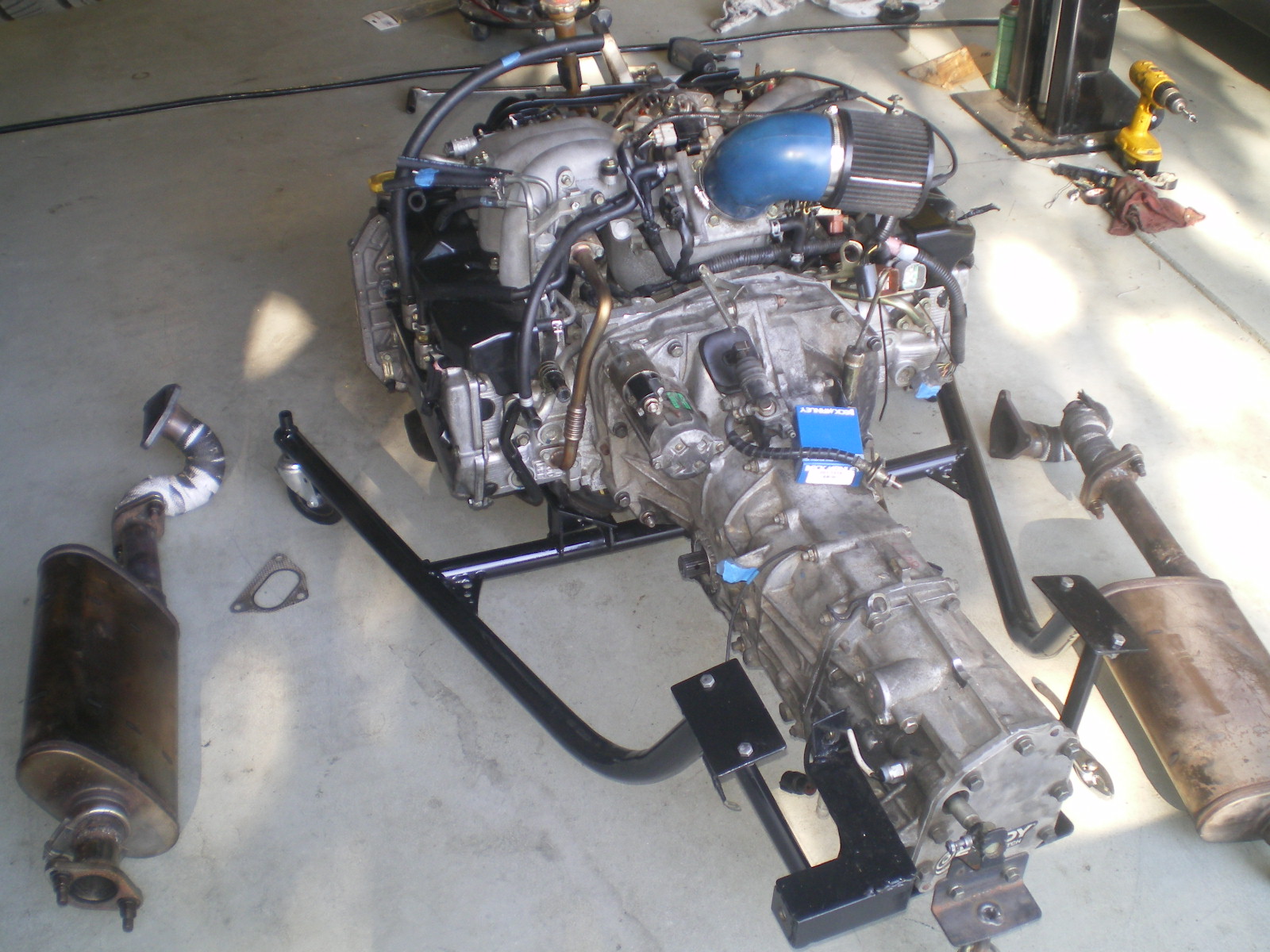

Round 2 - Took time away from the project these past several days to attend to, shall we say, life. No sense in whining about problems, right? With that said I'll move along. The newer engine is in and running but not w/o a hitch or 3. (IMG:style_emoticons/default/confused24.gif) I forgot to release the Subaru "pull type" throw out bearing so I lost a few hours reacquainting myself. (IMG:style_emoticons/default/headbang.gif) . The alternator had a bad bearing so I used the one off the other engine. I used the smaller AC compressor that came with the engine but I will need to change the size of my suction line as well now. And as it turns out, the TPS from either engine works fine although they have different part #'s. (IMG:style_emoticons/default/confused24.gif)
When it first fired off it belched an orange-ish cloud and settled in with a rpm of ~1200. So I switched the TPS back to the one that came with it and tried again. This time the idle was ~2800rpm. (IMG:style_emoticons/default/new_shocked.gif) . After I cleaned out my pants I settled down enough to find that I had not reconnected the TPS plug so the ECU never saw it. After I reconnected the TPS plug the idle returned to 1200rpm so no difference. After 2-3 minutes of idling it began to hunt. Now (IMG:style_emoticons/default/sheeplove.gif) what? (IMG:style_emoticons/default/headbang.gif) I'm hovering over the engine when I felt the tire spin against my leg. Lowered the lift enough for the rear tires to make contact with the concrete and it stopped. My take on this is that I am running the USDM ECU which only support an automatic so the VSS sender on my transmission works BUT it's looking for some torque values that the 5 speed manual trans isn't sending. It compensates by raising the idle a bit when run @ < 10mph. I figured that I'll drive with the high idle until I figure it out. My previous experiences w/ DJet had trained me in the fine art of driving with high idle syndrome. (IMG:style_emoticons/default/av-943.gif) So, I hop in and get about 300 yds down the road and it starts with that hunting (IMG:style_emoticons/default/stromberg.gif) again but this time with vigor. (IMG:style_emoticons/default/WTF.gif) (IMG:style_emoticons/default/ar15.gif) (IMG:style_emoticons/default/headbang.gif) Now I'm ready to kill something. I resigned myself to re-installing good ol' number 1 but decided I'll drive the piss out this thing until I get the other one back together and installed. This is where it gets weird. I've developed a habit of closely monitoring the tach on the upper end so that I can avoid the hard stall that comes at 6600rpm indicated. I say indicated because I am running the VDO Interrogator Tach. The new engine hits 7000rpm indicated before I shift. I didn't want to run past 7000rpm, either. Odd that with the same ECU the new engine rev's higher. (IMG:style_emoticons/default/confused24.gif) This however stumps me. After the 3rd or 4th hard pull the engine stopped hunting and the idle returned to 500-550rpm. For now, I'm going to assume that I had a presence along for the ride and he put a SLITS tune on it's ass. I have no other explanation. (IMG:style_emoticons/default/shades.gif)

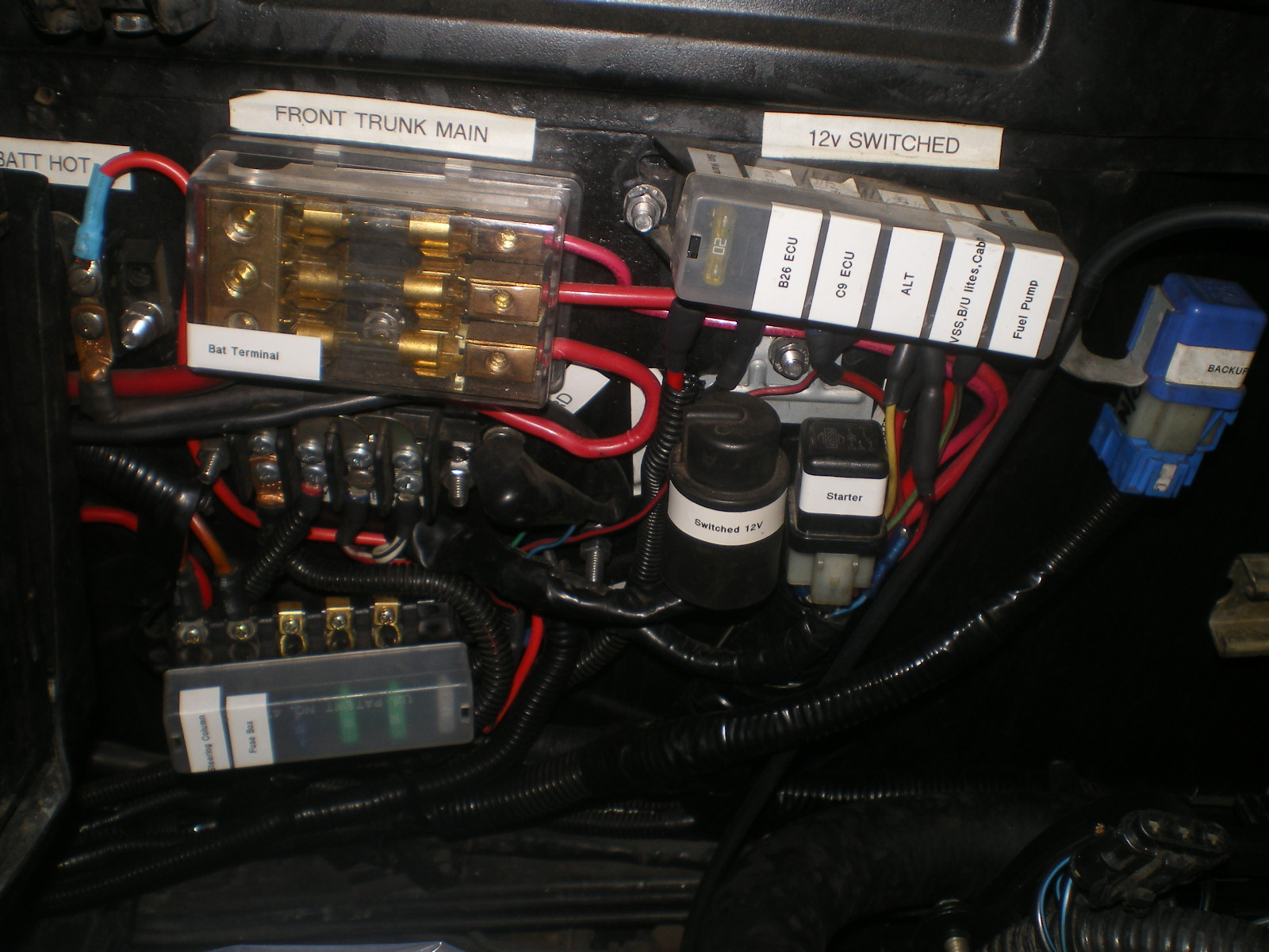

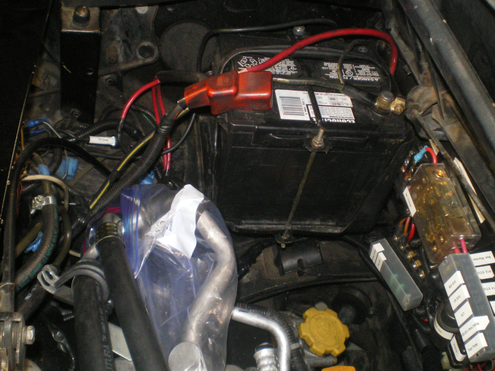

When the engine was out I cleaned up the wiring and labeled everything. I still need to draw a proper schematic that represents the cars current (NPI) wiring layout.
Now that I have the other engine on a stand I'll take my time sealing it up and keep it as a spare.

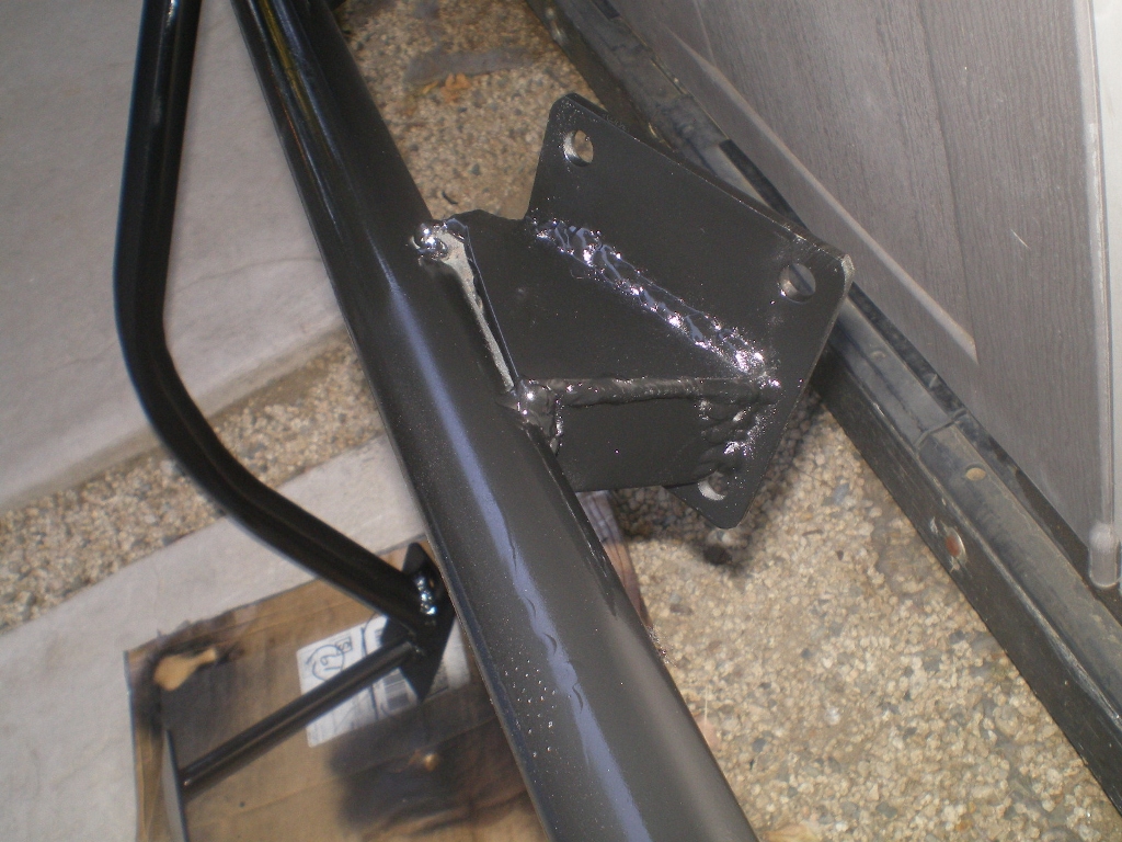

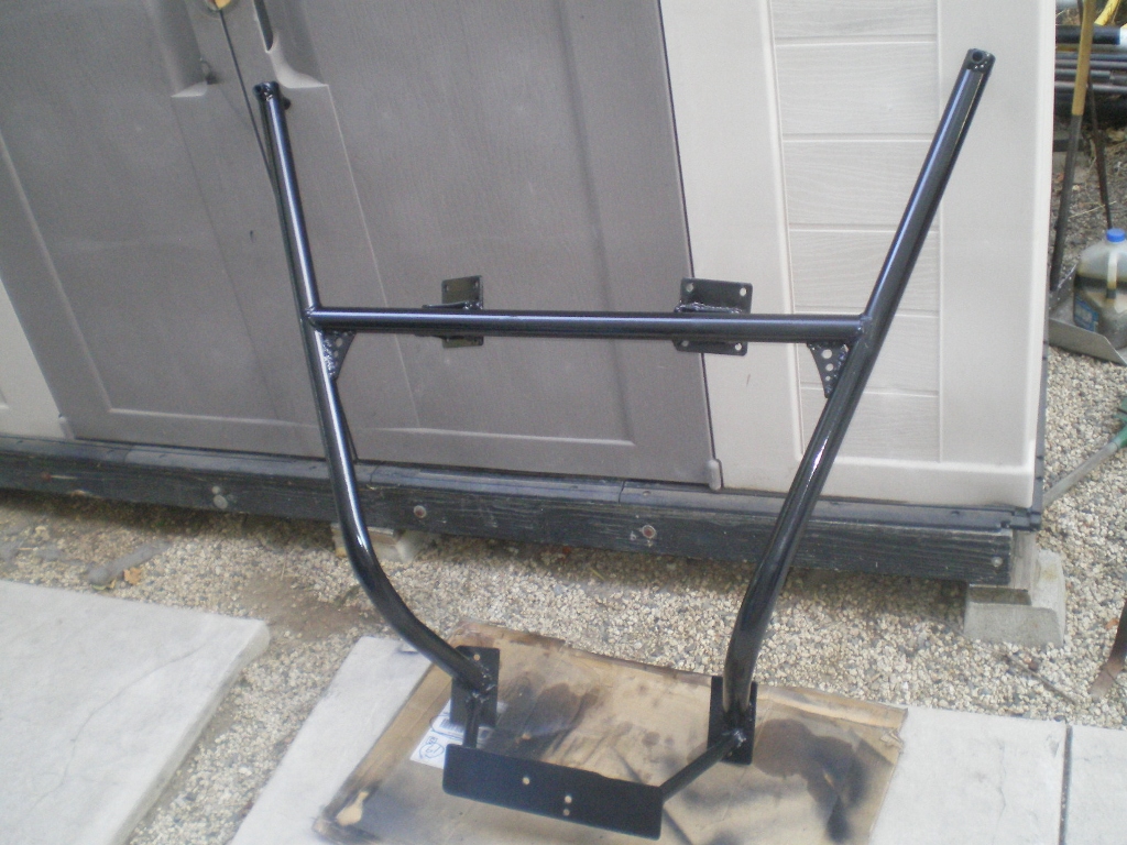

I also took the opportunity to paint my cradle as it had been sporting primer these past two years. I decided to strip it down to bare metal and inspect for cracks before I blindly threw a few coats of paint on it. I used PVC purple primer instead of Magnaflux. It works pretty well, is cheaper and can be used for plumbing chores later. (IMG:style_emoticons/default/beerchug.gif)

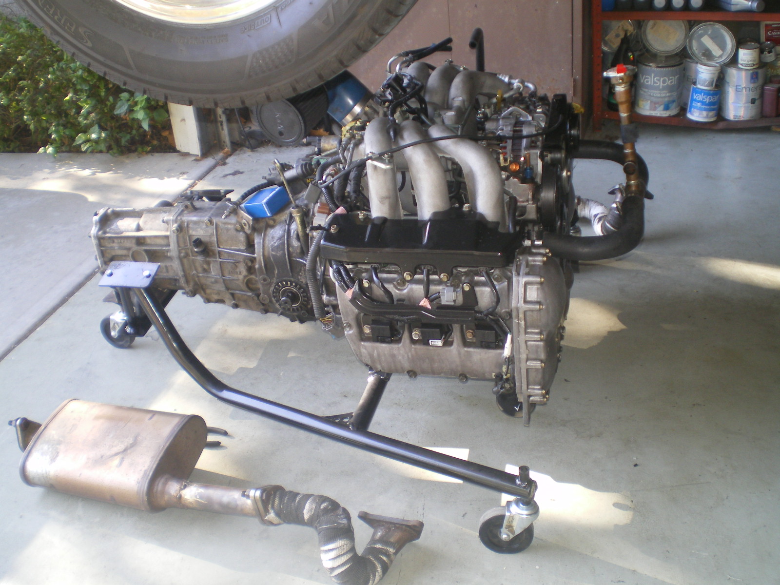

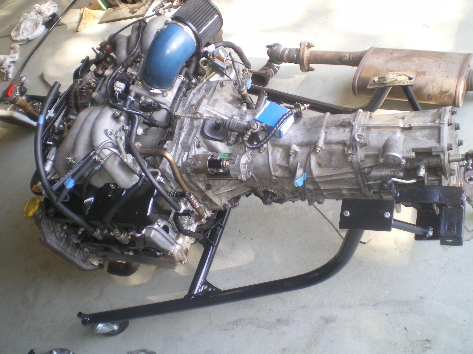

And here sits the newer drive train awaiting it's new home. (IMG:style_emoticons/default/biggrin.gif)
