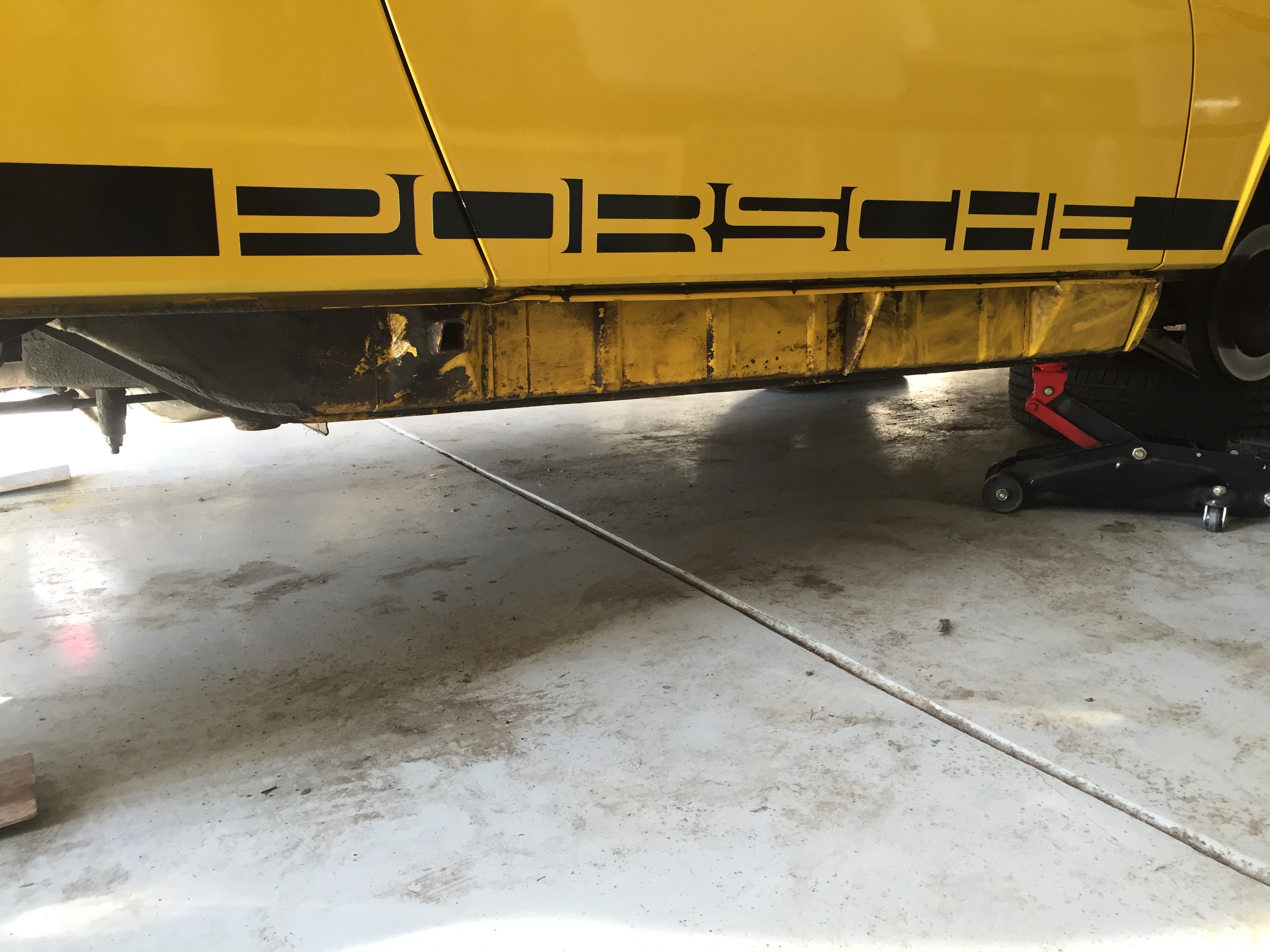

Had my '76 914 for almost 20 years, never removed the rockers. Everyone in here said you'd better do it and clean em out, check longs. Ok, I did and here's the rockers. It has always been a California car, and yes, it passes smog every 2 damn years. I'm going to prime and repaint my rockers, Satin Black the right color? Watcha think of these longs? California 914's rule!

Ok, eat your hearts out Easterners, here's the right long too! California 914's rule!

Madswede   Well I think it looks to be in pretty good shape...   Aug 11 2016, 10:27 PM
Krieger   Looks great! SEM trim black is very durable a...   Aug 11 2016, 10:44 PM
Vapor_locked   The only time they look like that in my part of th...   Aug 11 2016, 10:50 PM

Vapor_locked   SEM is a brand, you can get it virtually anywher...   Aug 11 2016, 11:34 PM
iwanta914-6   It's the other side that is typically the prob...   Aug 11 2016, 11:18 PM

RobW   With rockers like that, you're just bragging a...   Aug 12 2016, 12:08 AM
Cairo94507   Looks very good. Clean and wax, respray rocker se...   Aug 12 2016, 06:54 AM
Tom_T   Yes Curtis, they're supposed to be a dull blac...   Aug 12 2016, 09:08 AM
theleschyouknow   IIRC, someone one here has a source for the bla...   Aug 12 2016, 09:49 AM
