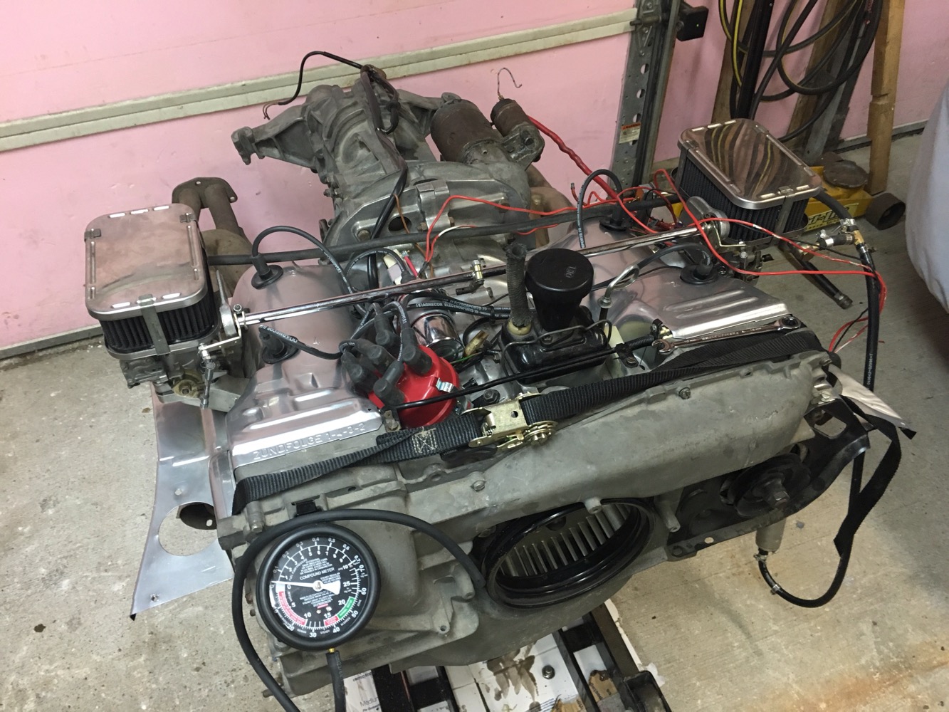

This engine is for my Michigan Build, 2016 Build-Off Challenge. Needed to come to the "Garage" for some help.
Fresh rebuilt on start up, my first oil filter inflated, then leaked at the seal. Second try, filter massive leak blew the seal out. I have a flow probem. Looking for help. I must be building pressure, just won't leave the filter.

Everything buttoned up and ran for 30 minutes at around 2000 rpm. All good. No leaks, and sounding strong. Doing an oil change, and carb adjust I'll be ready to install in the "build " car. Here the link to Michigan Build / Build-Off Challenge 2015/16
QUOTE(stugray @ Aug 7 2016, 10:06 PM) *
What does the oil pressure read at the pressure sender port?
