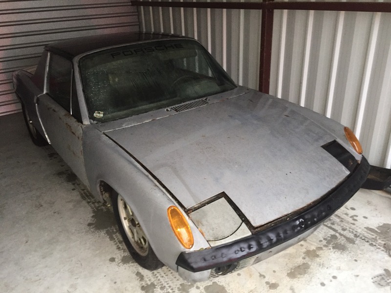

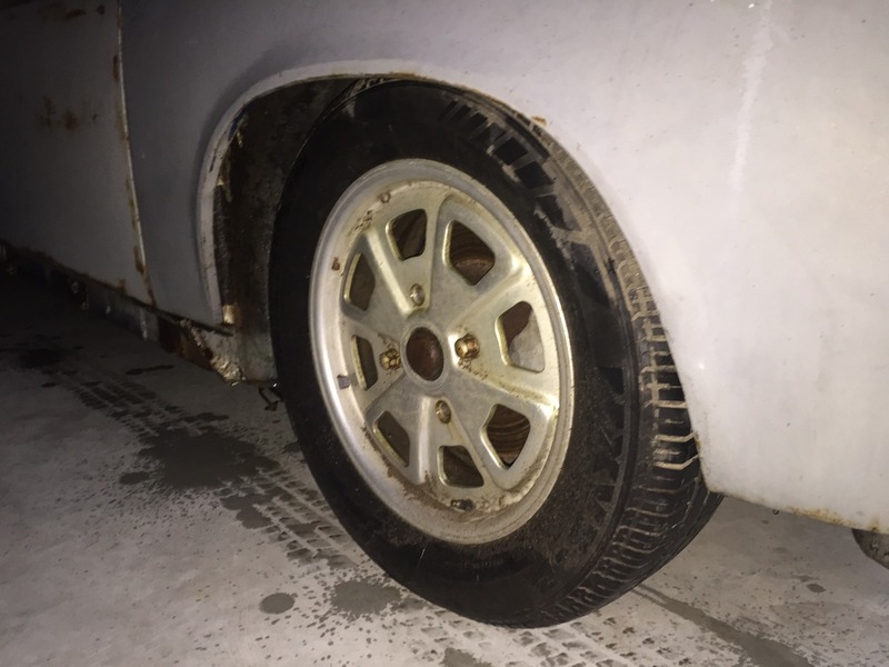

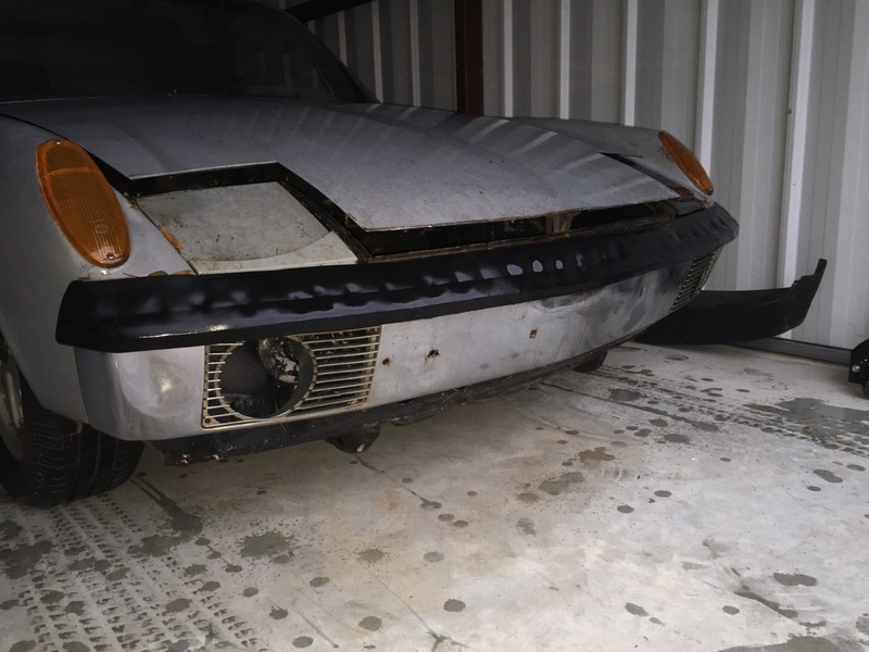

Picked up the parts car this afternoon. It's a '72 roller with no motor, no transmission. The engine compartment and hell hole are very clean, but the floors have some holes.
I'll be stealing the fuchs, bumpers, and targa top along with some other small pieces. Then I'll probably post what's left for a few hundred. If it doesn't sell, I'll take anything of value off and scrap the rest.
