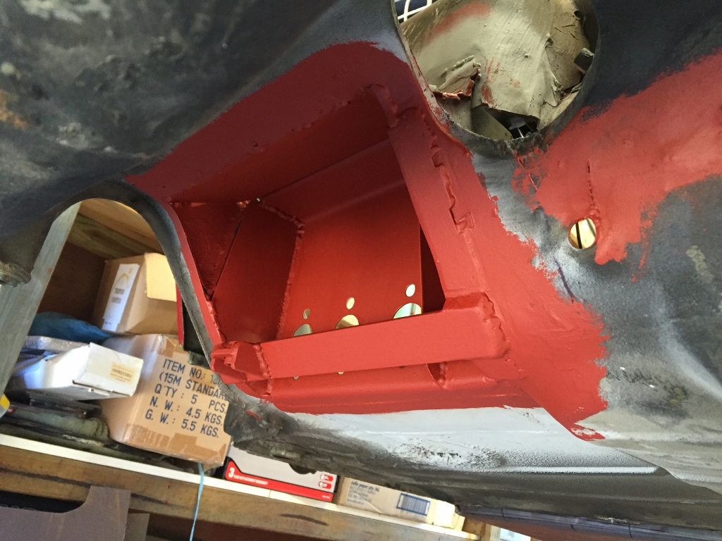

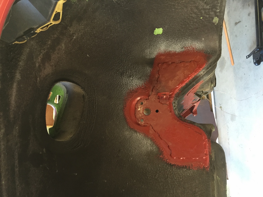

wow - time really does fly - looking at some of the pics above and where i'm at now it doesn't feel like I've achieved as much as I should - but I've been working a lot on the detail bits.

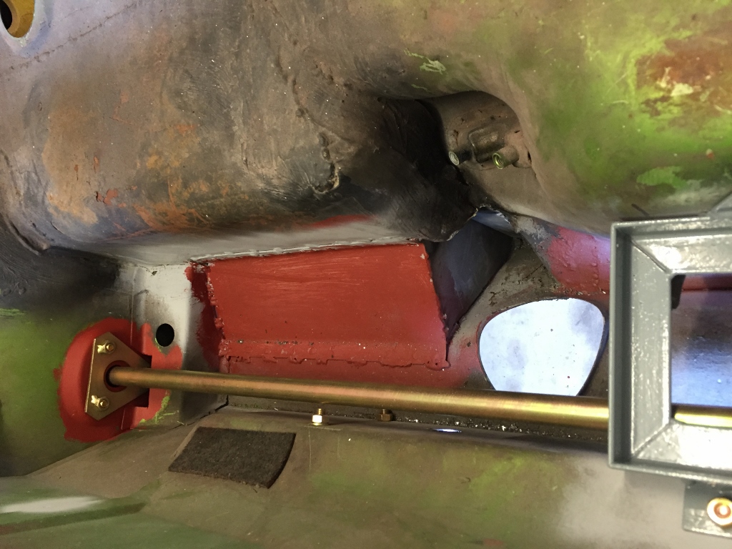

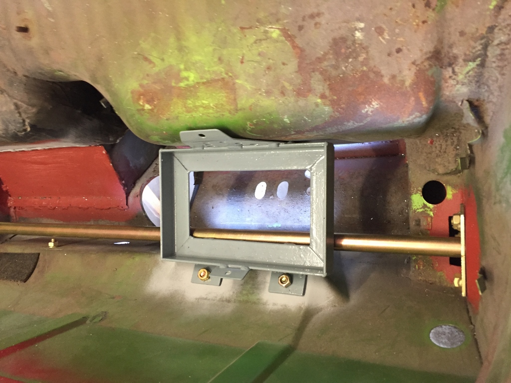

I was scratching my head over the way to bolt in the rearward facing stay from the front suspension cross bar given I cut out the pedal box area - I saw a few options but settled on welding in some re-enforcement and welding in a cross bar with out of 5mm bar & welded in a new mounting tab - fits perfectly and clears the 3 master cylinders that poke through the pedal box. the MC's also clear the steering rack when its installed.
the top of the pedal box (the angled part) also now has holes cut in it for the brake fluid bottle.
I did the relevant cuts and installed a front sway bar, also using the maddog reinforcement plates in the wheel arches.

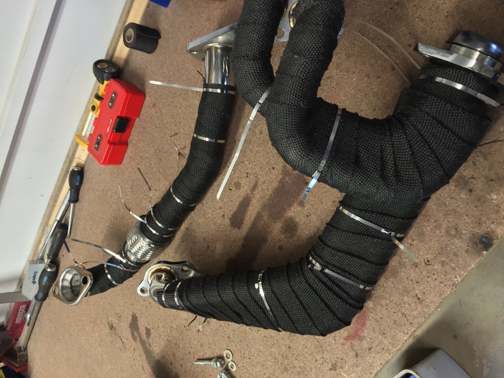

I picked up a stainless manifold that was on sale - $180AUD ! wrapped it in tape - doent need to last a long time as i'll get it ceramic coated in the future at some point ...
