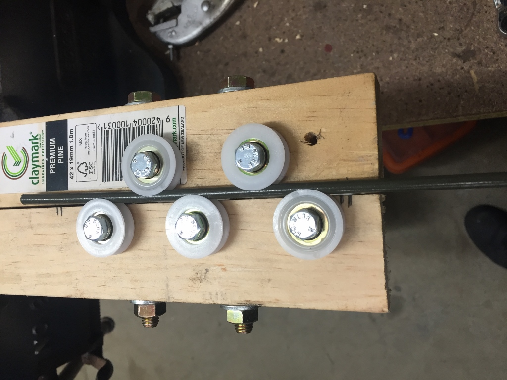

I needed to straighten the brake lines as it came to me in a big roll, and didn't want to pay $$ for a straightener - bought some wardrobe door rollers for a few $ and bolted them to some scrap pine - then 2 bolts through to adjust tension - it works perfectly !

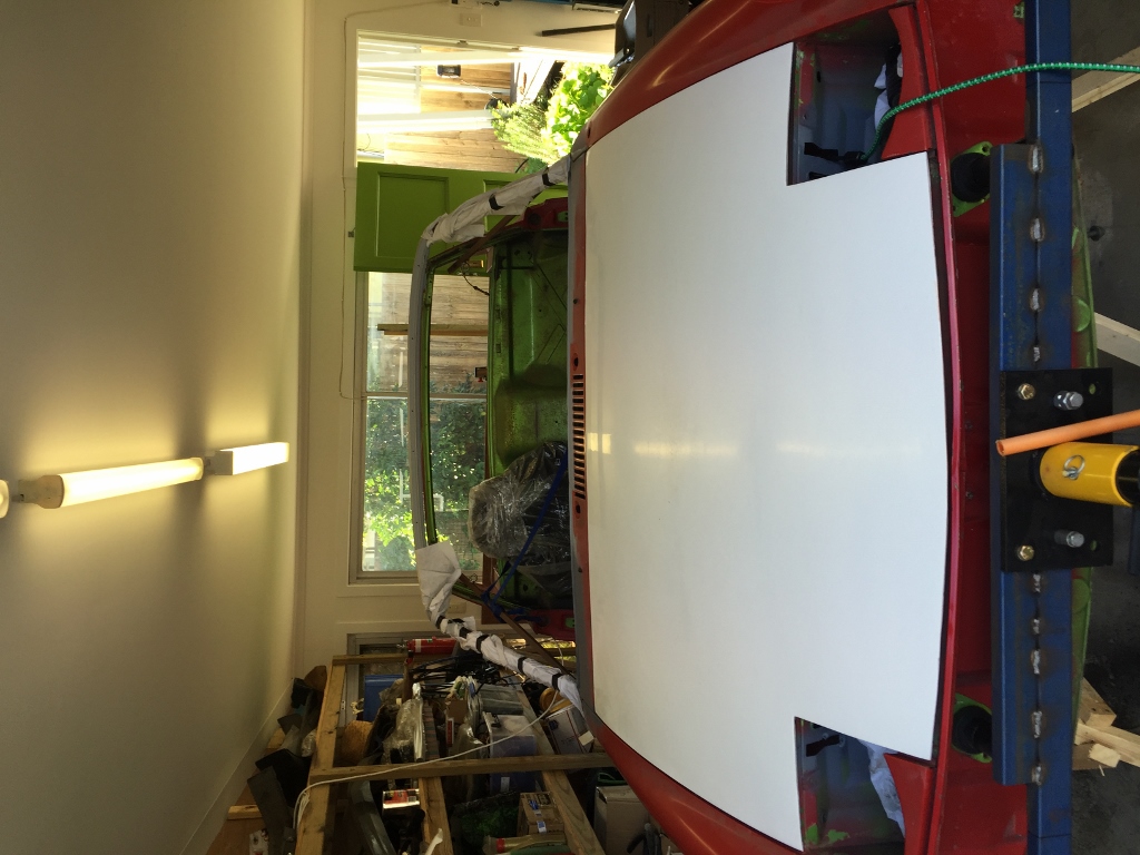

dropped on the fiberglass hood as I needed to check clearance for the radiator - no problems here - first time a hood has been on it for a year or so - makes the car seem wider somehow ...
