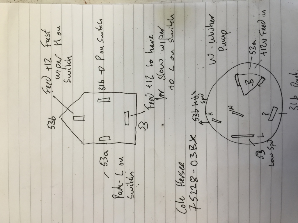

have started to get busy with wiring - this was a MAJOR time consumer on my last car build (lotus 7 clone) so want to do this car wiring in parts ...
I started on the wiper motor - my 914 didn't come with a wiper stalk, I also wanted to declutter around the wheel as much as possible so I bought a cole hersey wiper switch - then had to figure out how to hook it all up ... this is done now and the below is how it works ...
