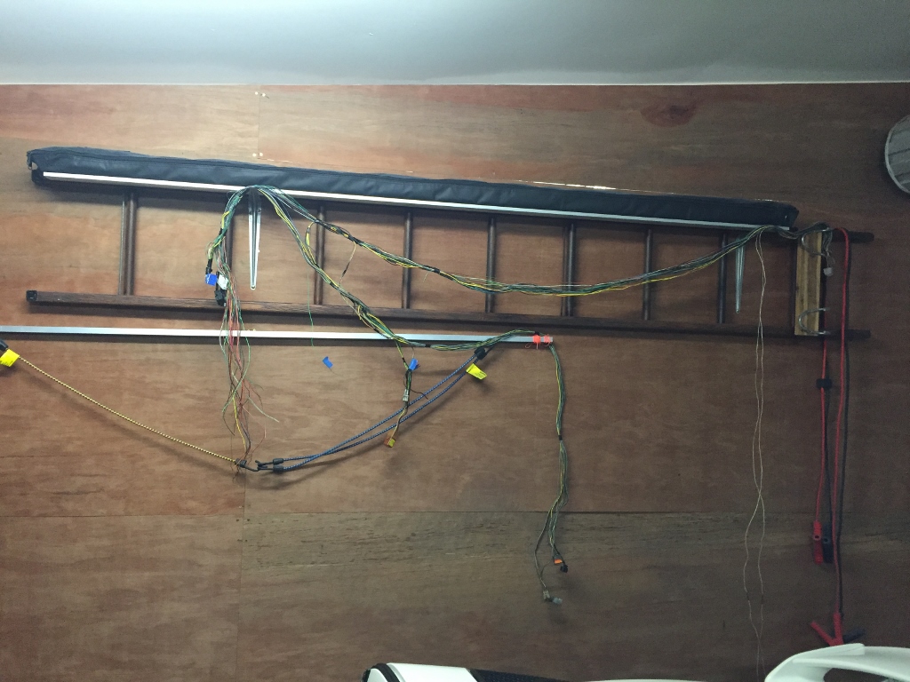

also pulled apart the WRX wiring loom - I have it strung up in the garage and all wires marked where they hook up to and what ISNT needed. I also pulled the engine part of the loom off and cleaned / re-wrapped it with cloth tape. one of the nice things with the Subaru loom is the plugs at the engine - makes it very easy to remove the engine as the harness has 3 or 4 plugs that sit at the side of the engine that snake off into the various engine sensors & injectors etc.

barrym   also pulled apart the WRX wiring loom - I have it ...   Aug 24 2016, 02:05 AM
