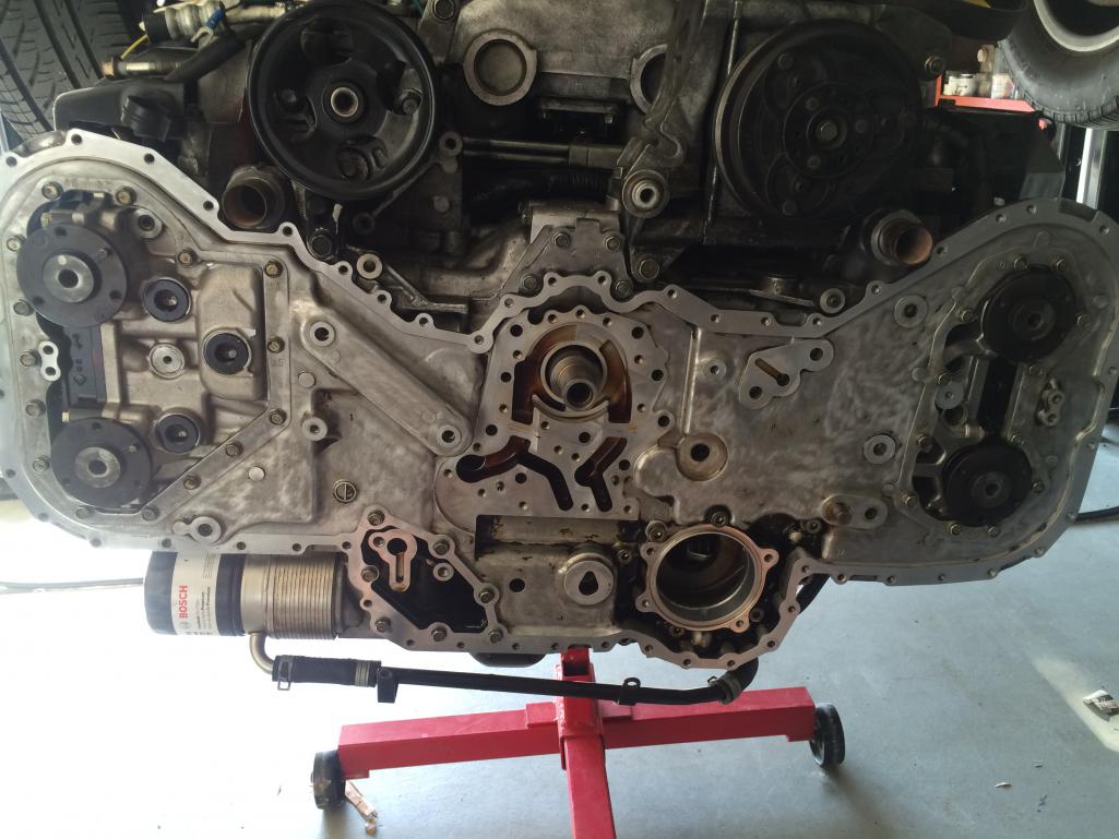

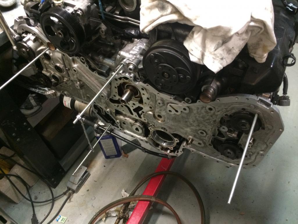

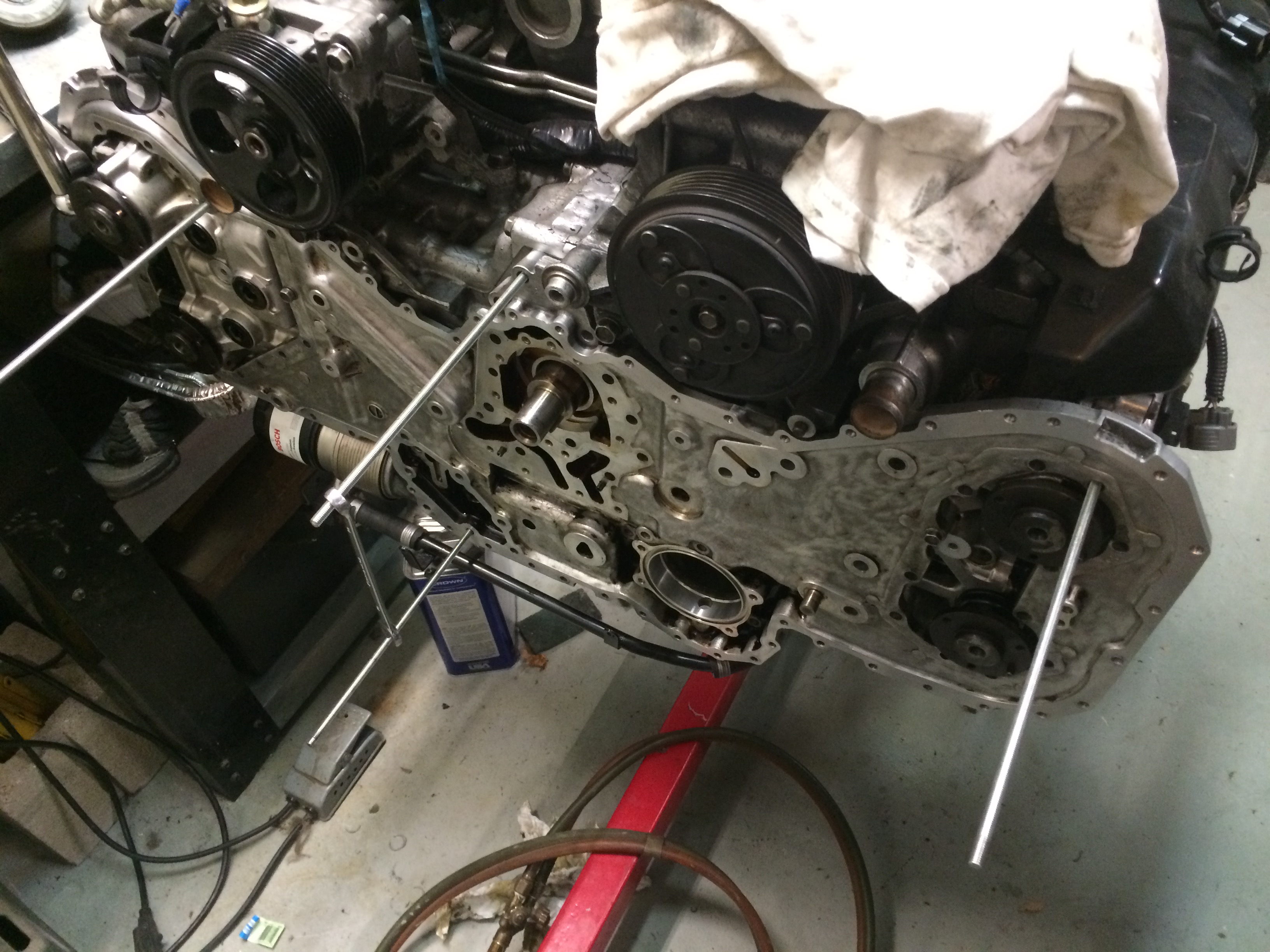

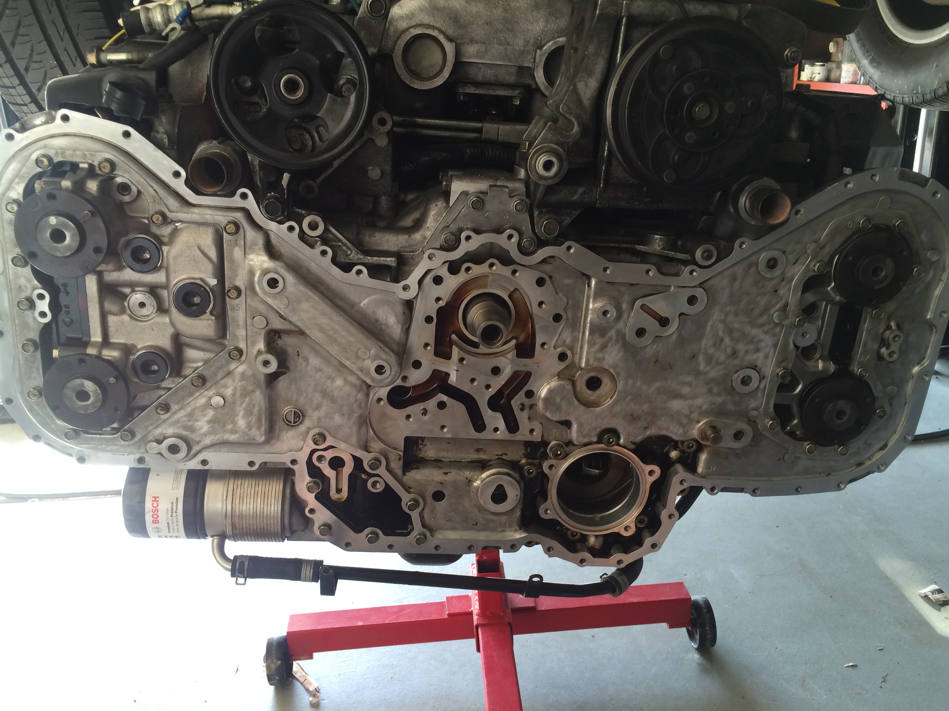

I began to reassemble (again (IMG:style_emoticons/default/mad.gif) ) the timing chain enclosure on the original 3.0. There is the front and rear halves. Last time it leaked badly at the rear cover and I suspect that I might have rubbed some of the sealant off before making contact. So this time I decided to give myself a fighting chance. Bought a meter of 6mm x 1.0 threaded rod and cut into 4 pieces to make a jig. The back half slid into place evenly and the rods were removes as they were replaced by bolts
Back half bolted in placed and torqued. Just need to install cam gears, chain, tensioners/guides, oil pump and water pump. After that the rods will go back on the outer row of bolt holes to be used as a jig for the front cover. If it leaks this time I'll throw it in the trash.
