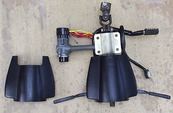

> 914-6 dash ignition switch mount area reproduction, it was discussed previously - did it go anywhere?
Brian_Boss
post Aug 29 2012, 07:49 PM
Posts: 324
Joined: 3-June 03
From: Dallas, TX
Member No.: 781
Here's the thread where it was discussed:
http://www.914world.com/bbs2/index.php?s=&...t&p=1224720
If no one is actively working on it, I would take it on if someone could send me a cast or impression of a factory 6 dash.
Or am I the only one who thought that it was a cool idea...

Thanks for the inputs; I've been pondering how to do this for about a year.
I have the ignition lock and it's keyed to my doors.

I've read and reread that excellent thread; I'm shooting to just install the ignition switch at this time. I did get a line on the parts earlier
If someone has a complete set of required parts they want to find a new home for, I'm interested....

mharmon   The 914/6 ignition switch and housing have been su...   Aug 30 2012, 09:05 AM
SirAndy   The 914/6 ignition switch and housing have been su...   Aug 30 2012, 02:48 PM
Brian_Boss   Just to clarify, I'm talking about the recesse...   Aug 30 2012, 06:15 PM
SirAndy   Just to clarify, I'm talking about the recesse...   Aug 31 2012, 02:39 PM

sixnotfour   This uses the stock 914 igntion switch and wiring,...   Aug 30 2012, 07:00 PM

John   It's a lot of work, but I made my own recessed...   Aug 30 2012, 10:00 PM

Harpo   I will be making a cast this weekend of the 914-6 ...   Apr 8 2013, 06:50 AM
McMark   Make sure to use a good amount of mold release wax...   Apr 8 2013, 10:02 AM
Harpo   I probably don't have access to mold release w...   Apr 8 2013, 11:00 AM
mr914   David Plain old Johnson paste wax works fine for ...   Apr 8 2013, 04:22 PM

CptTripps   :bump: I've been looking at ways to do this, ...   Jan 9 2014, 10:04 AM
mepstein   rick 918-S has an orig 6. This would probably be c...   Jan 9 2014, 10:47 AM
1stworks   I have been using this switch park and it works gr...   Jan 9 2014, 11:03 AM
ClayPerrine   Mine was done using an original six dash. The one...   Jan 9 2014, 11:03 AM
rick 918-S   I have an impression pattern on the work bench but...   Jan 9 2014, 11:33 AM
mr914   I still have the bondo splash I did for Harpo   Jan 9 2014, 05:45 PM

Mikey914   Need the plastic bezel? I could do some of those, ...   Mar 6 2014, 05:38 PM
mharmon   I'd be in for a couple bezels. The ones from ...   Mar 6 2014, 06:55 PM
jaxdream   I'd be in for a couple bezels. The ones from...   Mar 7 2014, 09:45 AM
McMark   I have a casting of the relief, but was thinking 3...   Mar 6 2014, 11:04 PM
Mikey914   I have a casting of the relief, but was thinking ...   Mar 7 2014, 03:18 AM
McMark   I have a casting of the relief, but was thinking...   Mar 7 2014, 07:23 PM

CptTripps   So in addition to this: http://bit.ly/1igHOtv I...   Mar 7 2014, 07:12 AM
jkb944t   So in addition to this: http://bit.ly/1igHOtv I...   Mar 7 2014, 12:11 PM

naro914   I just put a 911 switch and bezel on it. Not stock...   Mar 7 2014, 03:53 PM
jim_hoyland   I just put a 911 switch and bezel on it. Not stoc...   Aug 28 2016, 11:02 AM
mepstein   I just put a 911 switch and bezel on it. Not sto...   Aug 28 2016, 11:23 AM

jim_hoyland   Update: Restoration Design sells the dash plate, s...   Aug 27 2016, 05:02 PM
SirAndy   Update: Restoration Design sells the dash plate, ...   Aug 27 2016, 05:07 PM
Mark Henry   Update: Restoration Design sells the dash plate, ...   Aug 28 2016, 06:59 PM
McMark   Hey that looks just like the sample mold that I to...   Aug 28 2016, 07:07 AM
jim_hoyland   Hey that looks just like the sample mold that I t...   Aug 28 2016, 07:35 AM
Harpo   I don't believe there is any cutting, just wel...   Aug 28 2016, 12:06 PM
McMark   Don't plan on welding the whole RD piece into ...   Aug 28 2016, 01:37 PM
