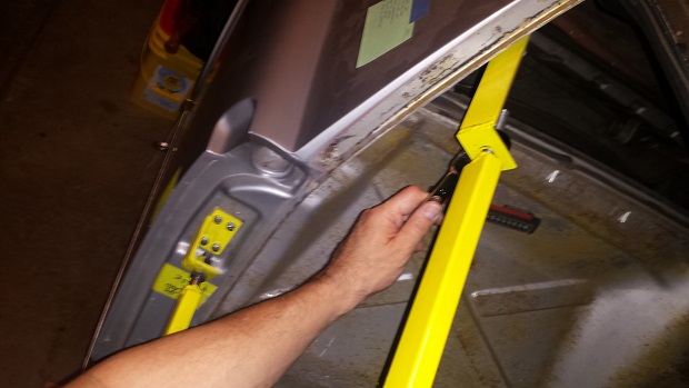

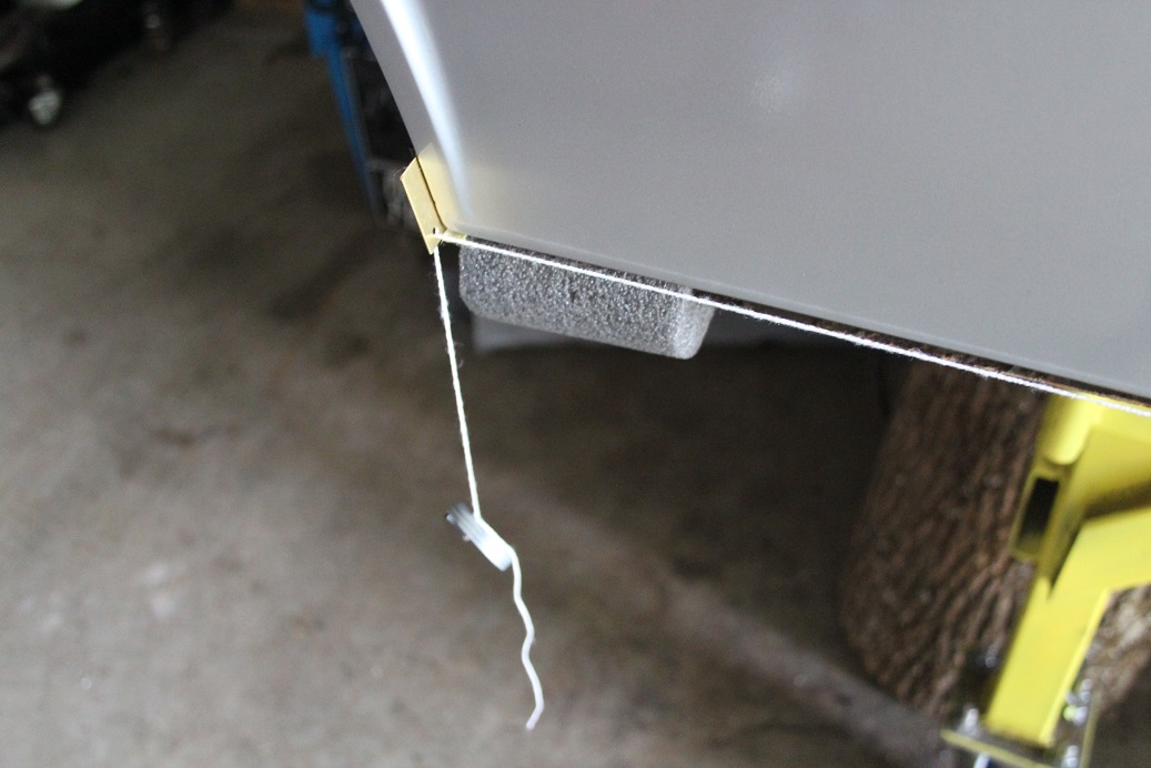

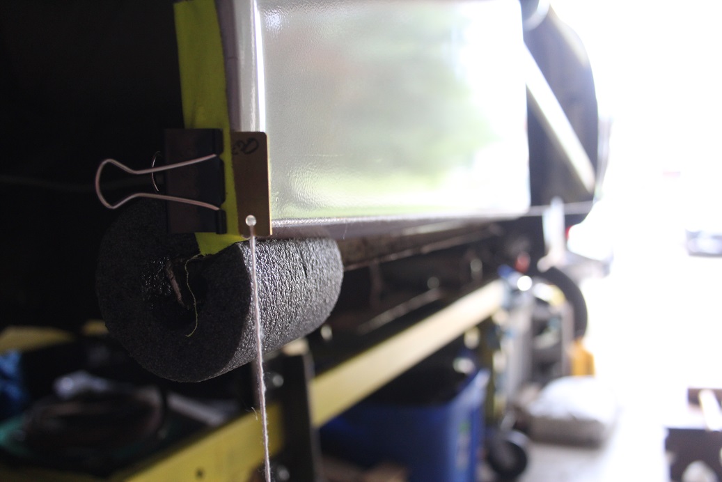

Now the car is mounted on 4 points again and I can adjust to get those points level. But the two halves are tilted away from each other. I can adjust the door braces to fix that, but I need to know how much.

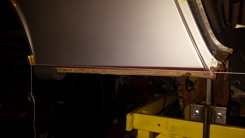

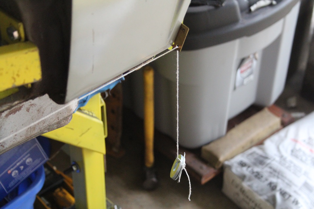

I made a couple little metal tabs with a hole, and clamped them to the corners of the wheel wells, front and back.

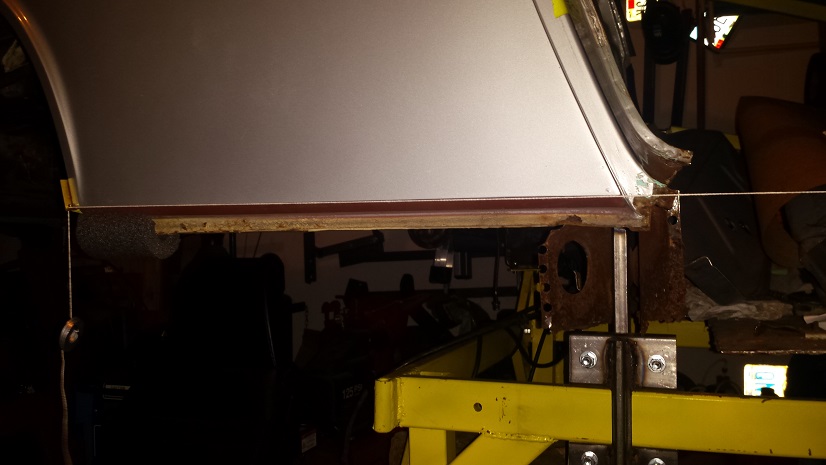

Now I can see if the bottom edges of the quarter panels line up or not...
Then I can crank on the door braces to tilt the halves until they line up...
Looks better:
Now I'm sure someone is thinking, what about door gaps? I haven't forgotten...
The door braces have to be adjusted in tandem to get the gaps right and also the alignment. That said, getting this right is probably the thing I am most worried about.
