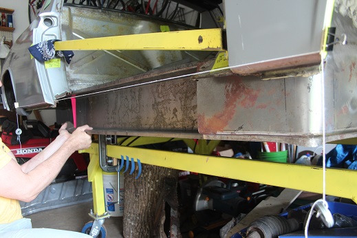

So here's the car as I got it, not quite a year ago:
Started out doing a little engine work to get it running, then drove it around a little bit before starting to take it apart. Took the engine out, put it up on a dolly, took out much of the interior and suspension, and this is how it sits now:
After cleaning out the inside and seeing the rust, it was hard to believe we were driving it at all. These are the first cuts, just straightening out the edges of the rust holes really.

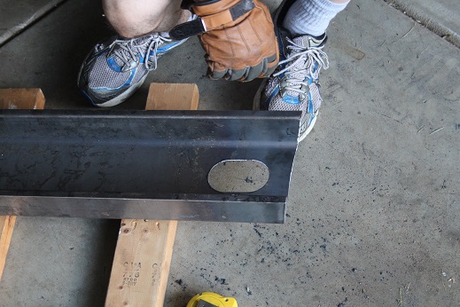

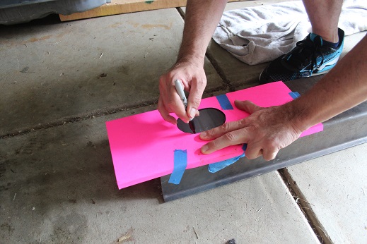

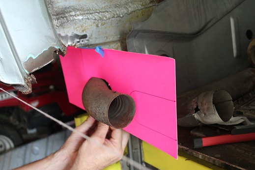

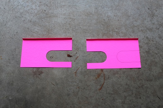

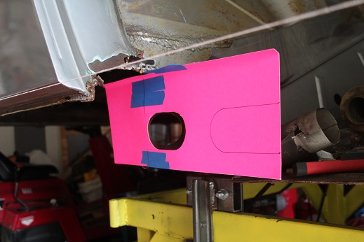

Continuing work on fabricating the inner long. Need to cut the aft hole for the heater tube. Made some templates..
Put the heater tube in position and slid the templates together and taped them.
Removed the heater tube, leaving the templates in place...
...put the long in place and taped the templates to the long.
Trace out the hole and cut.
Et voila.
